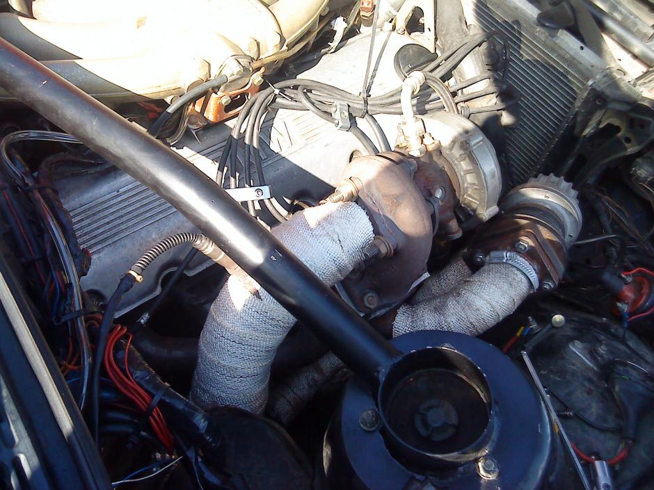

          at lunch break i took old turbo out of the car and start to take intake manifold too,but i didin´t have time to fight with that one ***king bolt,so i take it tomorrow off.
          i sold old turbo today,and if everythings go right this time,i get new turbo this week.:bow:
          and weekend i have to install turbo and weld exhaust outlet flange to downpipe and paint the car,etc..

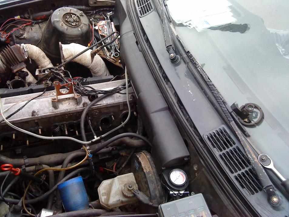

                today i take intake manifold off and tomorrow i take it to blasting and i also take cylinder head cover to blast too.

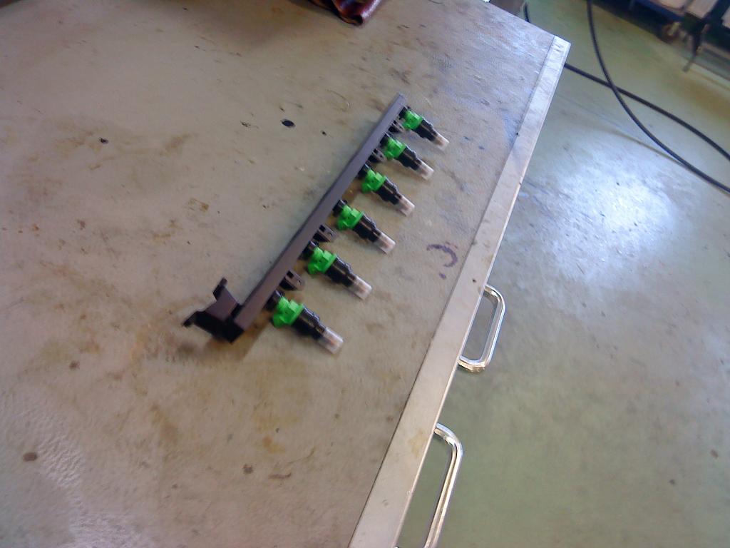

                i bought new fuel rail and install new injectors to it.
                i put one photo of this fuel rail.
                i had to take transverse bar off also that i got these S14 engine wiring harnesses at their own places.
                tomorrow i put blasted cylinder head cover and manifold on their places and then i can put transverse bar in too.
                engine bay is much prettyer now that what it used to be.

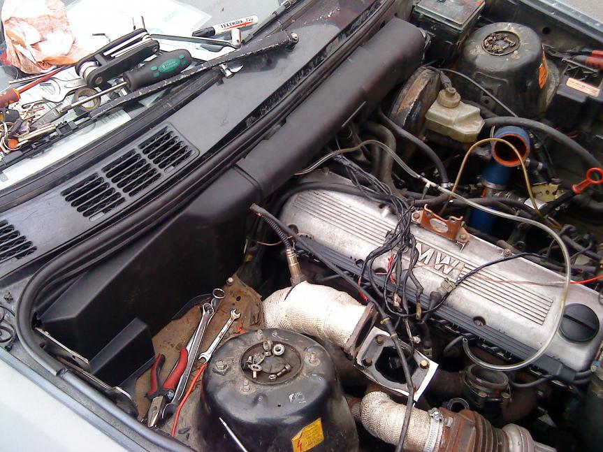

                here´s one picture at this point engine bay.
                there is still lots and lots of work to make it smooth and clean.
                i also put one picture where you can see what kind of cable mess it was used to be at battery place.
                battery place is bit "skin rust" so i have to clean it up really good and put acid-paint and then primer and then just basic black paint. and brake servo unit needs paint and cleaning too.
                but i think it´s gonna pretty smooth at the end.
                tomorrow at lunch break i think im gonna paint battery place and brake servo unit too. then i have to put wide-band lambdas cable also behind those harnesses. so after that only cables witch are showing anymore are just injection cables,water temp. cable to megasquirt and water temp gauges cable.
                notice last pictures "diagnostic-plug" clever use.:giggle:

                            well it is so.:-D everything get used to.;)
                            as a matter of a fact i´m not right now building engine,because it´s been "build" 7 months ago. pistons are turn in a lathe and take off 1.3mm of the head,and whole block has new bearings and all new pistons rings is new.
                            so now i put that new holset on,and well see how much we can get out of allmost "stock" b20 engine,with big turbo and big injectors and adjustable engine management.
                            in winter im gonna build up perhaps this motor. or b25,or even b34.;)
                            well see what its gonna be.
                            New engine size is depending on how much we can get out this b20 with these modification´s
                            if 350hp is in the "limit" at break,i think i just build up bigger engine.
                            everything depends on everything for now.

                                hednam has bought maza´s old project body and now he´s searching a b34 engine for it. and matti got´s S38 motor,and also that b25 in ix,so i have thougt how about if i stay this b20 engine,and not to be like everybody else.
                                well,it´s kind of a open still about that motor thing for winter.
                                i havent have done anything for the car at weekend. been so busy doing other things,and helping my friends,and so on. next week im on a vacation and hopefully i gat those valve cover and manifold to blasting. and then i can put those parts on theirs own places.
                                battery"place" is now rust free,and i put acid-paint and then primer for it and let it dry for weekend and tomorrow when i wake up i go to my work and paint it black. i cleaned brake servo unit up and painted it satin-black,it´s not like new part,because it´s got to be removed if i like to do it "like-new". well,in winter this is gonna happen too.;)
