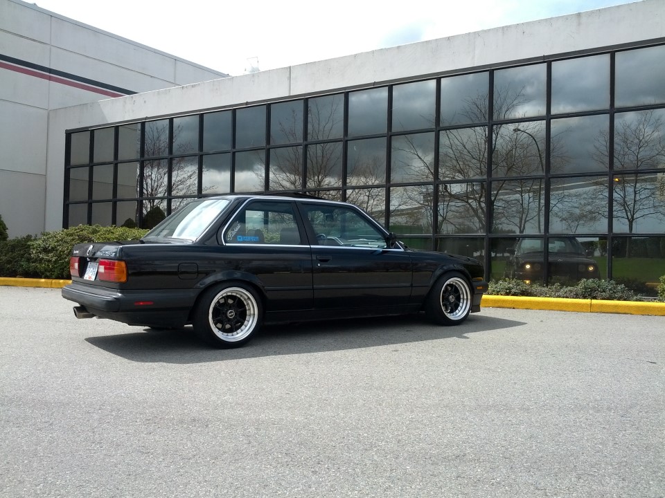

                        xxr 002 205 45 16 et0

                          FYI, I've been tracking 10mm non-hubcentric spacers on my front wheels for over two years now with zero vibrations at speeds well above 80mph. They are for locating the wheel, period, which is why some are just plastic as was already mentioned.
                          to stay on topic, 16x8.25 et0 XXR 527, 215/40/16 front, 245/35/16 rear.

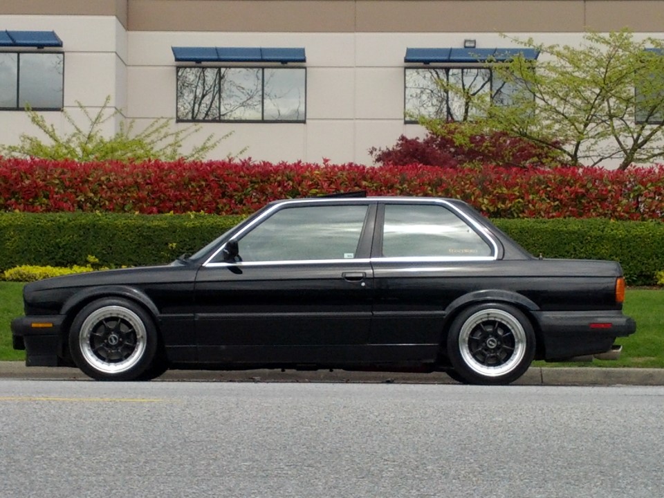

                              e38 style 5's , 205/45 r16
