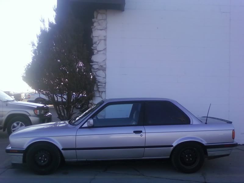

          And, I'm back. Yay.
          So, where was I? Lets see... After getting all of the old subframe bushing remnants out of the car, it was time to start putting it back together. List of new bits in the rear includes: bearings, TA bushings, subframe bushings, medium case s3.73, dif mount bushing, calipers, pads, and rotors.
          Eventually, it looked like this:
          Ahhhh, shinny new bits.
          Then it looked like this:
          Suspension hadn't settled yet.
          Here you can see the lip added, and the fog light put back in.
          Annnd, a quick shot of the new exhaust:
          Will have more soon. Just happy to be able to drive it. Now to get the toe set, and the stereo finished!
