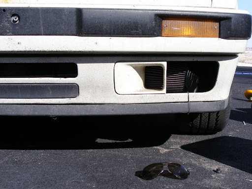

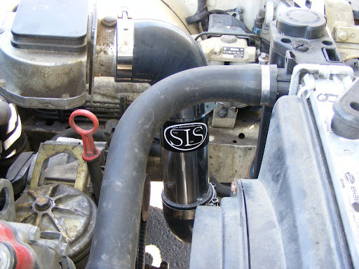

    So i read in a GRM article that a cone filter in the engine bay without a heat shield actually robs 5 whp, so i bought some silicone intake tubes and clamps (at www.siliconeintakes.com, totally awesome high quality stuff) and re-routed my intake to make it lower.

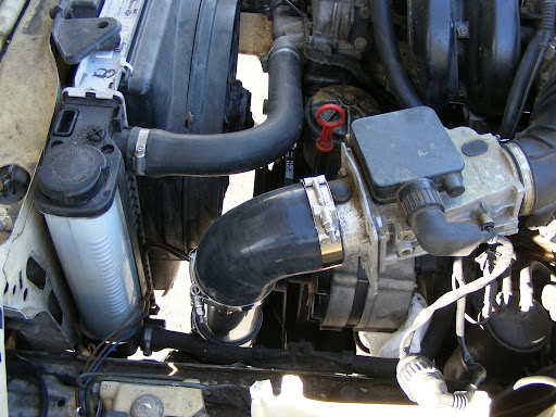

    First I had two 90 degree bends routing the cone filter right behind the fog light thusly:
    At that location the filter can get the best air it can possibly get, but according to the Butt Dyno there was no noticeable power difference, just increased noise, which actually made the car feel slower.

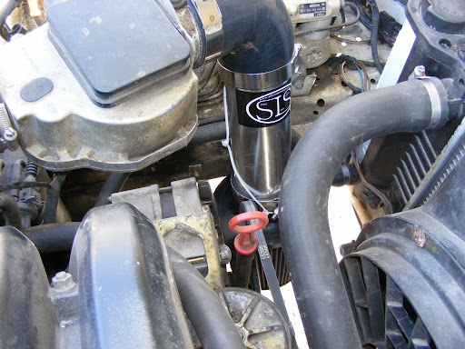

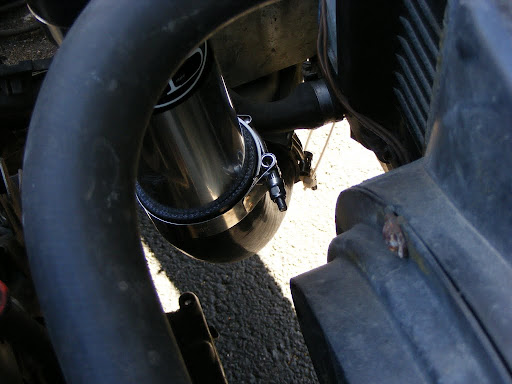

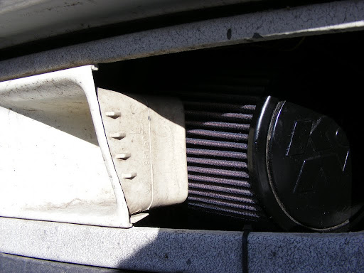

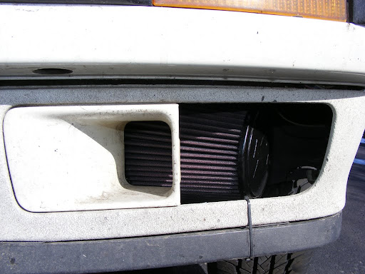

    So I figured all the added hose adds a ton of air drag, and I was worried about rocks punching holes in the filter, so I removed the lower portion, a 90 bend and a length of aluminum pipe, and simply put the filter on the end of the aluminum pipe that was going straight down.
    The filter is temporarily being secured from being shredded by the alternator with zip-ties, but later on I will find a less ghetto solution.
    once again, no noticeable Butt Dyno difference, but at least now the filter won't be eating rocks or drinking water. (as much, anyway...)

    You know it's still open to hot engine bay air, right? And that piece of aluminum pipe isn't helping, either.
      Matt
      the lower air dam thing is removed so it has pretty good access to cool air down below, rather than up near the top, where all the heat congregates.

                      /\ Fo reals. Stock intakes are cheap if you want to go that route. Making a heat shield would be the most cost effective thing. Get some cardboard and design the templates, then cut whatever material you want to use for the final product. It's also always better to route air to the filter than route the filter to the air.

                          i've also been thinking of making a heatshield....does not seem complicated...i though of using fiberglass does anyone know if its a good idea? cause i have access to free fiberglass

                            Fiberglass would be one of the best materials. I'd also look into making a fiberglass tube to replace the metal tube. Anything to resist heatsoak will be beneficial, though I seriously doubt you'll get any worthwhile hp out of this.
