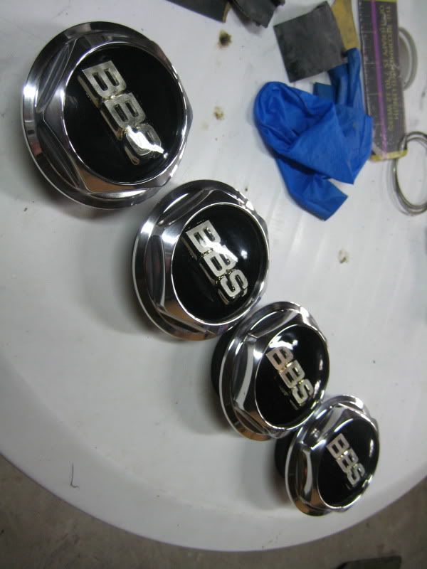

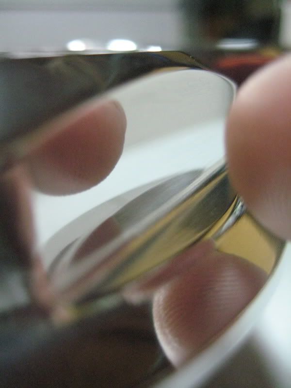

    So I've had some stuff up my sleeve. Here's a teaser pic of what I just finished today that took the whole day to get to what it looks like right now...
    More to come...

    nice, did you sand entirely by hand and what grit did you start at?
    • jahnaboi
      • Oct 2006
      • 1742
      Started with 220, 320, 400, 800, 1000, 1500. Thought I had 2000 somewhere so I just stopped at 1500.

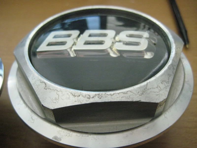

                  I bet... here's a before picture after using aircraft paint stripper.
                  It look much worse in person than it did on camera.

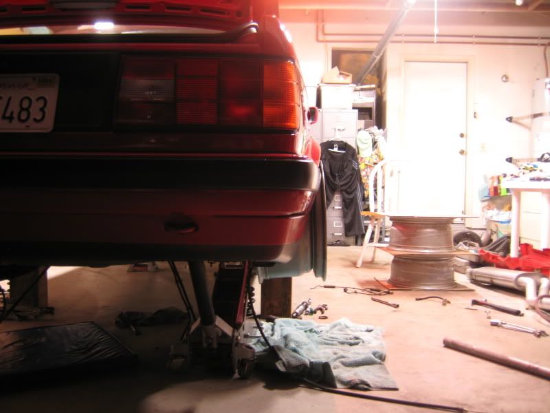

                    Getting there...
                    Test fitting the 17x9 5x120 rear rim... looks flush to me. Still a teaser. =)
