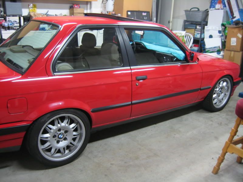

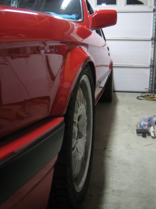

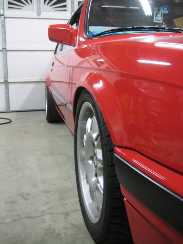

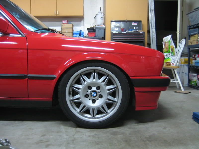

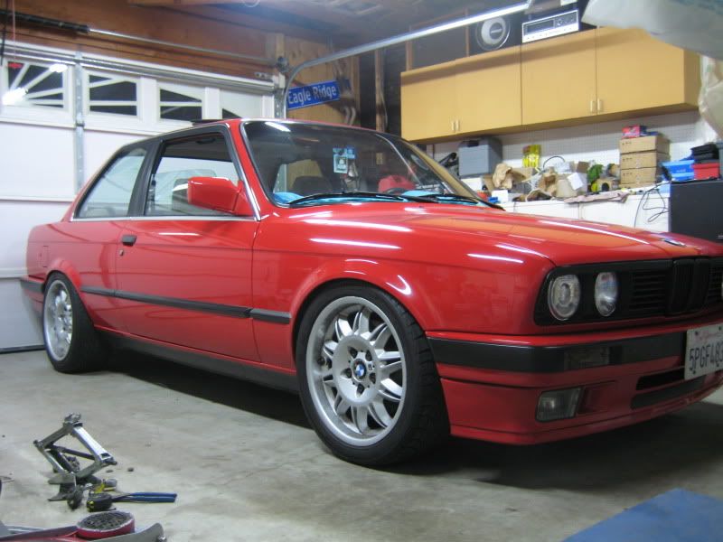

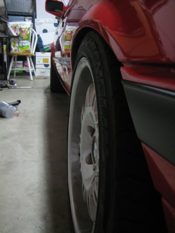

                      Uploading some pictures right now.
                      Still have to re-bleed the brakes as there's still air in the system. Question: When you guys run dsIIs or any 17" rim does your tires rub the inside fender linings? If so, do you guys remove it completely?
                      The dsII's that I'm running right now have 245/40/17s in the rear and 235/40/17s in the front.
                      A lot of people never believed that my car was pretty low. These pictures will show different. I'm kind of sad at how low it sits. Seems like my car didn't raise much at all in the front...

                      • 619E30
                        • 1753
                        ^ Looks great. Even better than on an e36 :up:

                        • noE30
                          • Jun 2008
                          • 2260
                          Looks great as is, will be badass with the bbs.

                          • 318isbmw
                            • Nov 2005
                            • 2843
                            +1 the DS2's with fat tires looks great on your car.
                            • jahnaboi
                              • Oct 2006
                              • 1742
                              Thanks guys. Definitely will be better with the BBS's =).
                              Forgot to mention, I also installed the matching m3 steering rack (3.2 L2L) while I was in there. My car is an e36 m3 but with a e30 shell. =P

                              • Kilawin
                                • Dec 2005
                                • 994
                                That looks great! What setup did you use for the front?
