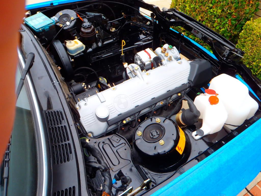

            I could enjoy some more bay close ups. Everything so clean and OCD really satisfies me. I love how all the BMW specific hose clamps are aligned on the same axis. I'm thinking that as many fasteners as possible are all torqued to the same horizontal axis as well.
            That is my favorite part of seeing images of mechanical insanity, when the guy that put it together cared about making it so much more than perfect.
            Way to go, and I only wish you'd have developed a tougher skin earlier, because like I told you before, car guys are gonna be asses, it's a type of brotherhood and camaraderie, and if you would have rolled with it, you'd have been welcomed into the fold a long time ago.
            Just remember, like the little boy on the playground punching the little girl in ponytails in the arm on the swing set, most of the picking on ya was because people liked the direction you were going in.

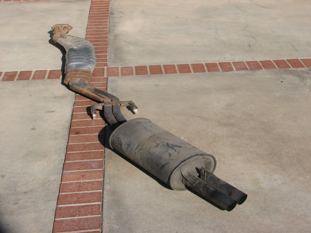

                        you don't have any pictures of your exhaust set up by chance, do you?

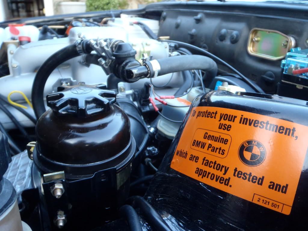

                          Thank you very much for your kind words and for noticing my disorder. OCD can be a good thing sometimes ;)
                          Unfortunately, earlier today I put it away in storage. Here's a picture of the exhaust as well as some detailed pictures I took during assembly. The exhaust setup goes like there, e28 headers to e28 downpipes. At the bottom of the e28 downpipes an M3 flange was welded on to match the m3 center section downpipes. This matching flange satisfied CA BAR. From the M3 center section it mates up to the M3 muffler, of course it was all painted once installed, just don't have any pictures of that yet.
                          Also, not sure if anybody noticed since I forgot to mention it, but I had to relocate the power steering reservoir to where the relays bolt up since the intake boot was conflicting.

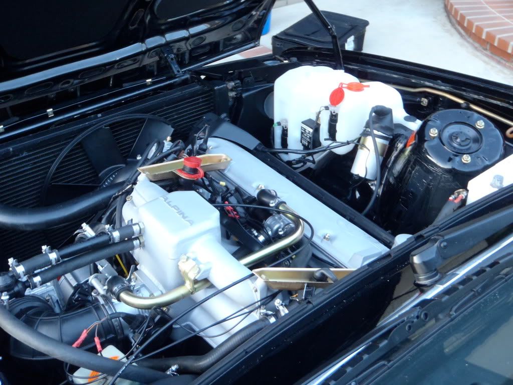

                              Those mounts look, um, thin
                              How sure are you about their strength?

                                Curious about this as well.
                                Have you driven it? How's it feel?
