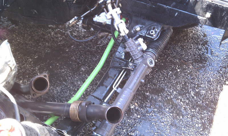

    E46 M3 rack, installing new tie rods in there + steering rack spacers :)
    Carlos' (silence) power steering delete. No more PS in this car! One less thing to leak, one less thing to break!

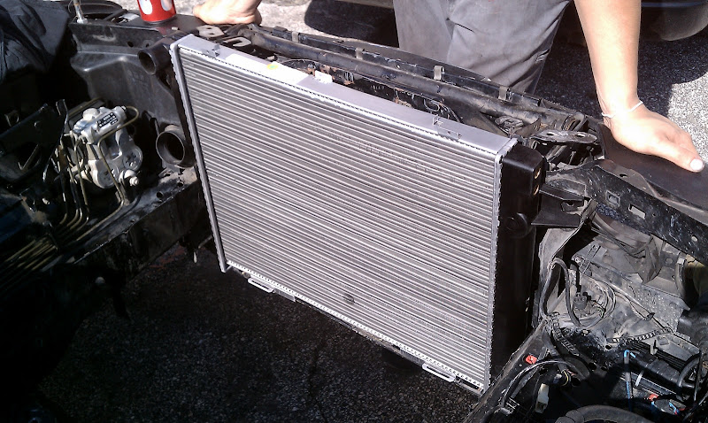

    New e28 radiator... the shop fabricator wants to start chopping up my radiator support to mount the radiator further forward. Not sure if that's going to happen easily.

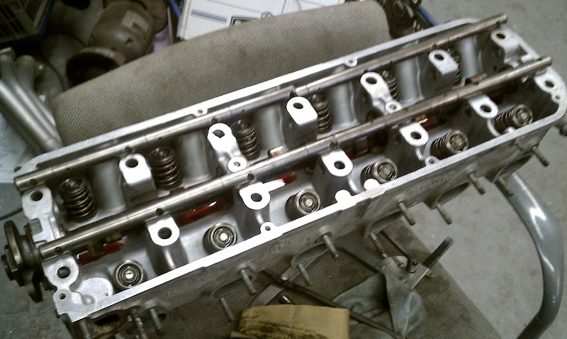

    Back at John's (Forced Firebird) shop, he helps me once again assemble the M30 cylinder head.
    Valves in
    Many hours later
    M5 head gasket installed with ARP head studs. I foresee boost in the future :D

      What does it take to install e46 rack?
      • Erick
        Official R3V Drifter
        • 11169
        The e46 steering rack goes right in. You need to cut off a small plastic tab that sits on the spline to the steering column, but that's about it.

                            Awesome man, it always feels good getting lots accomplished in a short time. I though the shop fabricator was gonna tear apart you radiator support to fit a viscous clutched fan lolz
                            • Erick
                              • 11169
                              If he tears up my rad support, a clutch fan is EXACTLY what i'll do. The radiator is pressed against the distributor as it is.
