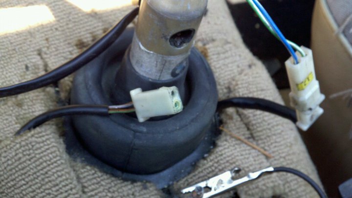

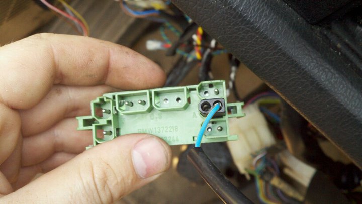

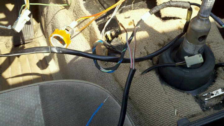

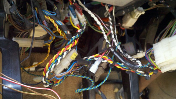

              yea just ran into a rats nest of wires i could use some help if u would like to look at with me tell me whats what

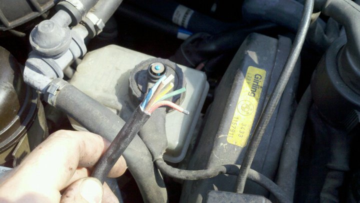

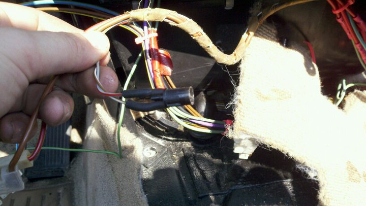

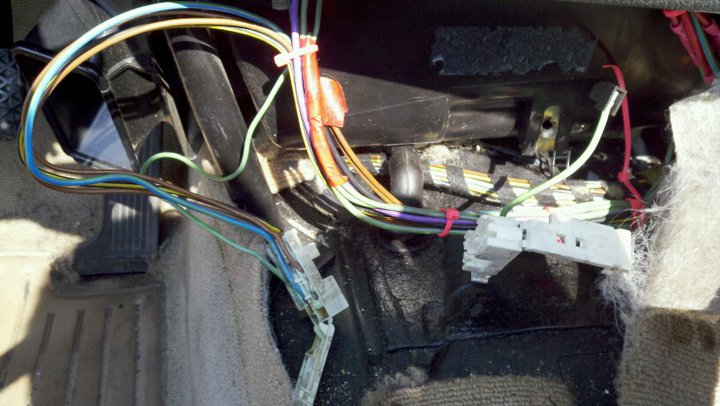

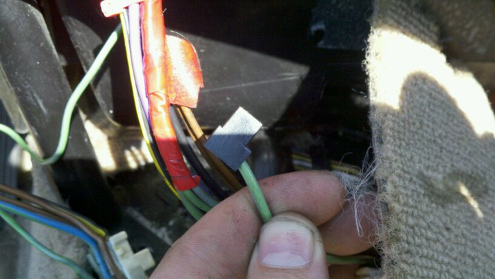

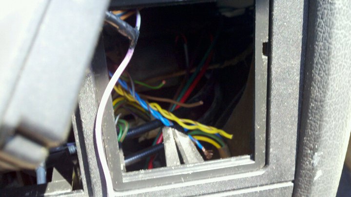

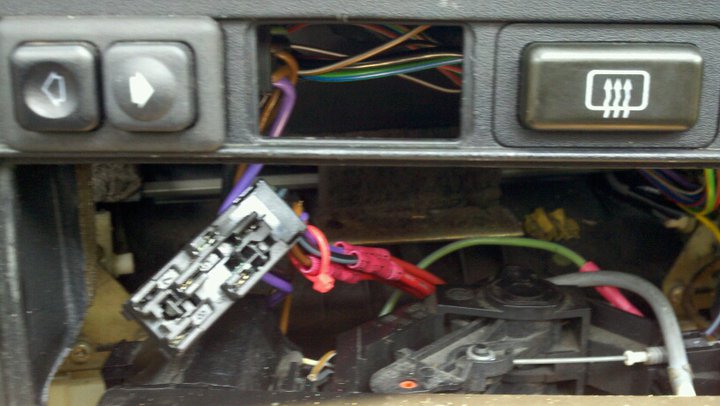

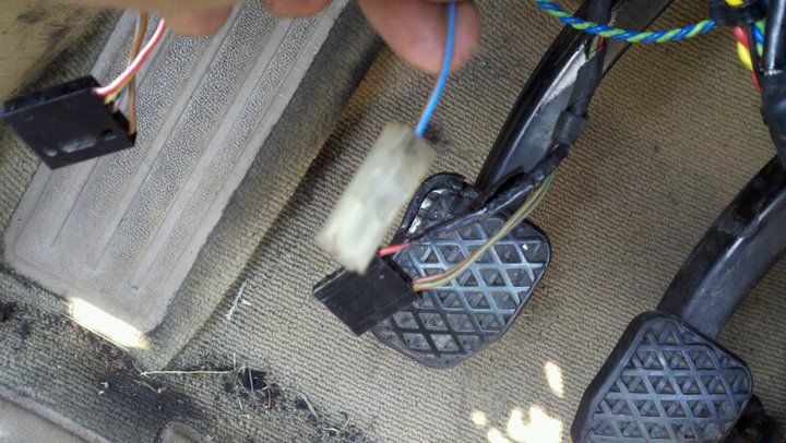

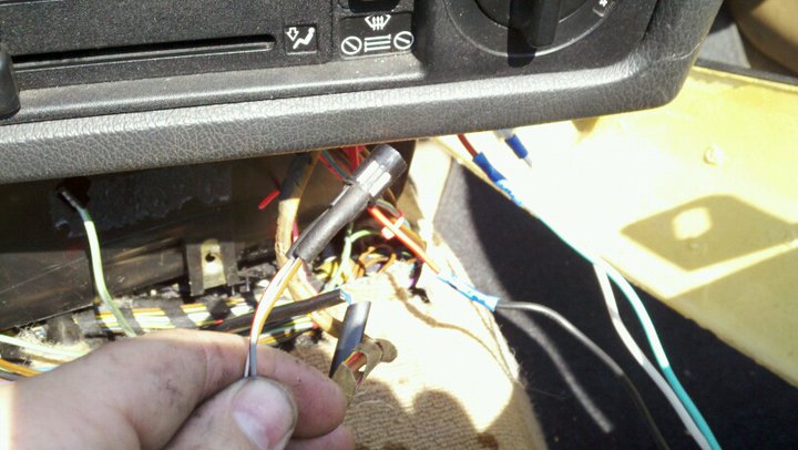

                took some pictures of the previous owners po wire job and there some thing not connected maybe you can help me out here are the pics
                  and heres more
                    and more

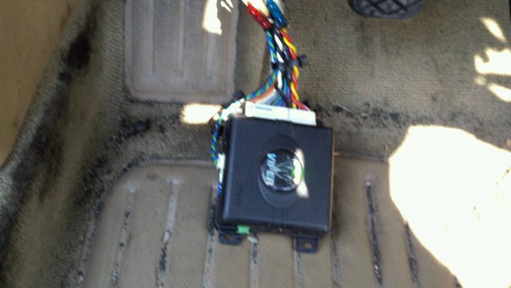

                      that black bow is a viper alarm system that was the main part of the nest. pulled all that shit out but that when i noticed that there are also more plugs and wires not plugged into anything. half of them are for the radio (on the way) but the others i have no idea. like i said im new to this.

                            Looks like the po or you did a number on yanking stuff out of there!
                            That green connector you are holding with the blue wire clipped off goes into the back of the instrument cluster.
                            The two wires coming out near the shifter plug into the other two different colored wires on the right of the shifter with the same long white rectangular plug.
                            Those are your reverse light sensor wires.
                            Looks like the window switch base plugs are near your center console area.
                            All those twisted wires/rats nest under the dash is associated with that viper alarm.
                            Good luck and don't get ahead of yourself with mods.
                            Get it right first.
                              this is how all of it was when i got it all i did was take some pieces out. i figured out the cluster one and trust me ive learned my lesson about mods on other cars im gonna fix everything first.
