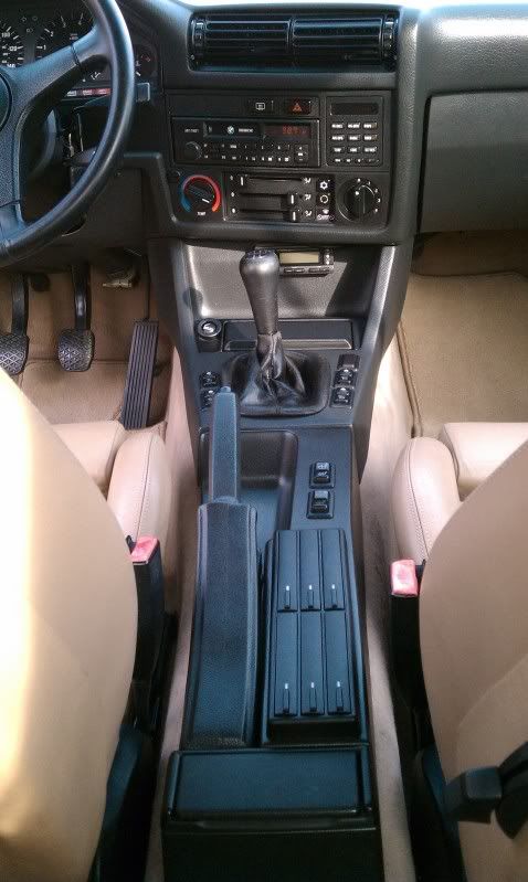

      Today was an hour or so with the car. The black kick panels sold to me are the incorrect fit. These must be from a four door? or maybe even a difference between 2 door and cabs? So I got a set of black kick panels if anyone needs 'em. $25 down the drain.
      I did score the cassette rear console. Everything works and is in great condition. Vinyl is peeling up a little but that is from the bottom and not noticeable as it sits. I had to cut for the heated seat switches.

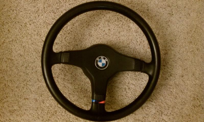

                              Great luck at Crazy Ray's recently. Restored this MTech1 steering wheel:
                              Before:
                              After:
                              I cleaned it with Poorboy's APC. Scrubbed it. Wiped with isopropyl alcohol. Set in the sun after dying it with Kiwi new shoe shine in a bottle with foam applicator. New MTech badge from eBay. Buffed with Poorboys Natural Look. Mint! All leather is restored to a consistent black. Stitching is tight and was cleaned up with a lighter for any strays. Feels great. Looks great. This thing is new condition. Total no more than $40.
                              Also waiting to go into my interior: black door pulls and map pockets, tan headrests with rear bracket kit, new old stock natur floor mats from Levent, Creative Options shift and e-brake boots in black leather with German Flag stitching, leather e-brake handle.
                              Still need cassettes. Considering pedals and/or a dead pedal. Short shifter and just a total shifting restoration. Repair OBC light. Find old school shift knob.. either wood or door knob.

                                Looks great! what does the alcohol do? I'm gonna try to finish mine tomorrow. I cleaned the mud and dirt off it then brought it home for a couple days to get the leather warm.
