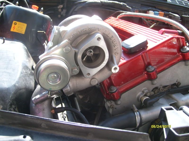

        More pics up. first step turbo off

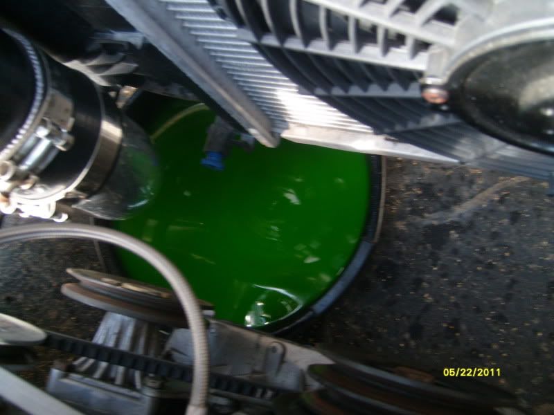

        drain shitty coolant.

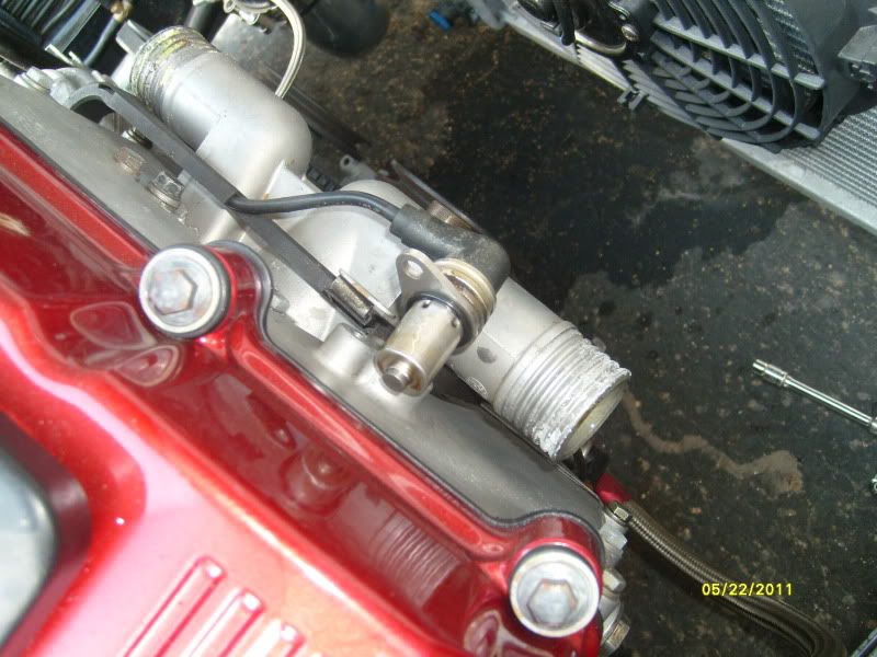

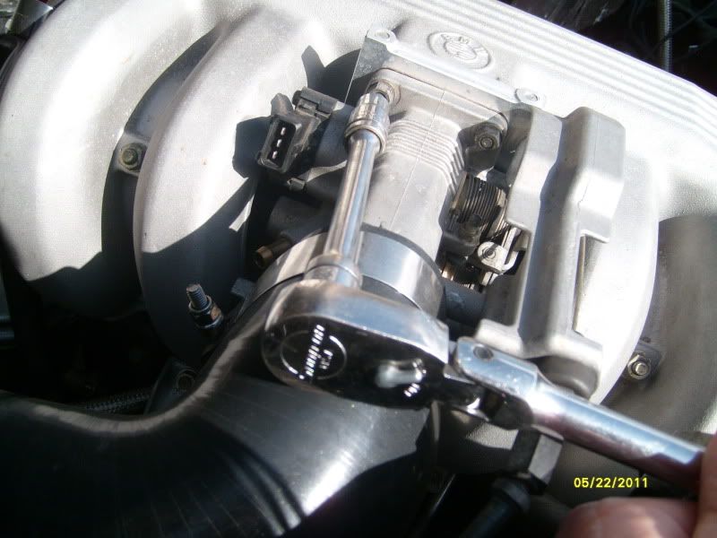

        removing throttle body
        nice and clean

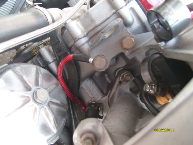

        ground wire I made to help ground the head

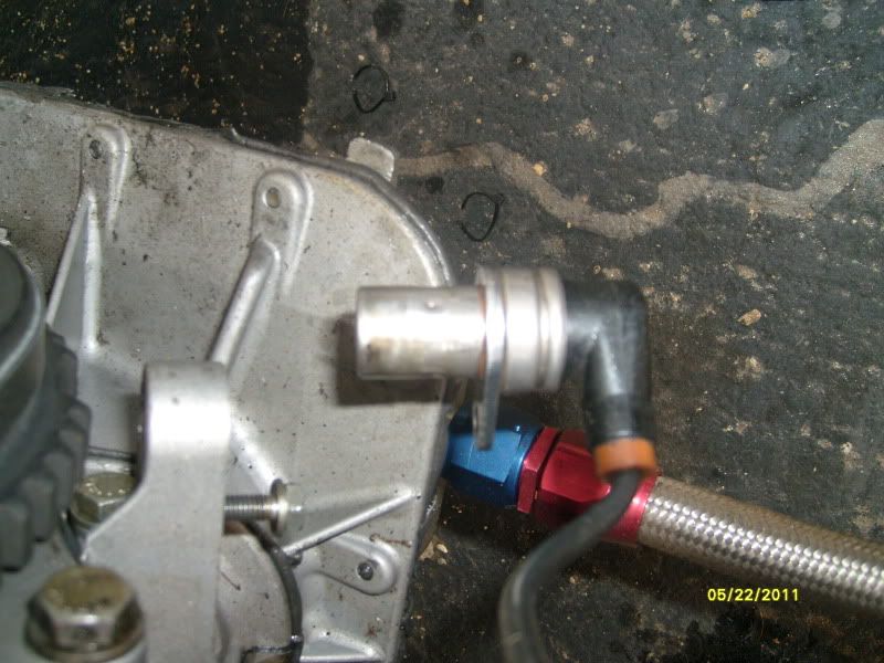

        crank sensor off. you can see my huge oil drain :)
        cam sensor out

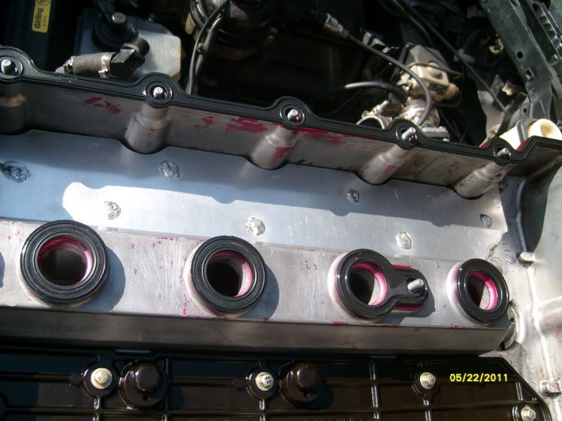

        more brackets to remove
        so clean
        tig welded oil shield i made

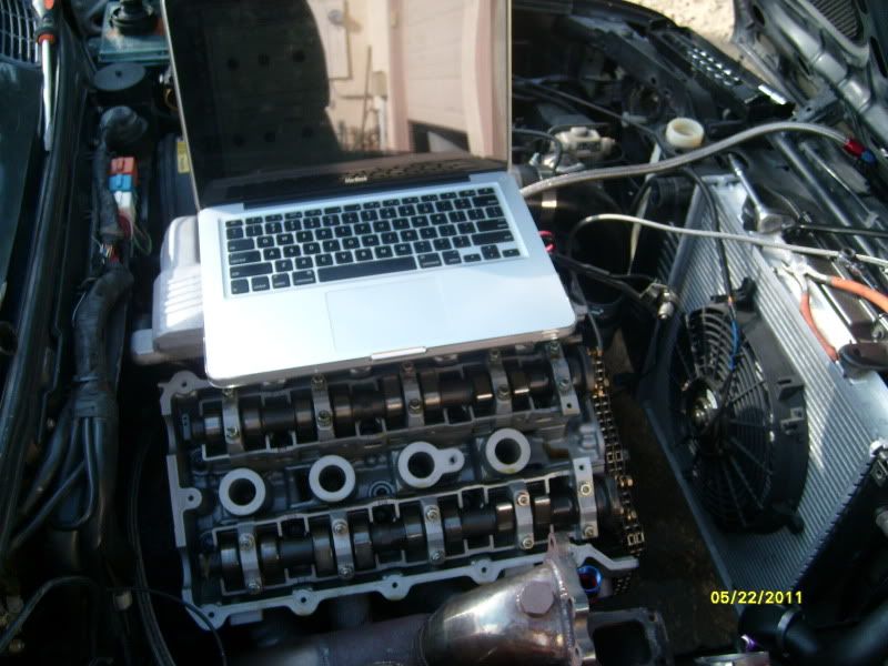

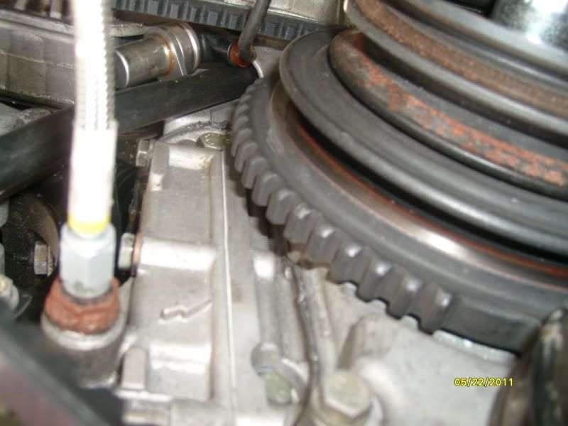

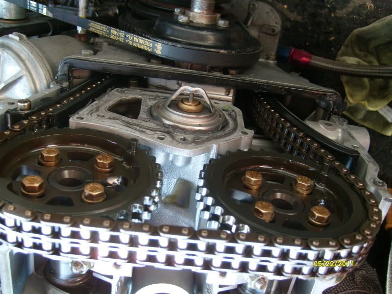

        TDC on cams
        TDC on crank

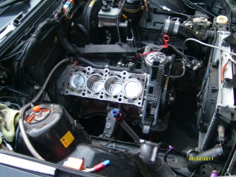

        upper front cover off. timing chain tensioner out

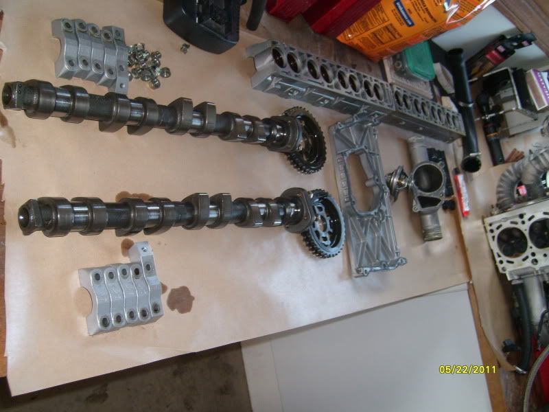

        remove cam gears and chain. you cant see the screen but the head bolt order for removing is there.

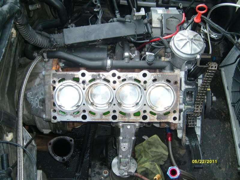

        after a light wipe down
        fuk you victor. I hate you

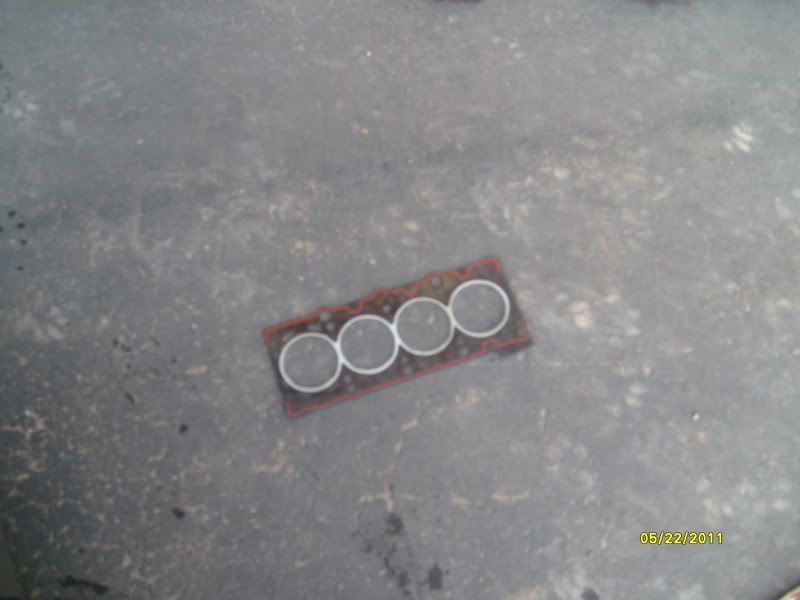

        before I cleaned and prepped for new gasket
        keep your shit clean and organized homies

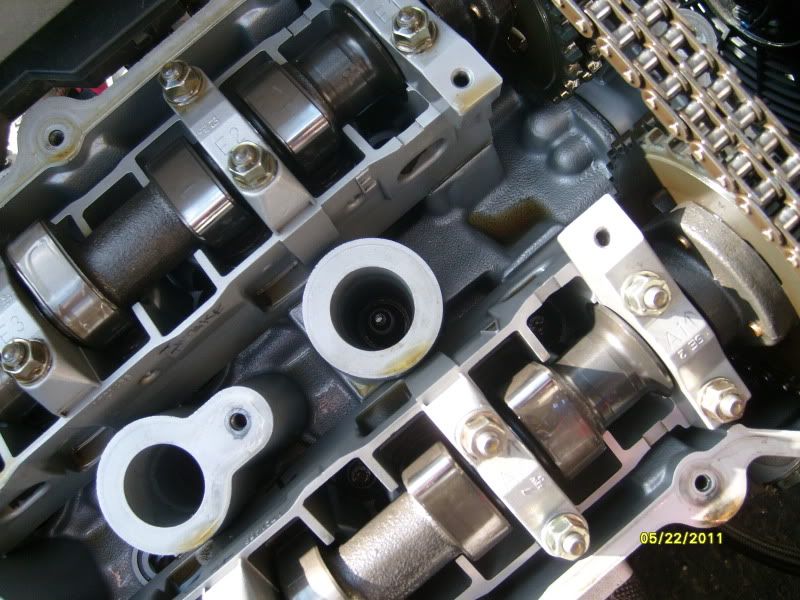

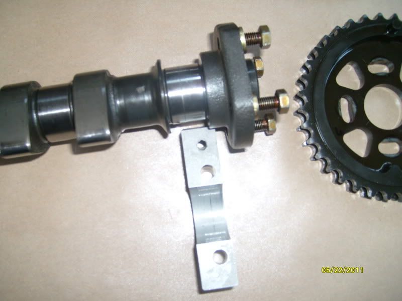

        head
        :( my exhaust cam got scored somehow. WTF. this engine has 100 miles on it. its cool. I have another cam and cap. small piece of dirt or dust must have got in there. Its hard to tell. All the rest look great

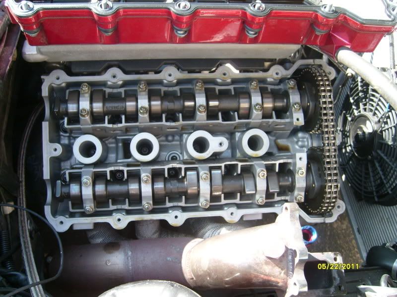

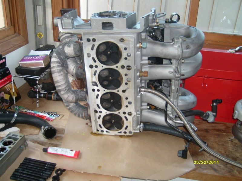

        new gasket on
        skip a few steps cause my camera died and boom. done son.... well almost

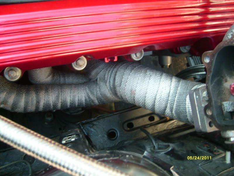

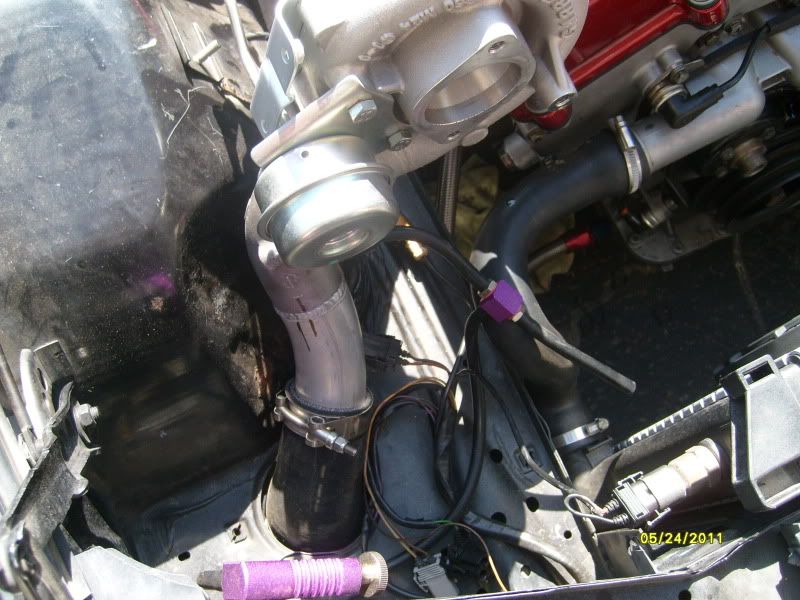

        heres my hot side just chillin, yes shitty ass boost controller i know. i have a better one so dont worry
        shot of exhaust mani all wrapped

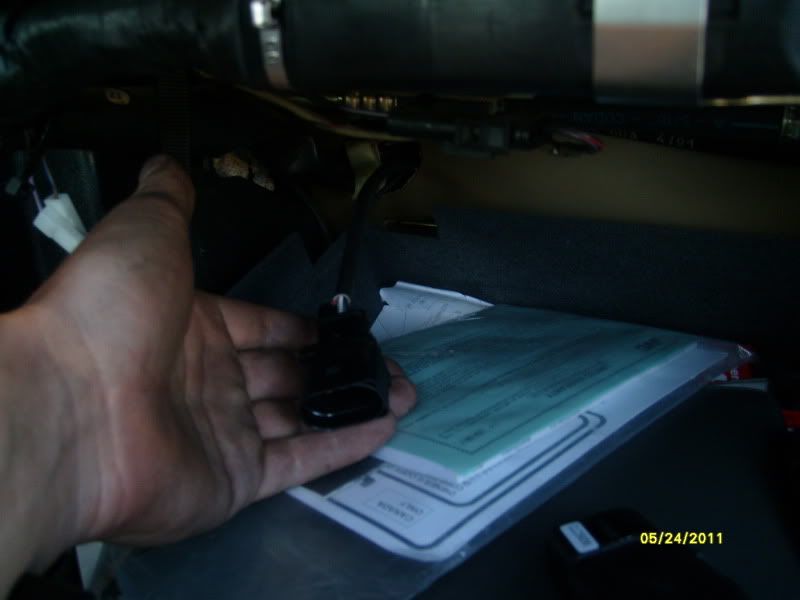

        now for the stupid shit. wire in LC1
        and waiting for gauge placement and more wiring. I bought a center vent gauge thing so im waiting on that as well. thats it for now. more to come

                        It's all a bit late now. Have you had the head and block skimmed? Did you check the head and block were true?
                        If the head and block have been skimmed enough and the dowels haven't been modified the dowels will hold the head up off the gasket and it will never seal properly. I hope for your sake it was just a shitty gasket.

                          I hope to build a turbo M42 someday. Yours looks like a quality build. Nice job. Did the HG blow in 100 miles?
                          The car ran fine so the hg didnt really fail, I just had small amounts of seep coming from the sides of the gasket. It could be that it was a shitty gasket or it could also be that my studs got loose. A few were only finger tight when I removed them. To fix the issue I used locktite to secure them better into the block
                          everything checks out just fine :up: It was just a bad gasket, or possibly operator error on install the first time.

                            Thanks for posting up a pic of your head ground* – I was gonna ask you about that..
                            *learned about electrolysis causing pitting in aluminum – which my m42 had in spades.
