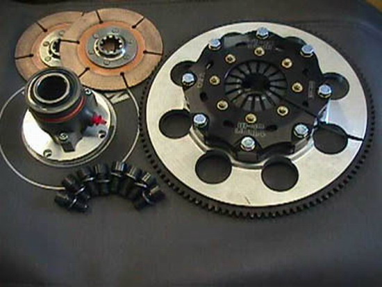

                              Check this site out they make good clutches for reasonable prices. http://www.clutchnet.com/
                              I used the 3 puck solid hub disc with a Centerforce pressure plate on my M10, held 360rwhp/333rwtq.
                              For your mickey mouse turbo I would suggest a 4 puck, it's less aggressive and will work with your pressure plate.
                              Need a Turbo manifold? We have them in stock- Click here---> http://rapidspoolindustries.com/
                              ____________________________
                              E-mail Panayiotisx2@gmail.com
                              Dyno vid http://www.youtube.com/watch?v=C7aM7..._order&list=UL
                                this will be in my hands in the near future.
