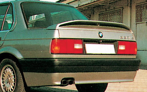

              Originally posted by gforce323i
              I havent. Dont these cover the entire rear bumper?
              It actually replaces the the bumper. There is another option... pic attached. Its a single piece from the bumper strip down. On this car they painted it black but you could also do body color.
              But enough of the rear end, we need a video asap of the beast in the front.

                DTM Fiberwerkz sells just the rear valence, it looks similar to the one pictured above.
