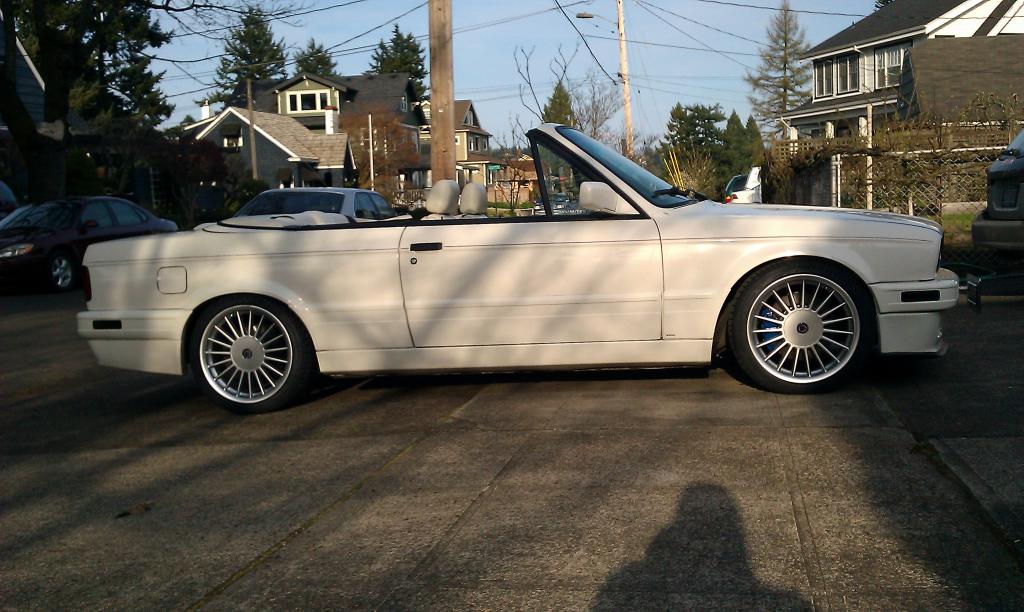

                              this is the only pic I have currently. The car hasn't settled yet and it's on a sloped driveway, but you get the idea
                              Oh and I also fitted new tires, Continental ExtremeContact DW in 205/45r17. Spendy ($133/each) but they ride and grip infinitely better than the Pirelli Pzero Nerro I had on before.
