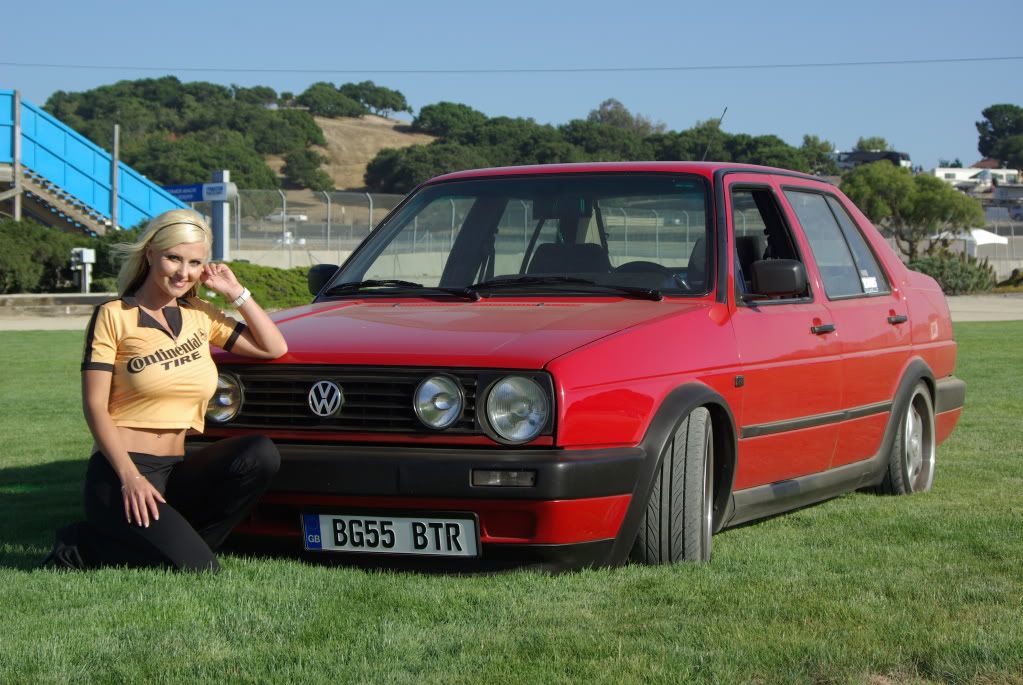

Engine:
VR6 swapp from a 93 corrado, machined and rebuilt by Tomas Sportstuning, with AWE head gasket which increased compression from 10:1 to 10.5:1.
Heavier springs installed in preparation for bigger cams.
Turn 2 motor mounts, and Velocity lightened/balanced flywheel.
Mocal oil cooler installed, and original oil cooler sandwich plate removed.
Garrett sports chip.
TT 2.5” stainless steel exhaust, with only one resonator and a Borla muffler.
Suspension/wheels, etc.:
H&R coilovers.
Standard VR6 Corrado brakes, with Ferrodo street pads, and Velocity SS brake lines.
Eibach aluminum front upper stress bar.
5-lug full conversion
Current wheels are ABT A22’s 16x7.5 with Yokohama Sdrive 195/40/16
Exterior:
Front “banana” markers deleted, and euro side markers added.
Front turn indicators are smoked.
Front GTI grille
Rear smoked Hella taillights.
G60 wider fender flares.
Interior-
Mk2 Jetta Recaro interior.
AWE short shift kit,
VW Motorsport knob and leather boot.
Took these over at laguna the other day at the continental tires race weekend.
