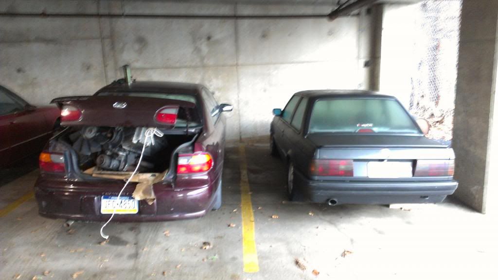

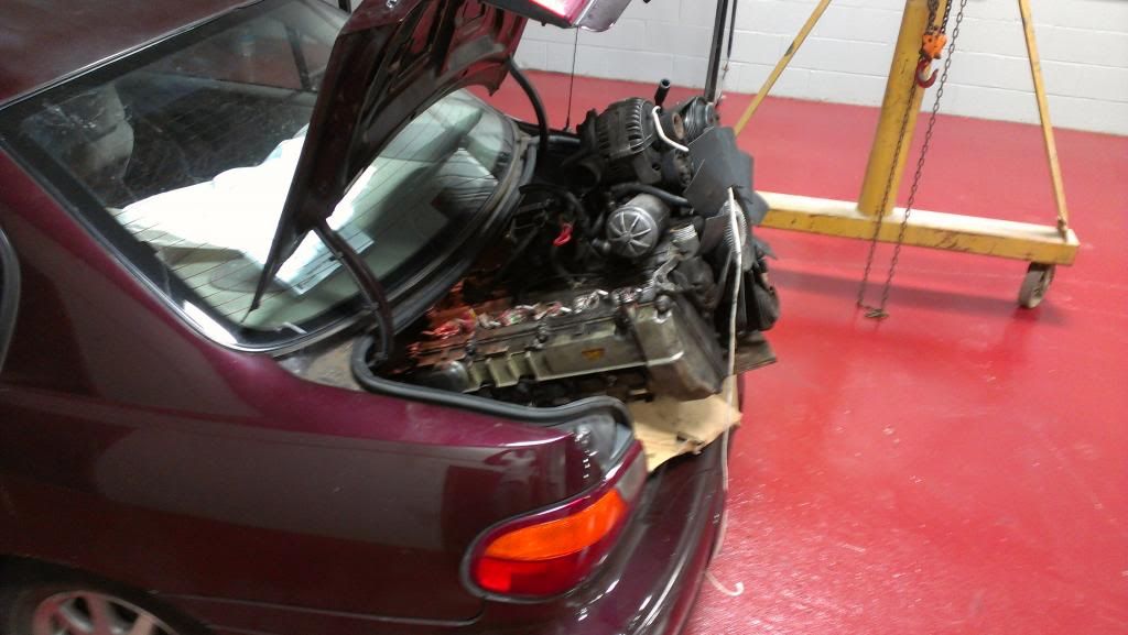

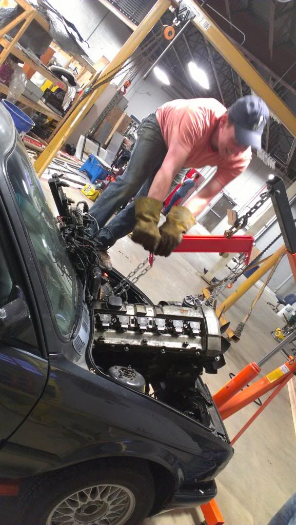

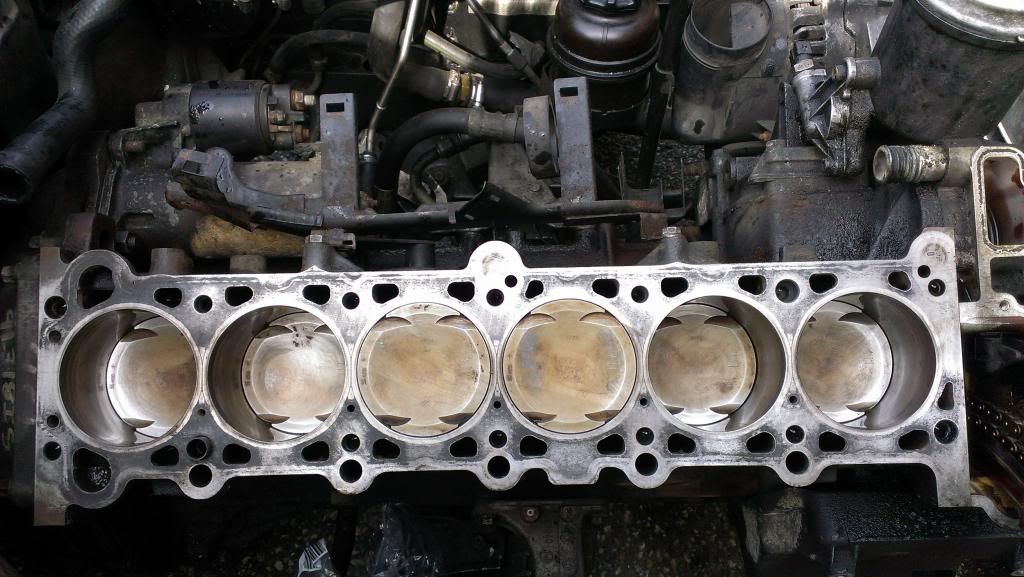

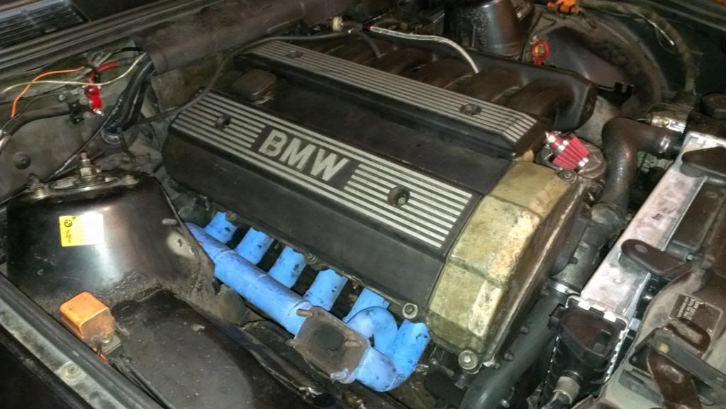

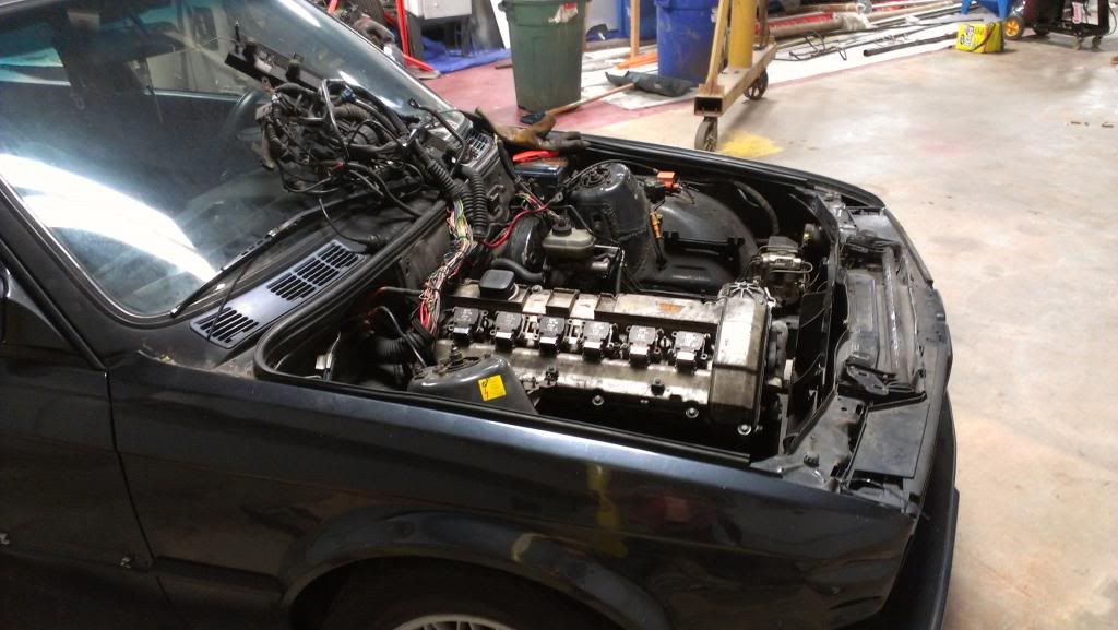

    long overdue pictures.. will get some of the pretty custom engine build pics when the CP Carrillo stuff gets here. this is just the OEM test platform gonna run like 7 -10psi and learn / workout the megasquirt stuff on this poor thing
    First two of when it first came in. bought that for 200 bucks but turned out it had a bad head gasket. -- was supposed to be the pic above

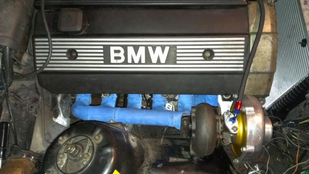

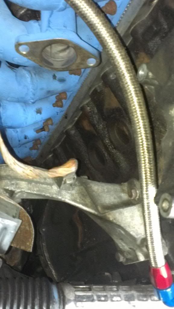

    then what i did with my time awaiting parts for the real build....
    I think i need a strut bar lol

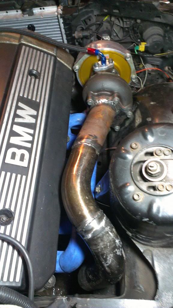

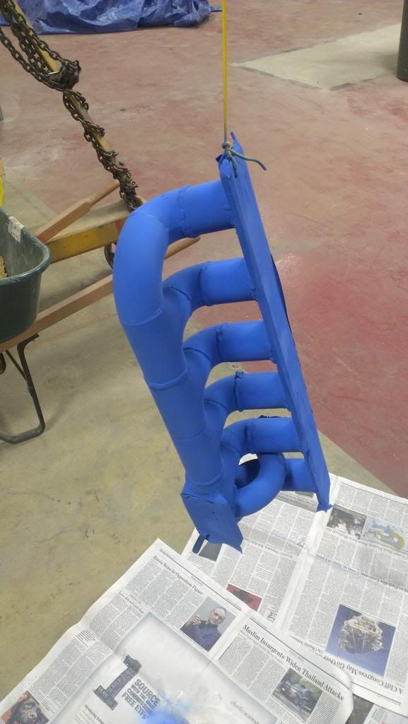

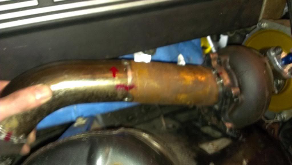

    working on finishing up the downpipe now, need to adjust a little as the first measure and fit didn't work out quite right

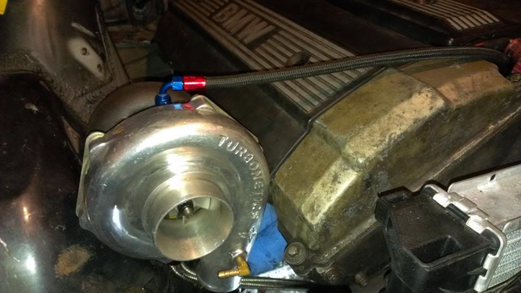

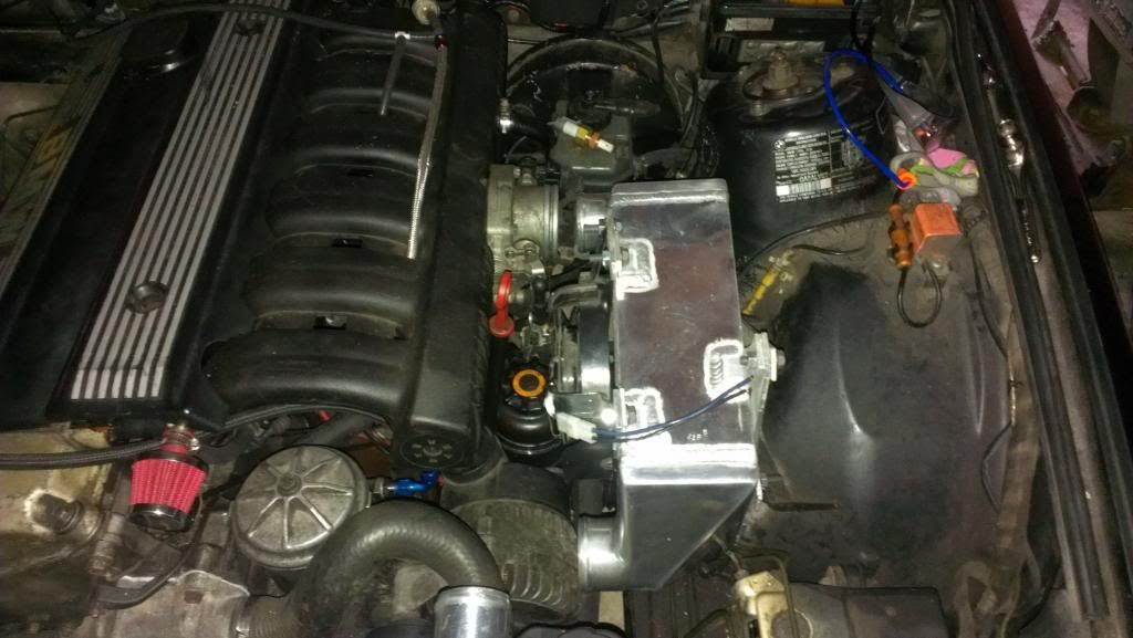

          video of compressor wheel on first start (no charge pipe)

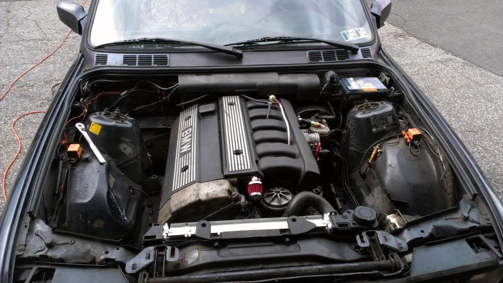

          more current pics and a another video link to the first start of the engine and turbo together (no charge piping though). I just need to finish up the charge pipe and a few more small wiring things and she'll be all set for a day of tuning.

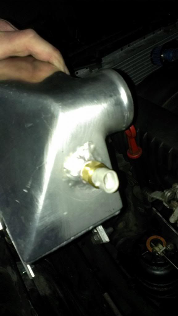

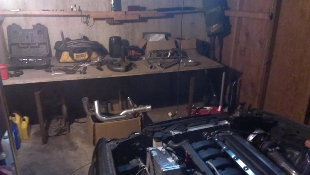

          Custom side mount with a fan setup so i can go sleeper with this thing, gonna duct it from a head light bucket at some point and still need to trim the backets to get hood to close
          and my new work table for bay 2 taken straight from the dumpster

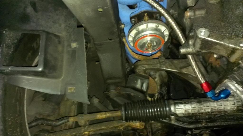

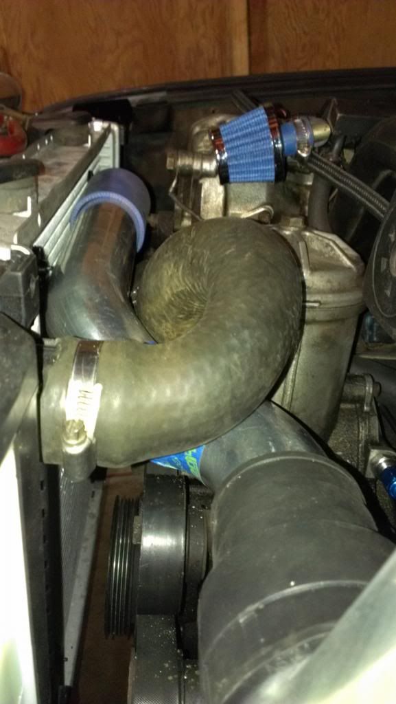

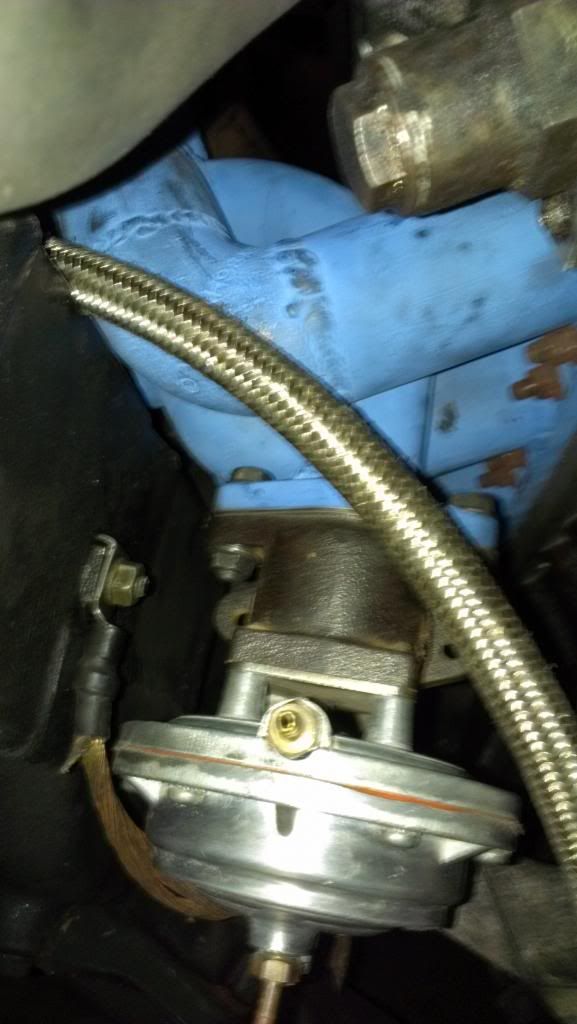

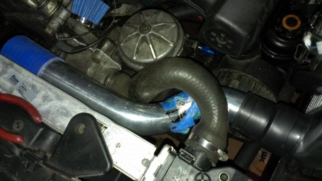

              charge pipe construction.. sleeper mode all under the hood and pics of the wastegate location. outlet straight back to downpipe
              i know it looks like it but the finished product wont actually touch the rad hose, no conduction there but small conerns about convective heat soaking, thiking i may install a meth injection for safe measure if i choose to run more than 6-8lbs
              little 3-5lb spring in a deltagate with a boost controller for the megasquirt. perfect for low boost operations to around 8 psi

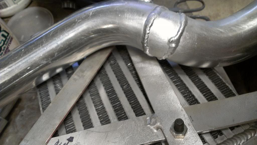

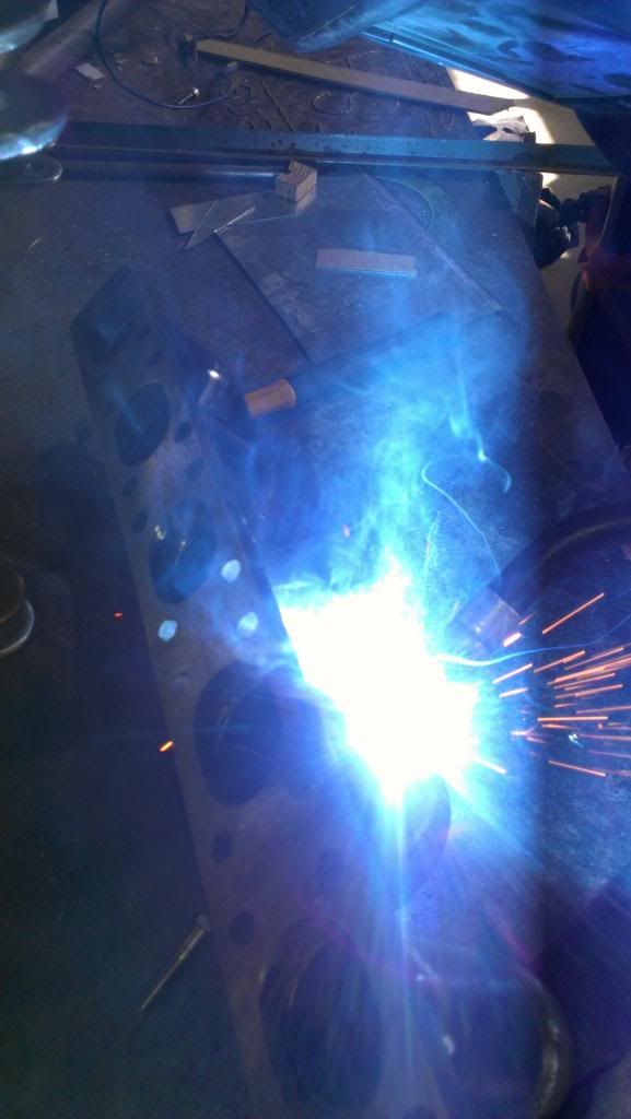

                    some quick shots of my TIG work. I'm no pro but its not gonna leak.

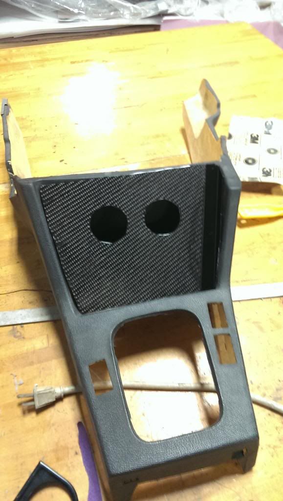

                          my first try at hand laying carbon fiber. This was just made from a scrap piece cut from a large diffuser made for the FSAE chassis wher i work. Pretty simple little gauge pod for AFR and boost. may add a third for oil pressure later. I also really want to try and completely wrap a center console if someone has a spare they can give me laying around.
