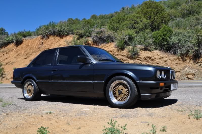

                          • Holland
                            • Nov 2008
                            • 7212
                            Originally posted by glnr13
                            Oh wow. So much like mine used to be
                            Originally posted by DEV0 E30
                            • Kershaw
                              • 11822
                              that looks great man.
                              AWD > RWD
                              • lambo
                                Captain Scene Points
                                • 10953
                                Looks great! If you don't mind, would you be able to snap a picture of one of your wheels in this perspective?
                                I'm trying to figure out if these wheels would look odd with studs.
                                Thanks!
