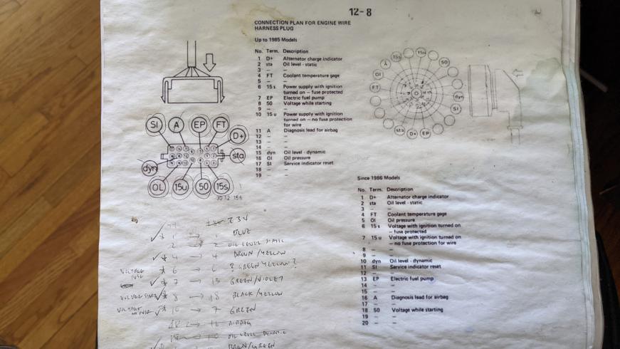

    Just looking back through your thread - any tips for wiring up the M30 into the early chassis? I'm going to pick up an early 318i 2-door soon as a long term project, and will likely throw all the good bits from my sedan into it.
    Cheers
    Luke
    I cut a pigtail off a car at the junks...
    here's the info i gathered to splice into that pigtail:

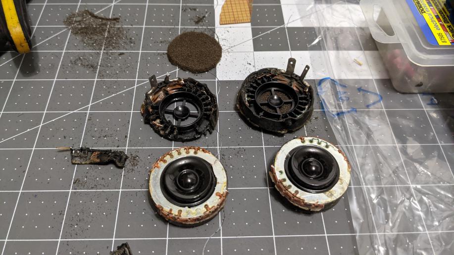

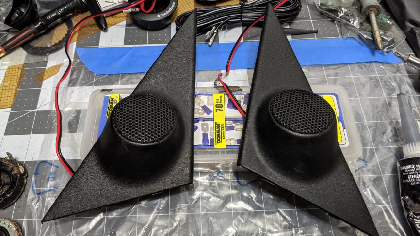

    • 5.25" to 6.5" all around + tweeters
    Gutted some tweeter pods:
    no heat necessary. just needle nose pliers to crack the glue that holds the tweeter in and then repeat same steps for the core/housing.

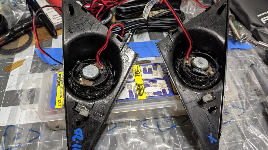

    black silicone'd the new tweeters in place:
    Click image for larger version  Name:	ztz30Gj.jpg Views:	0 Size:	90.8 KB ID:	10019840
    it's not pretty but it's in there solid and will be fairly easy to remove and clean up if i ever need to replace them.
    all glued in:
    Click image for larger version  Name:	6VghAyy.jpg Views:	0 Size:	86.8 KB ID:	10019841
