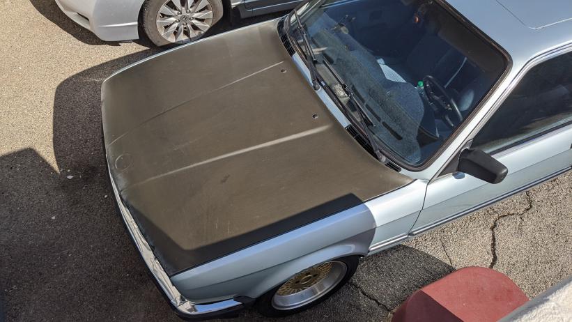

    installed a VISracing hood that i've had in storage for years. euro valance to go on maybe this weekend.
