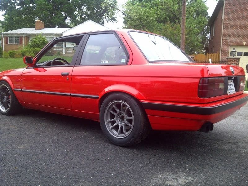

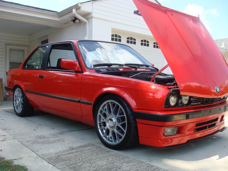

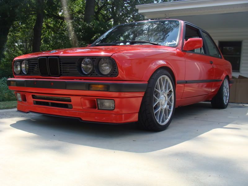

    what up guys! been on here for a while, never really made a build thread or intro so here it is. the basics:
    89 325i hellrot red
    ie3 springs, bilstien shocks, e90 drop hats, 15mm pad in rear
    rx7/corrado bbk, hawk pads all around, ss lines
    cabrio sway bars, strut bars, e30m3 control arm bushings, all new rubber

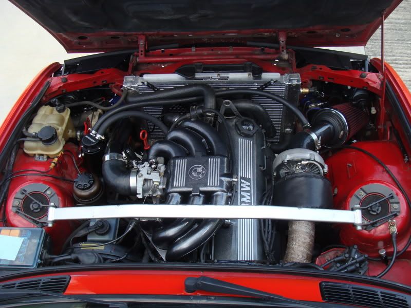

    2.5l m20
    oringed block (thanks boris!), stock gasket
    arp headstuds
    vac turbo cam
    garrett 60-1
    tial 38mm wastegate, hks ssqv bov
    3inch exhaust magnaflow res, dynomax muffler
    megasquirt 1extra with wasted spark and gm coilpack
    uuc stg2 clutch, 3.25lsd rearend
    last dyno the car made about 440whp 415wtq at 18ish psi. i was using a cheap mbc so boost control wasnt stable in all runs, got that fixed with a hallman mbc. also changed my plugs and gapped them to .025 instead of .029, because it seemed like the graph was breaking up after 6k rpms.

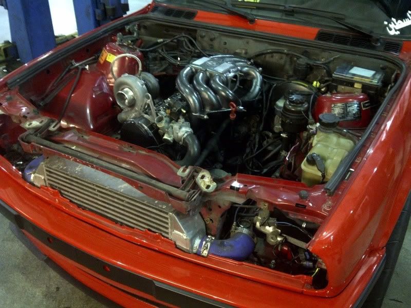

    this is version 1 turbo build, .50ar t3t4, 3inch straight pipe stock motor. walk around and sound check.
    highway pull. this is my old turbo setup car had about 300 wheel. recorded with one hand on wheel fishtailing lol.

      What front strut bar is that?

                not sure on the strut bar, i bought it new locally for 20$ and it has no branding on it. probably ebay material lol, but it is really sturdy and pretty :)
