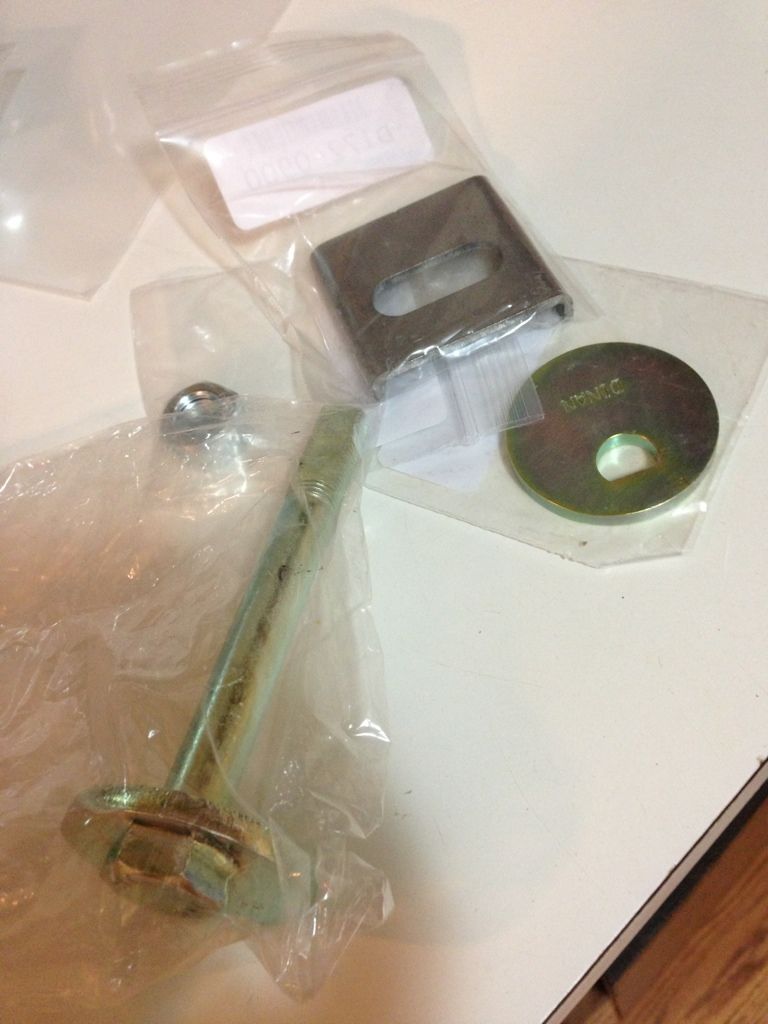

Its the hardware that goes with there weld on camber and toe kits. (Ive got a subframe w/ dinan tabs welded on but didnt come with hardware) He kept telling me that everything ships out as a qty of 1 but each is a set of 4. I havent been able to talk to him yet but ill get ahold of him today and see what they can do to fix it. If they cant get me hardware for a cheaper price then $92 a bushing plus shipping, ill be sending it back and figuring something else out. Considering the entire kit is $400, 377 for the bolts is retarded.Comment

Dinan kit the guy that does the subframes (robb @ godspeed fab same guy that did erich's driftcars) said he uses um because its beefier hardware. Apearently its beefier hardware wrapped in gold. He said hardware kits were $60. Hes gonna look into why its so much also.Comment

The Dinan adjustable kit uses Bent flat-stock steel weld-on brackets, that was the whole reason IE started making the eccentric kits 10 years ago in the first place (with the end plates made from machined cold-rolled steel). The bent pieces are 1/8 the cost to produce so you can see the appeal.Comment

This is the entire contents of what i was sent. Not entirely sure how im supposed to mount the trailing arms with 1 bolt
Talked to dinan tech. Appearently they only sell the "inboard" camber adjustment. I wound up with the hardware for 1 side and a single "reinforcement tab" aka one of the weld on pieces. My subframe is essentually setup with 2 camber kits with the outboard being turned 90 deg. This means ive now only got $202 in hardware left to buy. Still hurts but its better then twice that. Ill prob just buy the other side and crank down the toe to try to get it to hold. Its a bit more getto then id like but after spending $1000 in carparts over the last week while buying stuff for the new house my wife already wants to hurt me.Comment
