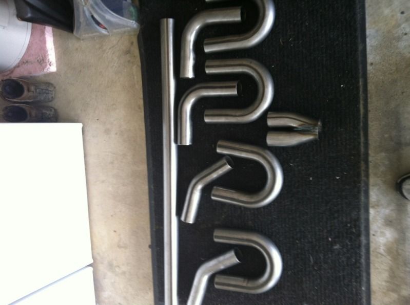

      2.5" mandrels from columbia river mandrel

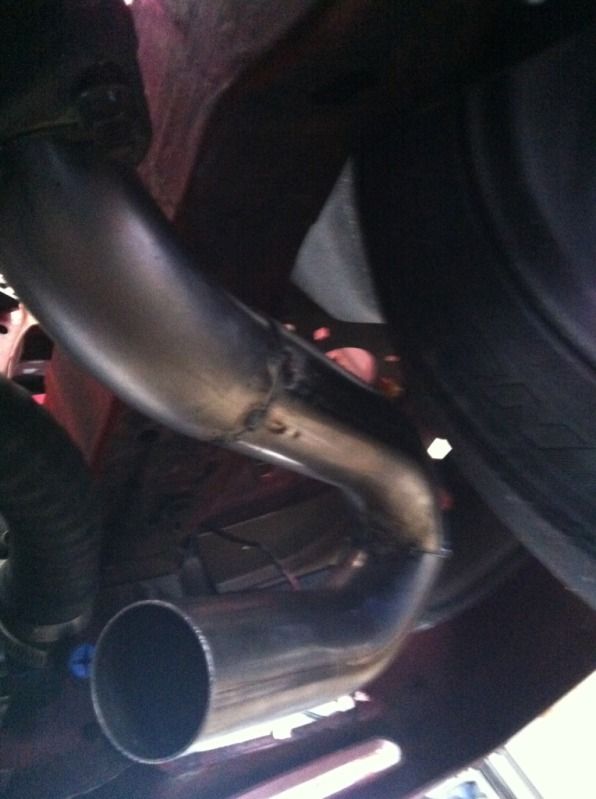

                      it was hell trying to snake that 3" through. randy my exhaust guy got it done though. i can still get the starer out and the entire front section can come out if i need it to.
                        exhaust wrapped (yes thats all of it for now)

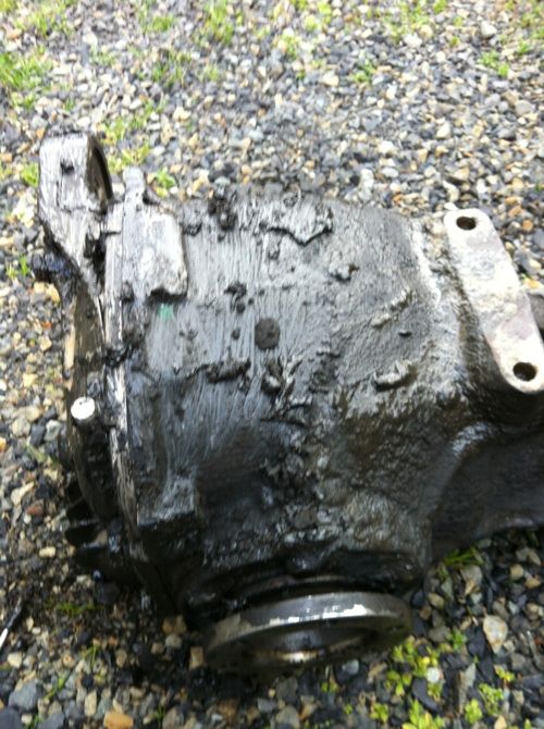

                              that's the way my old diff looked also... like crap

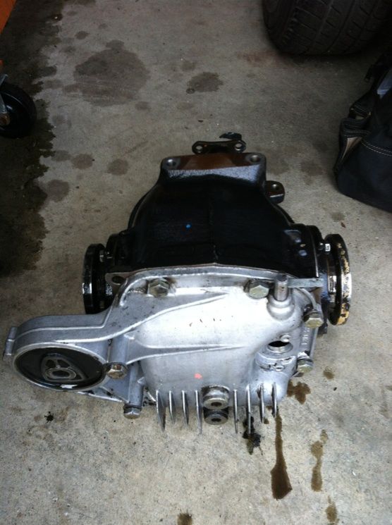

                                dif is out. swapping the speed sensor and getting everything ready to put in.
