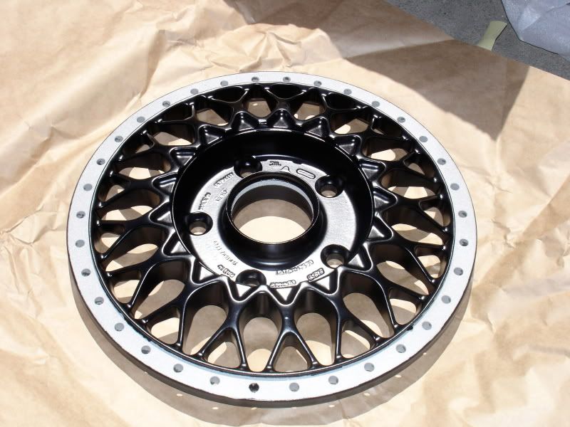

Next I had the old faces stripped and re-powdercoated by one of the best in the business here in San Diego, in a semi-gloss black.

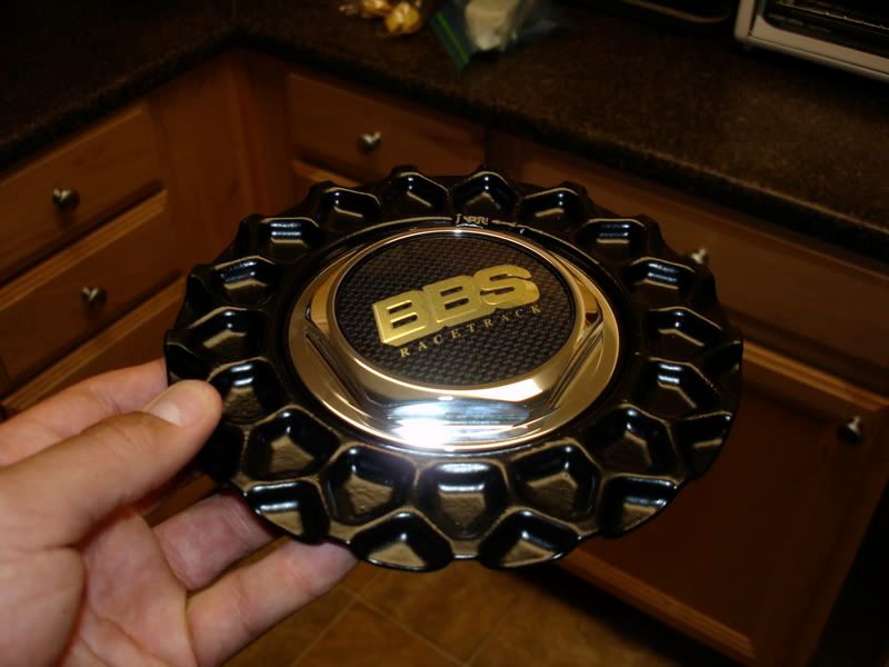

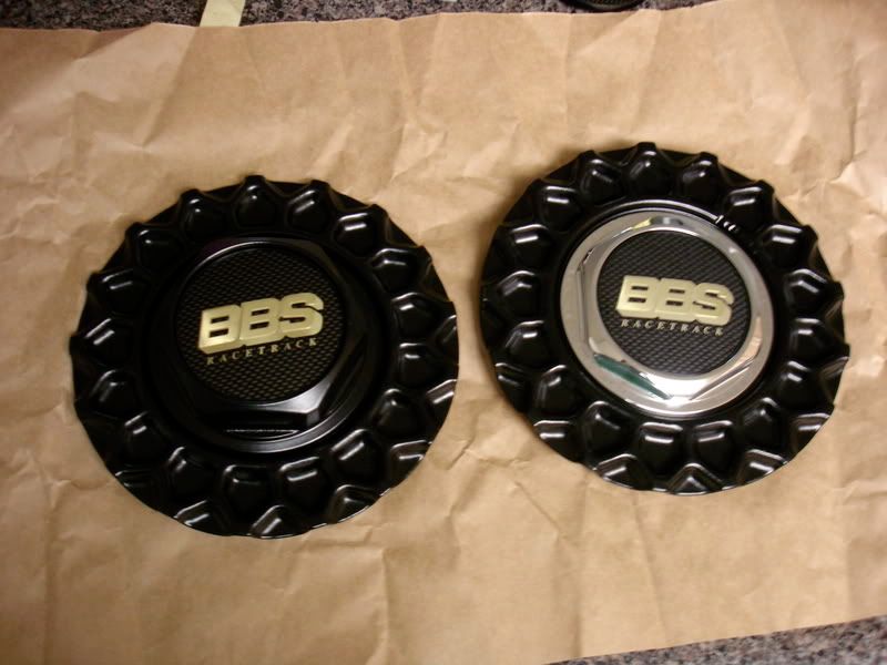

From Felgen Garage I also bought some dope 1/4in caps that came highly polished! These are 100% aluminum, no shitty plastic inner threads (like all OEM BBS caps come) to crack or break later. And when I got the faces powdercoated I also powder coated the stock height BBS caps the same semigloss black, for a murdered out look!
