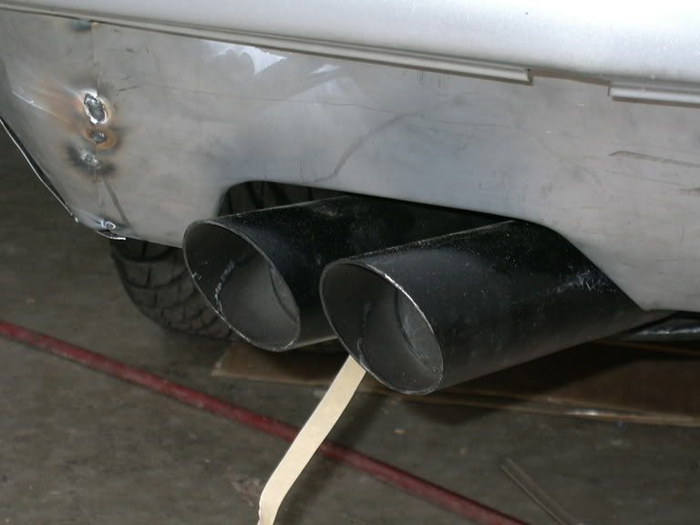

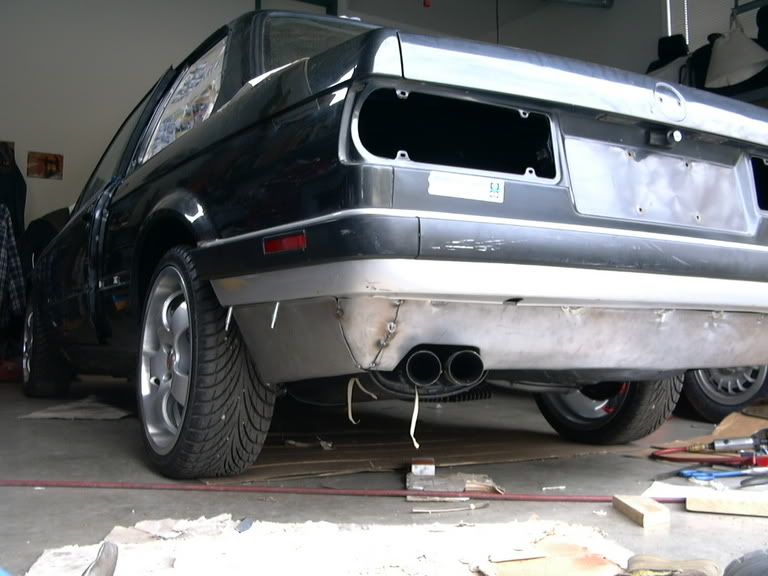

    jrez, what rear apron did you use on the car, under the rear bumper? It looks to be the stock apron from a late model car, cut off and fitted to your car. If that's the case, how did you attach it to your car? I've been playing with the idea of doing exactly that for my car for a while now.
    I fabbed the lower apron out of sheet metal, after a bunch of pics of a '90 318is. It's attached to the plastic bumper, so it's one piece.

        I am curious how much labor you put into the plastic bumper retrofit. I have read Jordan's write up and heard how hard he said it was to do, but I have also heard from most other people that it isn't as hard as he says it is. What do you think?
            I have a feeling Jordan made it seem harder than it is to discourage people from "copying" him. It's by no means easy to fabricate the rear bumper sides the way he did, but its not impossible.

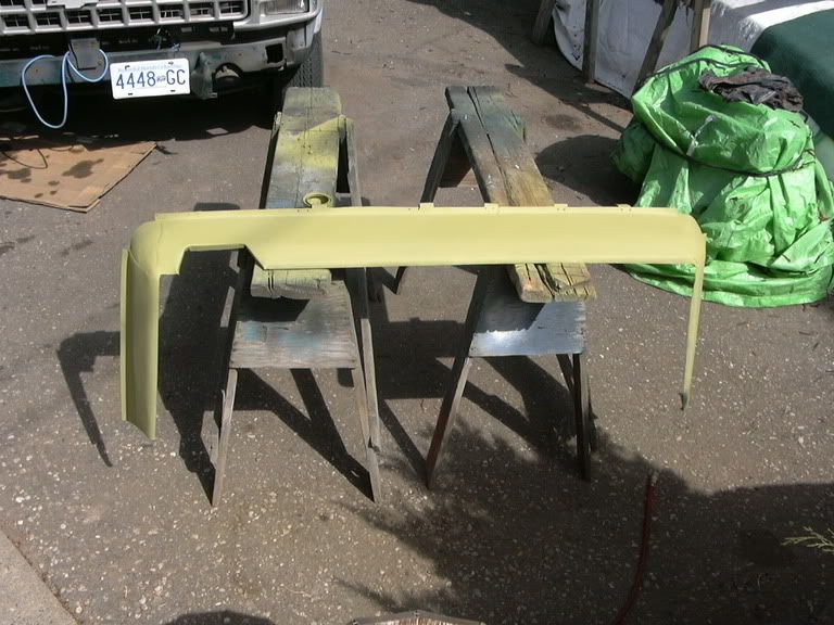

                      The plastic bumper fitting on the front was basically bolt-on, except for two mount holes not quite lining up. Really no problem.
                      The rear was a slightly different story. The biggest problem being the lack of a recess for the bumper to fit into the fender lip, and the bumper itself being about a 1/2"-3/4" too long in the same area.
                      I did a lot of trimming and forming(with a heat gun) before I got it to where I thought it looked right, and just like the wheels , I'm happy with how it looks., Overall, it's not a bolt on, but its not rocket science either. Just requires some thinking and patience.
