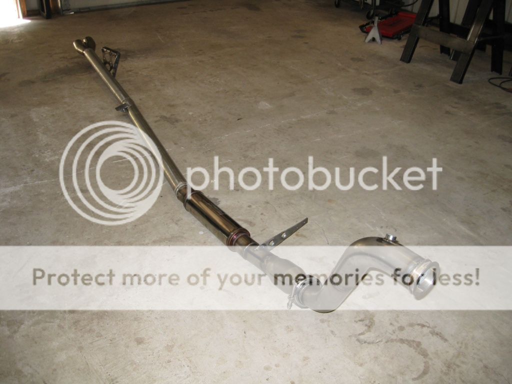

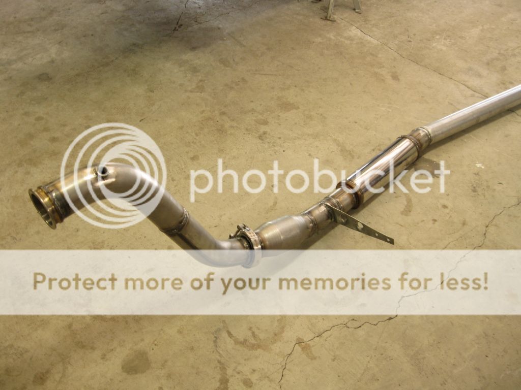

        Wow, thanks guys. Hope to have this thing running real quick like. just came in from porting the intake mani. Hope to put this exhaust together tomorrow. Muffler will go right after the cat in the center of the car. Dual 3in tips.
        Here is how the exhaust came out. All 3in, vband at the turbo and the bottom of the down pipe.Im happy with how it came out, super close to the body. Just hopin its not to loud. Turbo, cat, muffler, should be OK.

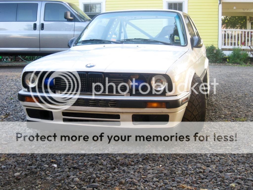

                Very nice work, very vlean. Interested in some more info on the bumper work? How did you tuck? Cut and reglue together? Hit me up
                  Basically just use the bumper cover. No beam. Its easy to make brackets because of the removable trim, so you can hide the mounts bolts or screws behinde the trim ya know. You may or may not want to remove about .5in or so from the top of the bumper cover edge. It sits pretty tucked if you just leave the covers stock and set them against the body.. fab some bolt on brackets to go behind and attach. Its probably easier than it sounds.
