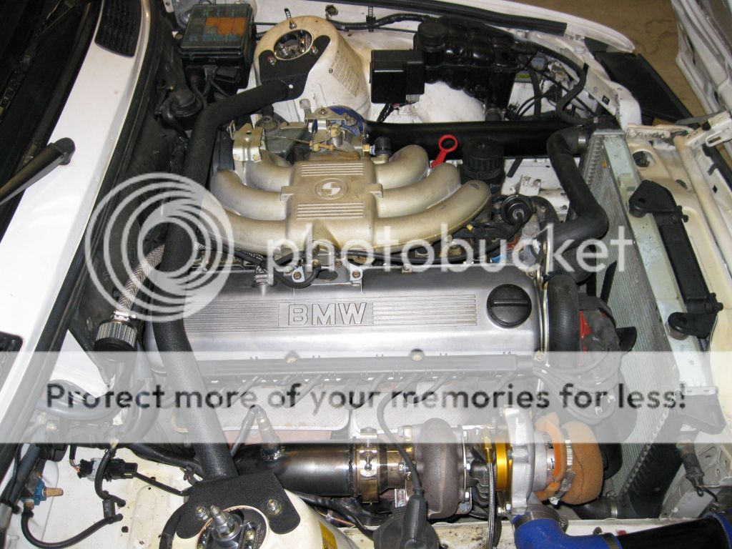

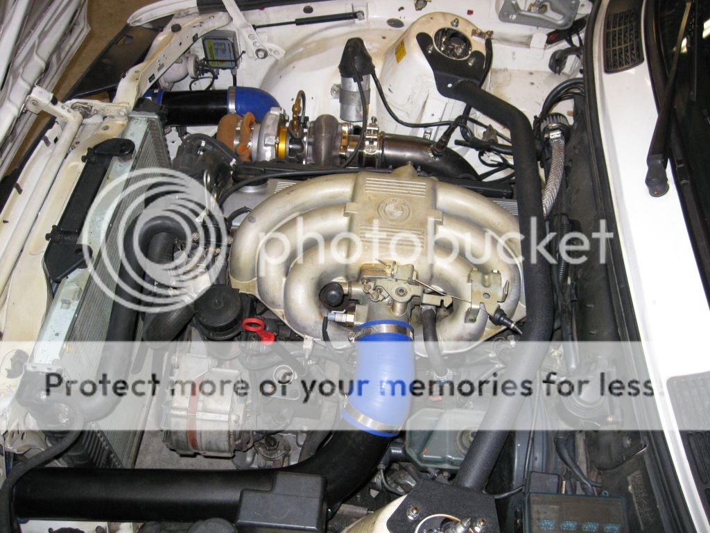

        After a few goof ups in my megasquirt PNP set up (all my fault), Derek at DMS (bluepineapplesoda) and Russ at DIY got me all dialed in. I drove and tuned a couple nights. I used the VE analyzer that megasquirt offers for $50 to auto tune some of my settings, along with a turbo tune that Derek sent me. And some mapping changes that I made for my set up.
        I cant believe how good it idles and starts up with the 60lb injectors and no factory IDCV. Just turn the key and its ideling. I have to admitt i was a little intimidated to deal with tuning a system the I had never used before, but if i can do it. Its actually fun to make changes in the tuning. And it runs fucking killer.
        And to top that off i went to the Oregon DEQ today and it passed no problem. All legal and on it. The guys working there were looking at me kind of funny, all caged and strapped in. One of the guys asked me if the motor was stock. I said of course it is, he laughed and told me he had a 98 m3 and used to have a e30. I think he was suprised it passed. Anyways here are a couple engine bay shots. (never minde the ghetto filter) I have to find on that will fit. And for those that might have been wondering, I also stoped by the scales today. It is 2400lb almost empty gas tank. ive got another 100lb to pull out.
