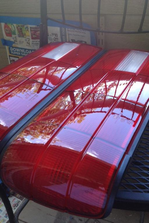

        Thinking of doing all red tails, yes?
            Mine turned out great. I say do it.
            • jeenyus

                Originally posted by jeenyus
                [ATTACH]88571[/ATTACH]
                What'd you use?

                    Originally posted by Zreberlcoe
                    What'd you use?
                    I used some candy-red paint they made for me at the auto paint store. It is translucent and took about 3 coats to make it look right. I then covered that with a 2k clear. It was all done in an aerosol can. Super easy.
                      Do you know the about cost?
                            The red translucent paint was 17.50 for the can. 2k clear was pretty close to 20 for the can.
                              Cool, did you use anything to clean them up first? cause I have a white scuff on one and Idk if it'll come off..
                                I did use some prep-all and then a light coat if adhesion promoter I had. I paint a lot of stuff so I had most of this laying around. It really is simple though and makes a big visual difference.
                                If you go to an auto paint store I know they will set you right if they know anything.
