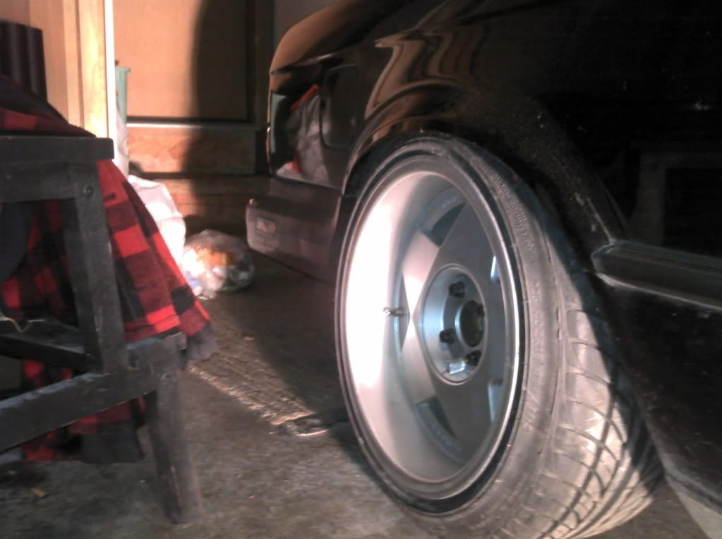

Current setup is 2 5/8" off the strut housings, GC camber plates, 1.5" shortened and revalved Bilstein ix HD struts up front, revalved Billy sports in the rear, 5" 787lb Swift springs up front and 4" 900lb Hypercoil springs in the rear. Front is halfway down, rear is all the way.
GC's normally come with either 5" linear springs or 5.5" barrel springs in the rear.
And a 5" spring is a 5" spring, the spring rate doesn't change that. Unless we're talking Nascar springs lol. A 5" 900lb spring will ride higher than a 5" 750lb spring though; my old rear springs were 5.5" 450lb springs with no adjuster and they gave me the same height as these.
With the 225's I'd have to pull the fenders which I'm not comfortable doing with a hammer like how I rolled 'em ;) And before I get a bunch of chit chat about hammering my fender's flat, they are fucking perfect.

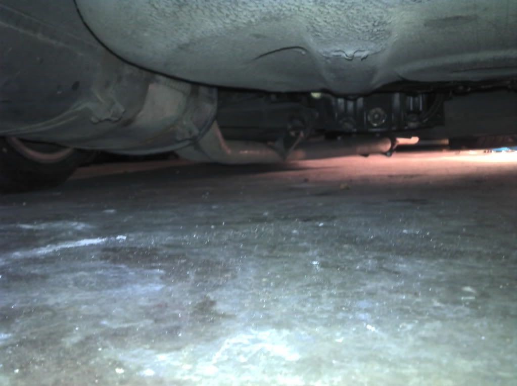

That and I daily drive this bitch 80 + miles a day on some of the worst highway on the West coast. Today I scrapped off 2 reflectors while lane changing. I know because pieces of both stuck to the under side of the frame rails.

:rofl did do you have a skid? only my exhaust hit reflectors and that doesnt count. if i had a skid though it would
I have never been able to get the hang of the baseball bat. At this point in time it really doesn't matter as the cars going into paint shortly here ;)
