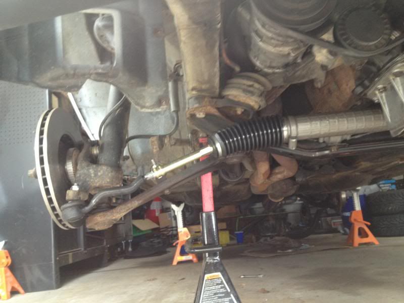

        'Nuther day off of wrenching accomplished! I did the "Mess Under the Intake" mod, eliminating the throttle body heater plate and the convoluted mess of failing coolant and vacuum lines associated with it. That should take care of the vacuum leaks!

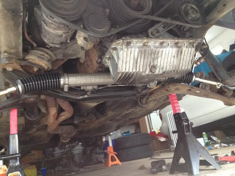

        I also wrestled with the grimy old steering rack for what felt like all day. Every step of the process was a struggle but it finally came out and I got a chance to degrease the subframe. I'm waiting on outer tie rods to finish getting the new rack installed. Then I can put the rest of the car together, bleed the steering and the brakes, and maybe actually drive it! You know, before parking it again to work on some more stuff :crazy:

          3/14/13: Steering rack is in and bolted up! Just need to put the rear brakes in and bleed the coolant and steering. Fingers crossed for no leaks!

                  Steering rack in. Now everything else looks like crap around it:

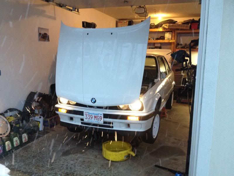

                        Bleeding the coolant and power steering:

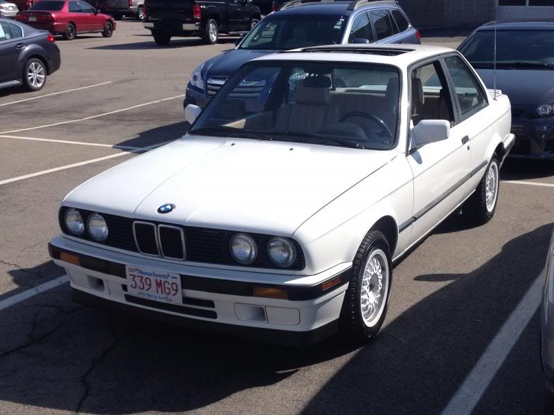

                        Out in the sun, finally!
                        Unfortunately I didn't notice that one of the heater hoses had a cut in it, so on it's maiden voyage it peed coolant all the way to my friend's house and back. And I seem to have a hot start issue. And I connected the throttle cable incorrectly, so it came disconnected at one point. *sigh* Back to the garage again!

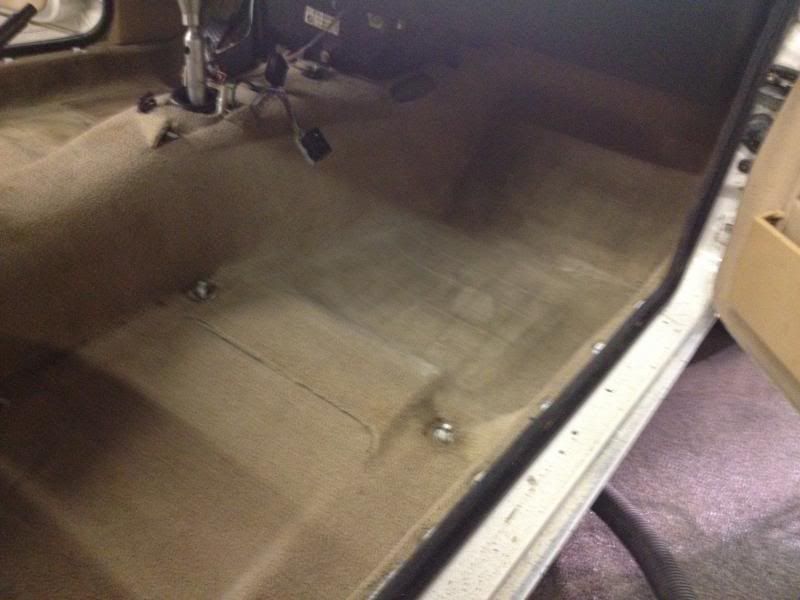

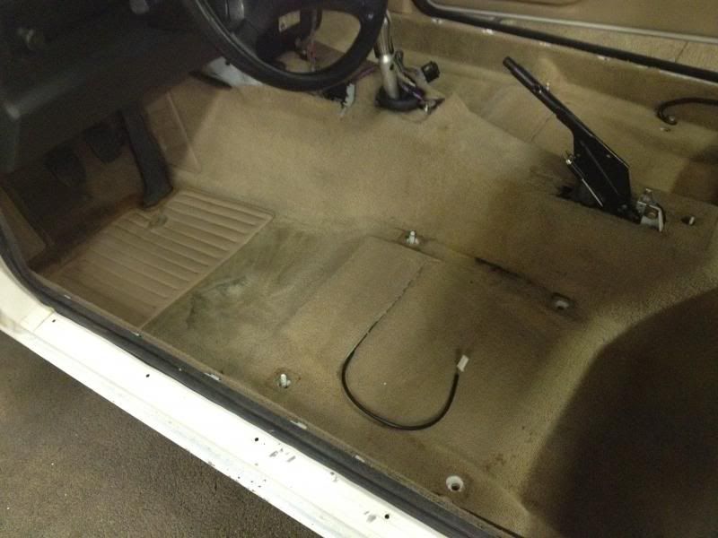

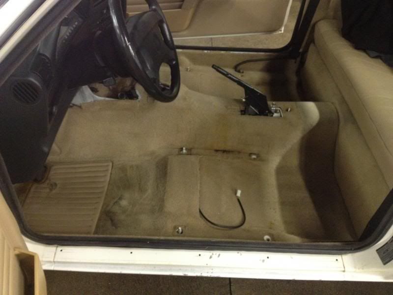

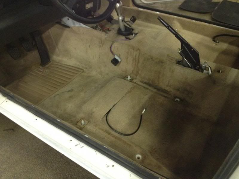

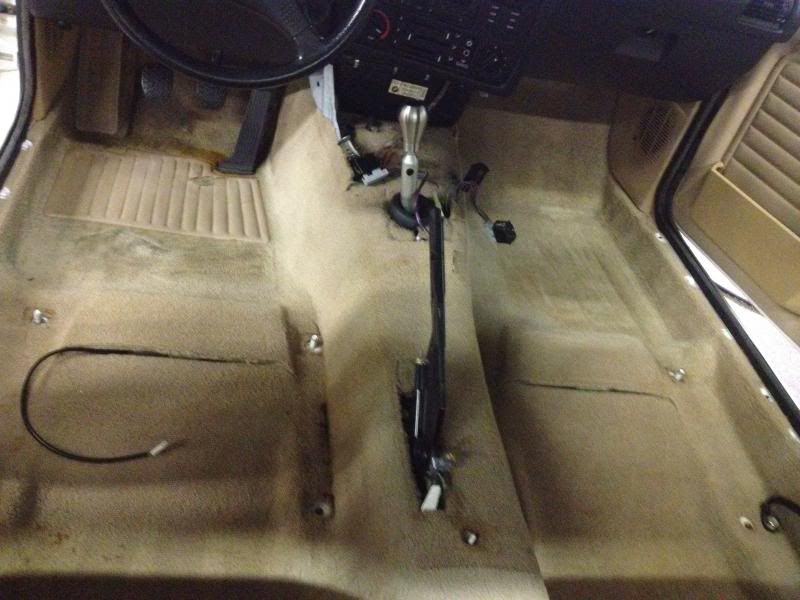

                              Got a chance to steam clean the carpets last night. They didn't come out perfect but they look 100x better than they did before.
                              Before:
                              After:
                              All back together:

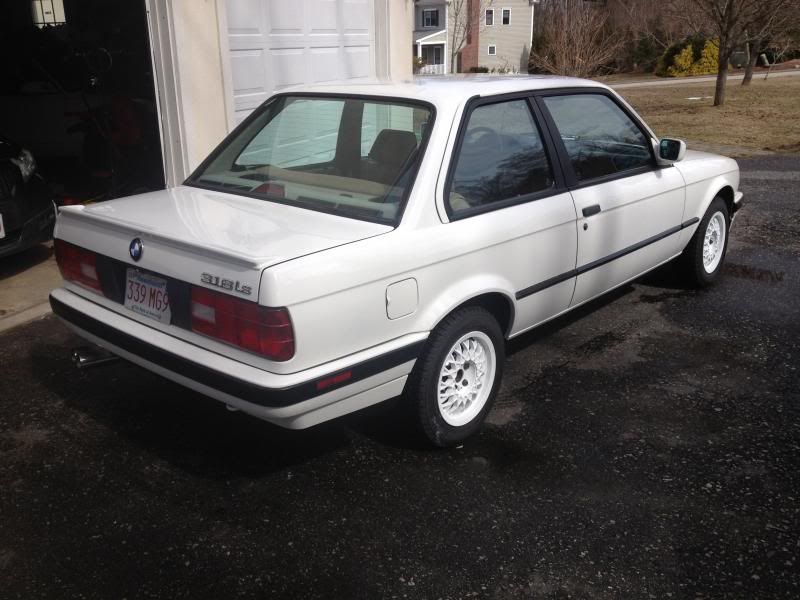

                              Took it to work on this sunny day:
                              Need to work on my photography skillz... these photos are admittedly a little boring...
