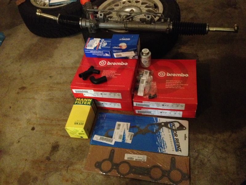

              Ordered up a reman. steering rack from Rackdoctor.com, brake rotors/pads from BavAuto and intake manifold/plenum gaskets to start tackling the mess under the intake. I was tempted to do the E36 or Z3 rack conversion or upgrade the brakes, but I know once I start down the path of modding, I won't be able to turn back. There's wayyyy too much aftermarket support for this car and I can't afford to get into the "while I'm at it, modify this" mentality with this car. So it shall remain 90% stock with the exception of lowering springs/struts, wheels/tires, an exhaust, chip, electric fan, and steering wheel and shift knob. Mayybe a single mass flywheel in the far away future.

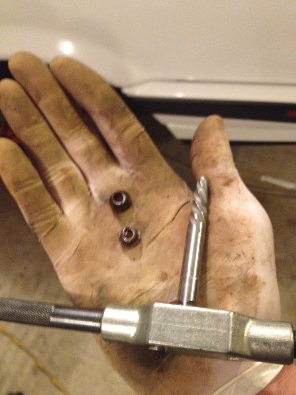

              Found the rotor hold-down bolts were stripped out, so I had to drill them out:

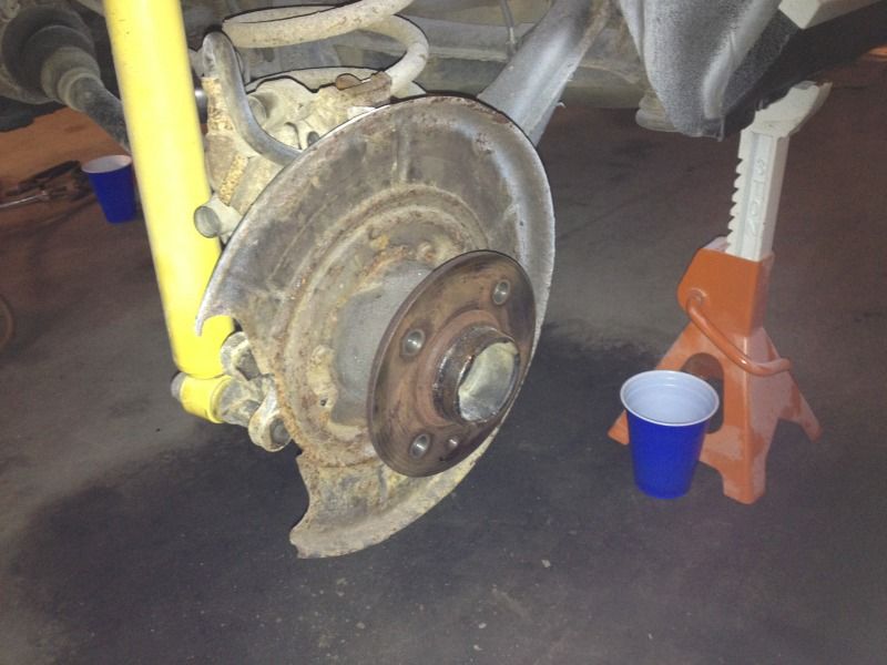

                        Took the front and rear brakes off to find the front wheel bearings were pretty much shot, and I'm assuming the rears will follow suit. The P.O. must have had an issue with the parking brake, because the components for the RH parking brake were straight up gone:

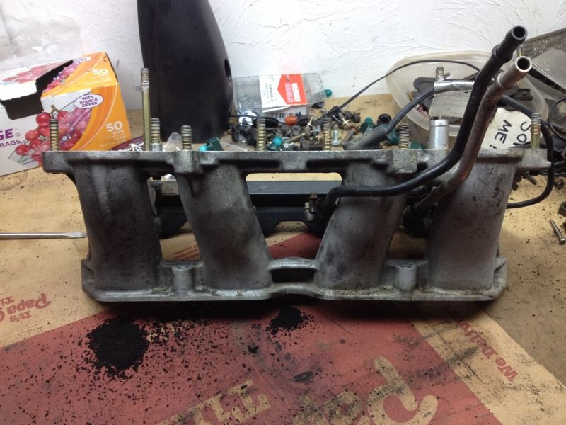

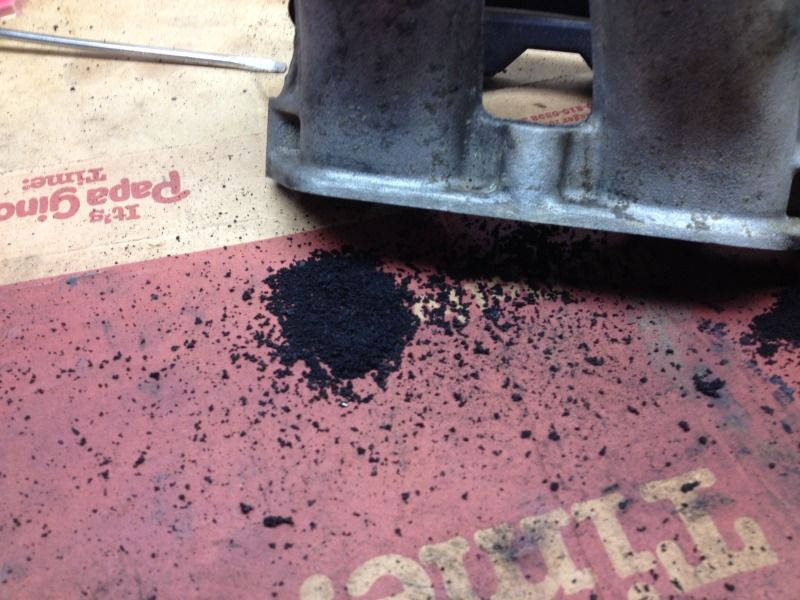

                        Ordered up rear parking brake components and front wheel bearings. Also started to tackle the infamous "Mess Under the Intake". Found most of the PCV/vacuum hoses were cracked and broken.
                        Cleaned the carbon deposits out of the intake, hopefully free up a little lost power:
                        Yikes!
