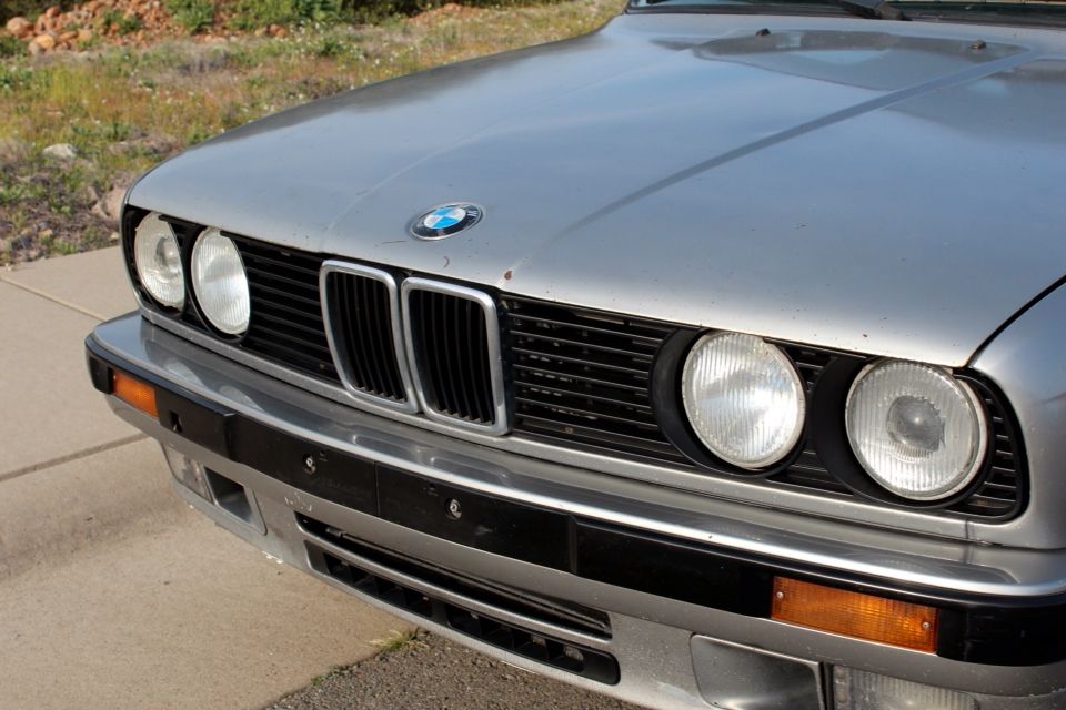

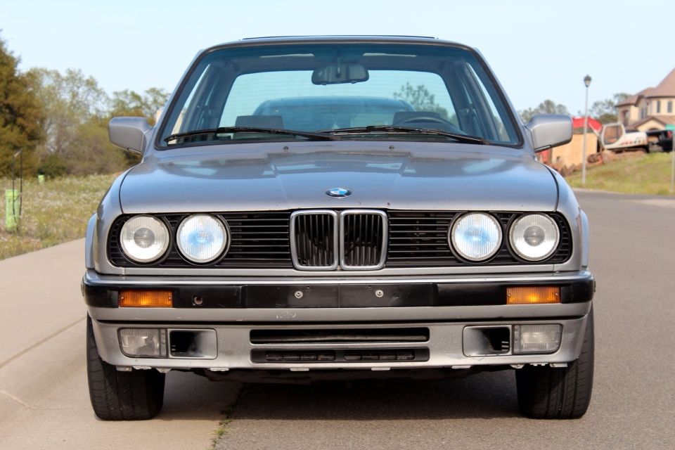

                    From Alpine to Lachssilber
                    Originally posted by e30pdee
                    Thinking about getting an IS lip, mudflaps, and yellowing my highbeams and fogs. any suggestions as to where i can get the best quality for the best price guys?
                    Yes to everything except Yellow Fog-Lights and Highs. I used to love it, then I had them for about 2 weeks and peeled the Laminex off.
                    It really was not worth it and I felt it cheapened the whole look and feel of the car.
                    HOWEVER, I do like the look of colored bulbs in the highs, where, looking head on, changes the look of the car:
                    But at most angles, looks completely stock:
                    I'm against all colors of fog lights that aren't clear, but colored bulbs/HIDs are a-okay, especially yellow as they are somewhat functional (yellow is the lowest output color that allows most visa biliary during the fog, when you know, you actually have to use foglights)
                    Never.. Ever... Nevereverneverforneverever NEVERNEVERNEVERNEVER buy eBay iS lip replicas. You will hit a bump ONCE, and it will shatter, and it will fall off, and you will be shelling out another $80 for ANOTHER one, when a perfectly genuine OEM one is $140 shipped from BluntTech. The OEM ones are tested to even survive stuff like this:
                    Notice how my car is destroyed, yet my lip is almost flawless? YEAH.
                    (Seriously, I reserve the right I punch anyone 7 times in the testicles if they buy an eBay lip)
                    Mudflaps, while not my thing, are awesome. Go for it. I think BMW has them new for around $200, if not you can try browsing the FS ads on r3v or posting your own WTB ad in the appropriate sub forums.
                    But seriously: You buy an eBay iS lip and those puppies are gonna get it.
