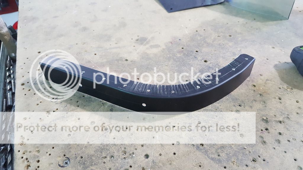

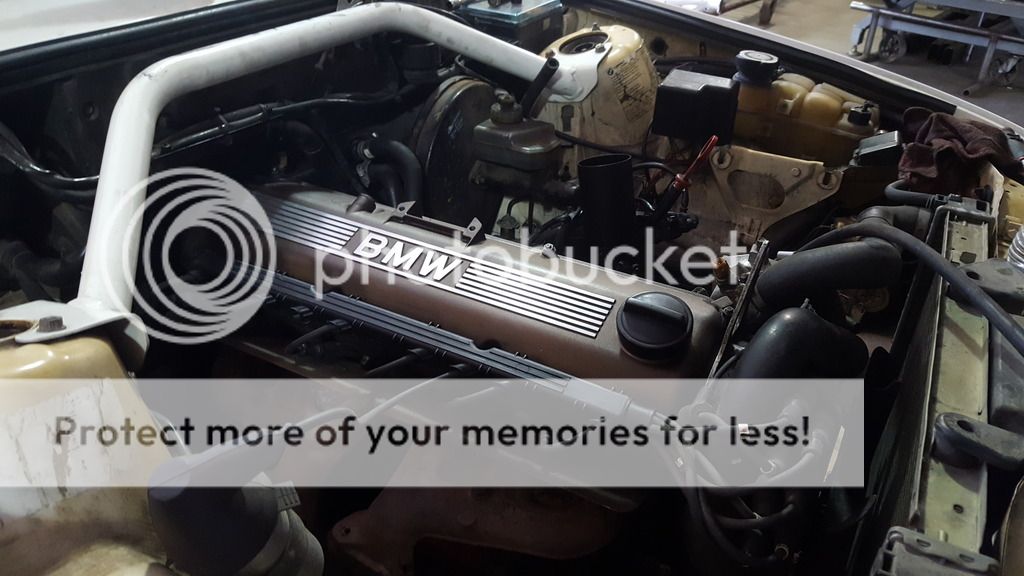

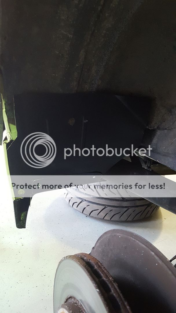

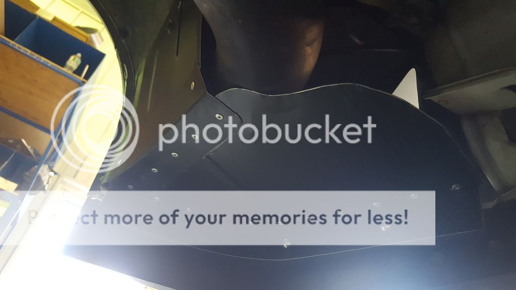

    I needed to make a new shroud for my psik, I threw one together quickly when I installed the intake but with these tires it rubs terribly.
    This piece bolts into the two fog lights bulbs. I took oUT the plastic nutserts and traded for some 1/4 20 3/4 inch button heads.
    Much better.

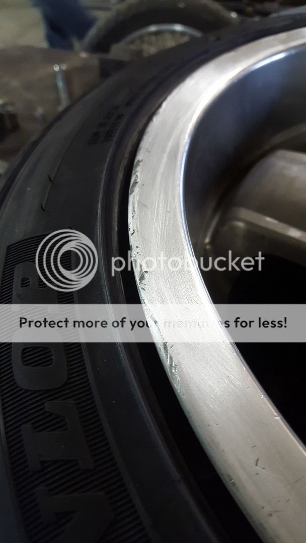

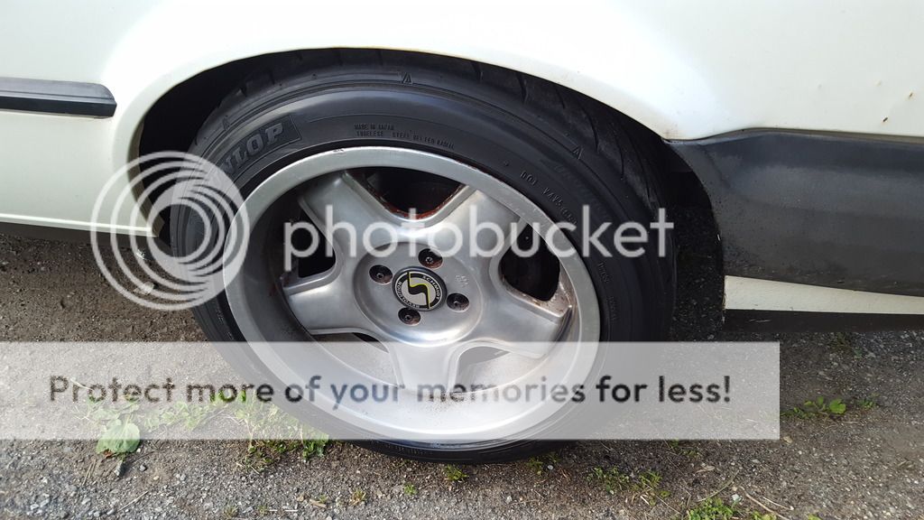

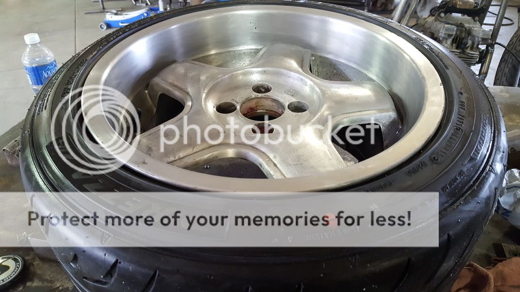

                        Yesterday I took a few hours to start wet sanding one of my wheels. I started with the worst one as far as rash goes. The fronts are more on the pitted side. This is my r.r.
                        I filed down the high spots and started with a dry 220 grit.
                        Then I went to 400
                        Then a wet 600 and finally wet 800
                        There was evidence of some brick red paint and also white paint or primer ?? In the hard to reach areas so I took care of that. I still have to do 1000 and 1500 grit and then a Polish but for now you can clearly see the improvement
                        And while I was at it I finished the stud conversion
                        And one nice weld for the road

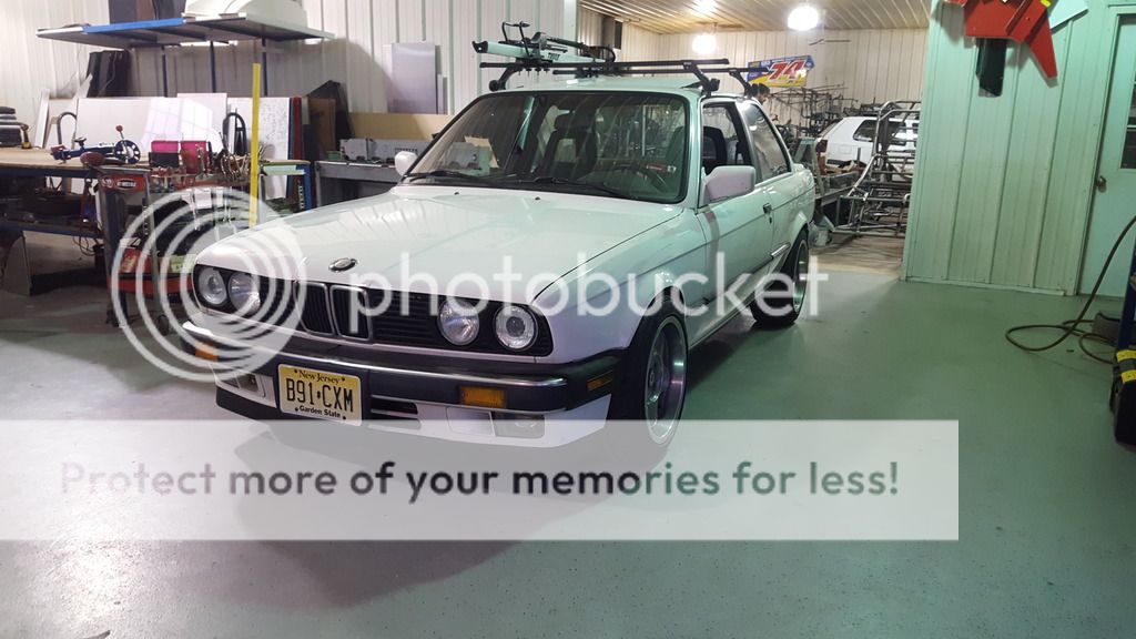

                          Ive been real busy the past few weekends . Last weekend a bunch of my friends and i went to brooklyn to see del if theres any hieroglyphics fans on here. It was an aweosme time.
                          But back to my latest obsession
                          Heres what i started with
                          Im done with 3 of the wheels now and im very happy with the results. This is where 2-3 hours per wheel will get you
                          The more i clean these whees up the more i love to stare at them. Now i just need to save up for some new bilstiens and ill be set.

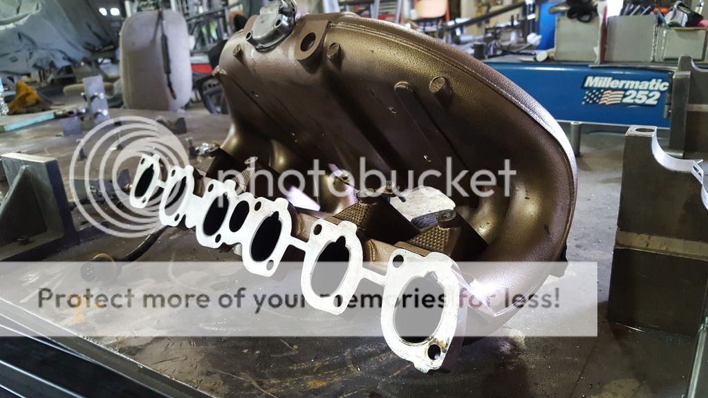

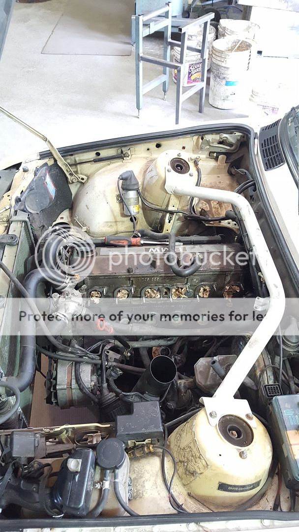

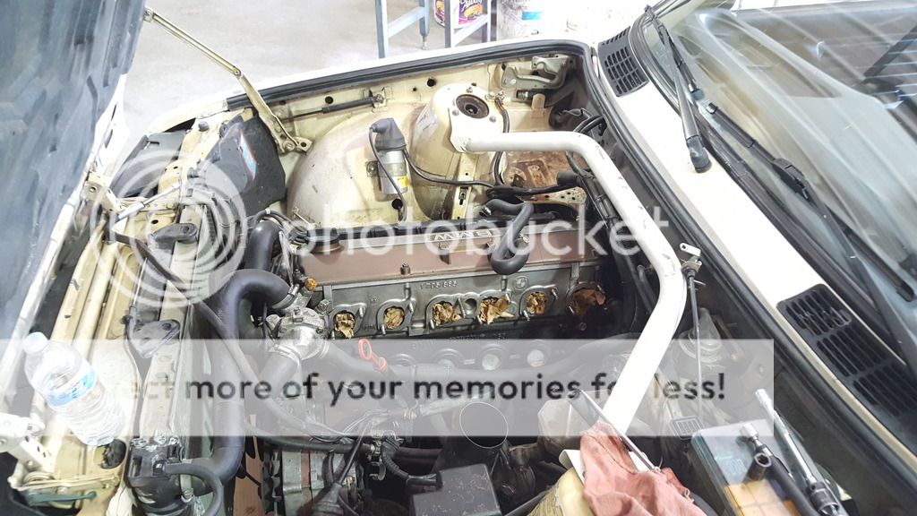

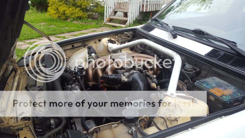

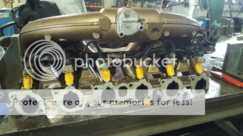

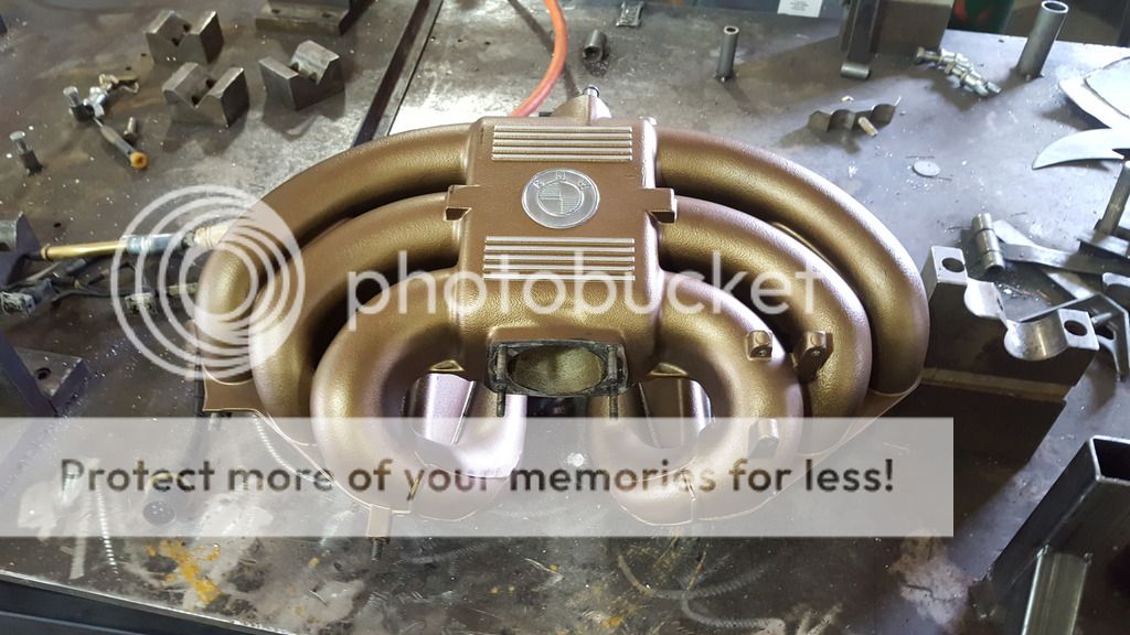

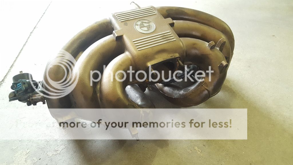

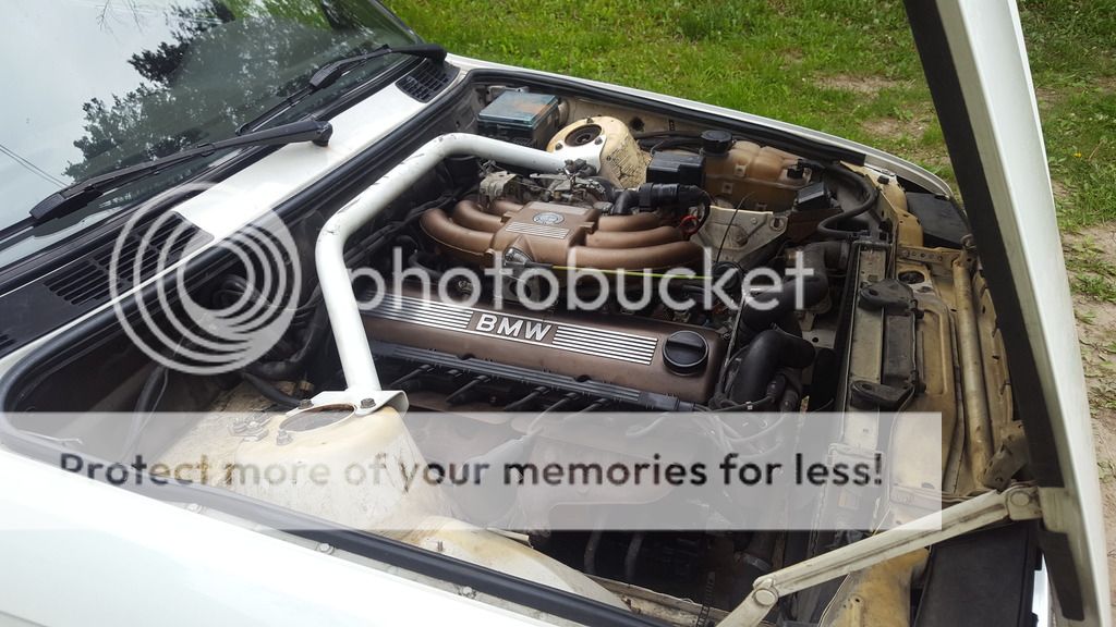

                            Finly got around to replacing my injectors with ford 19lb yellers. I had. Lot of cleaning to do and new inake mani gaskets lying around. The m20 was looking very sad
                            So i hit it with degreaser

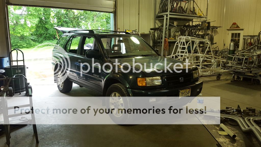

                            I love the way this color looks in the sun. Wiring will be tidied up of course. I found a horrid spot under my brake master that has been slowly leaking causing the paint to curl up off the car. Theres no way i can let that go on. Luckily i have a daily coming my way. This e3o is my only car anf has been for about 5 years now. It sure does show. Im picking up a 98 honda passport for $1 from my uncle who is moving to NC in june. Lots of things will be taken care of such as

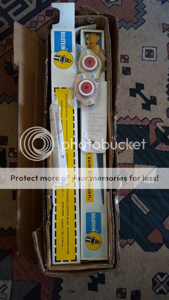

                            New bilsteins which i put a deposit on last night

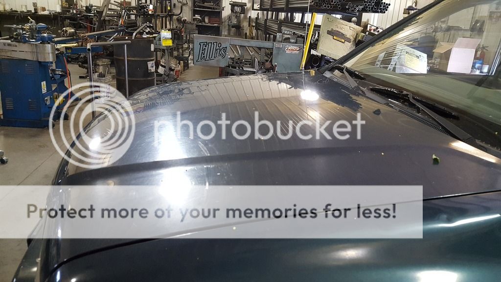

                              Daily is here
                              Hasnt been washed or vacuumed un 5 years but runs great. Desperately needs a wax though not complaining for $1

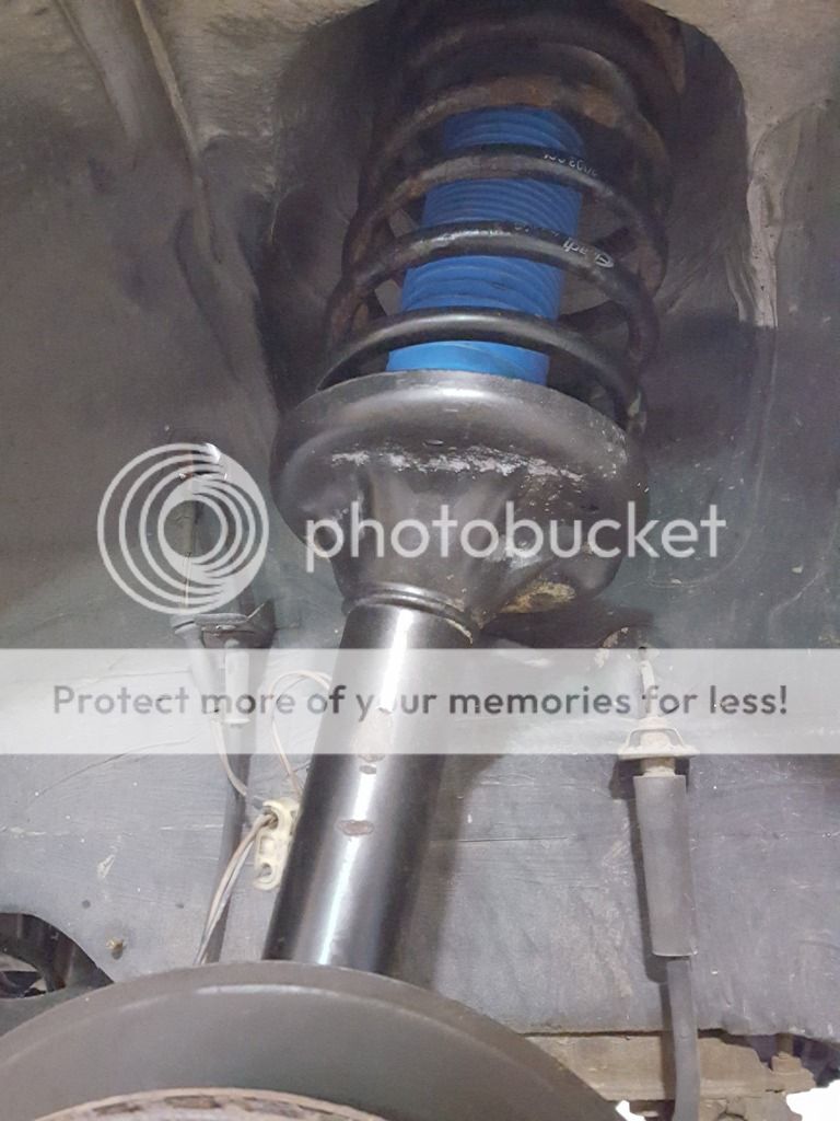

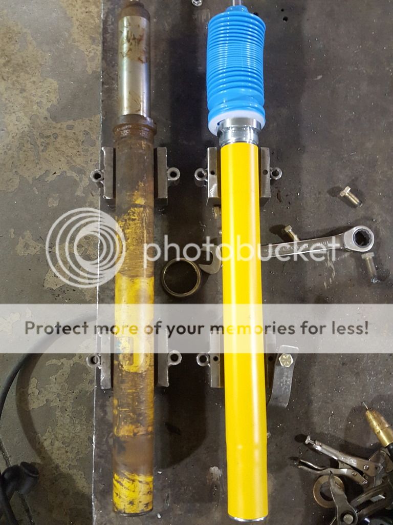

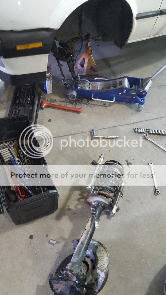

                                Picked these up from clemins for a good deal a few weeeks ago and its finally time. Ive had sports on it for a while but they were used when i purchased them 4 years ago.
                                More about how shot the old ones were later..

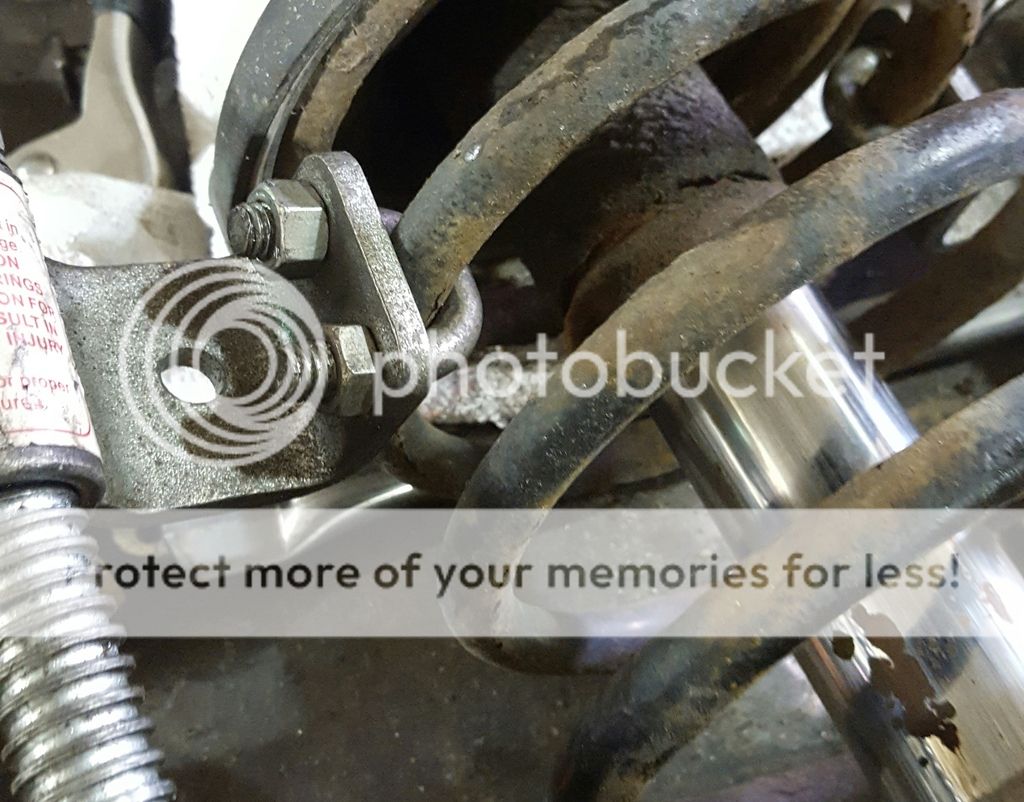

                                Nothing terrible or mentionable really happened during the instalation other than finding my front caliper sliders were frozen solid..
                                This inspired me to make soulja boy jokes for the next two days starting with this one :
                                Whats soulja boys favorite type of hardware ??
                                YOUUUUUUUUUUU! bolts
                                This was the worst of the bunch. Not doing much of anything at all
                                All done.

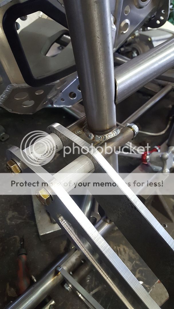

                                And a random weld
