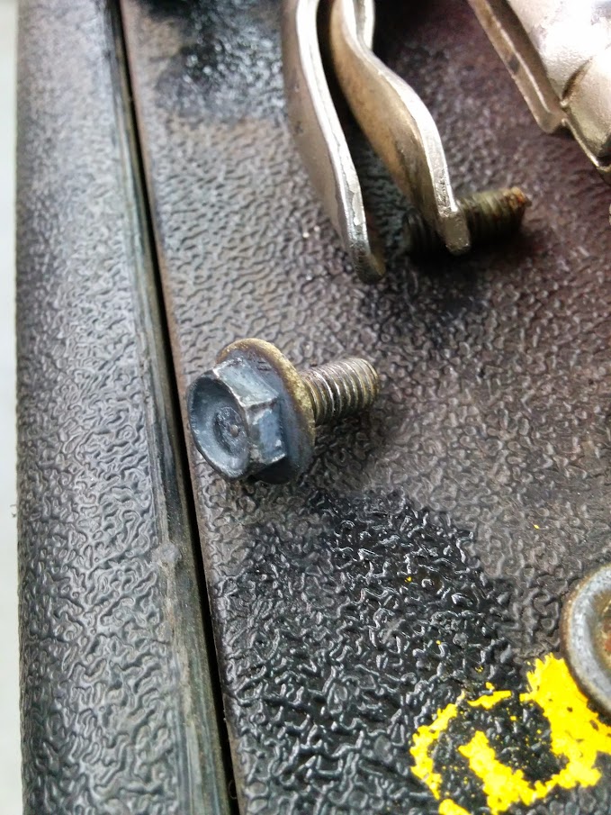

                            Well I got phase 1 completed over the weekend. What a learning experience.
                            Got everything out and gutted down to the oil filter housing gasket, then proceeded to put it all back together.
                            Do yourself a favor......never skimp on a torque wrench. I have a nice one but it didn't go low enough, so I went to Menards......of all places I should have known better and pick up one that went down to 10lbs. for $35. Oil filter housing bolts it worked fine because they needed about 33ft.lb......when I got to the water pump, well...........
                            Tried a few things but had to drag out the welder.....
                            Welded the nut on and......
                            Success!
                            That combined with some issues getting the fan off (living in the Midwest renting or buying Euro tools is next to impossible), it was a relatively simple project, just time consuming. Considering I saved myself several thousands of dollars in parts and labor I won't complain.

                              I remember when I had to replace the water pump on my e36 I ended up getting a strip of stainless steal and made my own spanner tool best thing i've ever made haha. The z is gonna look wicked with those 32's and little drop.

                                #75
                                yeah, I ended up putting the alternator and belts back on, using a wrench, BFH and my big biceps and I managed to get it off.
