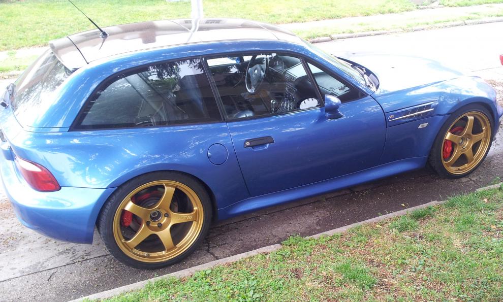

                                #45
                                On 19" SSR 3's
                                Here is a pic of mine, boost that bad boy.....
