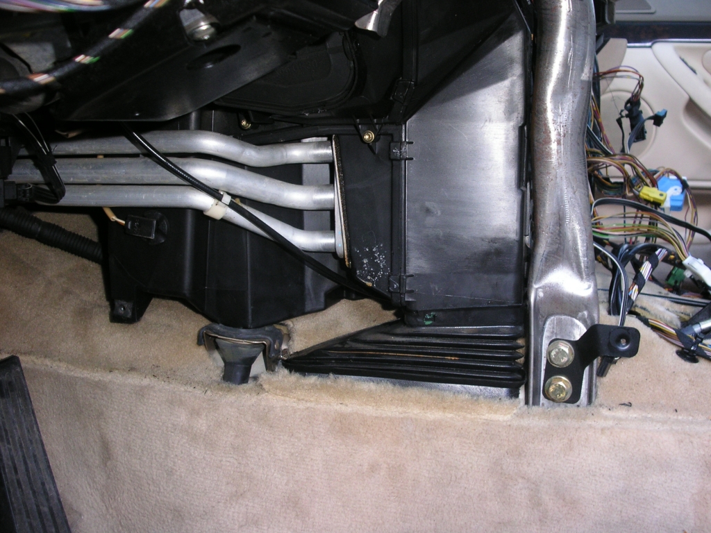

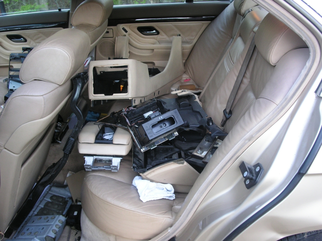

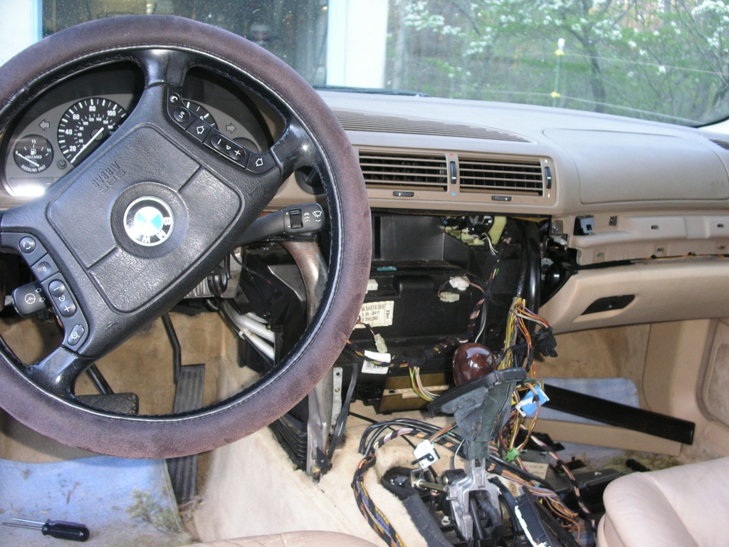

    Well my mom's 95 740i developed a heater core leak, so i get the fun job of tearing the car apart and fixing the leak. I got the car mostly torn down today, and found traces of antifreeze on the d-side under seat vents, and around the gasket where the pipes join the pipes running directly into the core. I believe it's just the o-rings leaking, but this job is major. So I'm going ahead and replacing the core and lines while the car is torn down. Tommorow I have to remove the steering column, drain the coolant system, blow the remaining coolant out of the core, and then R&R the core. The steering column is what is going to be a pain, There is a large metal brace in the way and you have to drop the column to get the brace out, which involves drilling out the shear bolts used to hold the column to the chassis :drink: Here are some pictures of the torn down interior
    All the crap that has been removed
    And the culprit area
    If you ever have to do a heater core on a E38 Don't, it's a lot of work. :-x

                              ya I know, any ways I got the shear bolt out, just drilled an 1/8 hole down the center, hammered in a bolt extractor and it came right out. Didn't have any white out to mark the column so I had to run to the store and get some. Will post some more pics once I get the comlumn dropped, and the heater box cover off.
