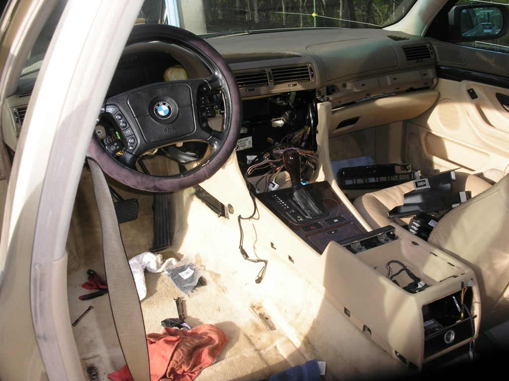

Got most everything out today, just have to lay down some plastic then tommorow pull the core and install the new one

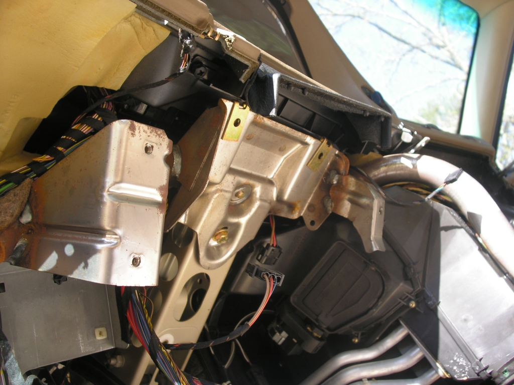

The stupid steal brace that requires the removal of the steering column to get too

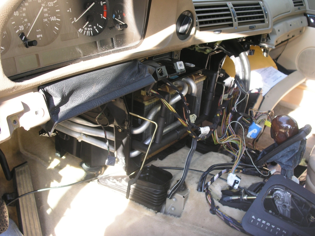

The heater core exposed
It looks like the o-rings for the pipes at the far left connection where leaking, there was antirfreeze traces in the vent on that corner that runs under the seat to the rear passenger floor board.
