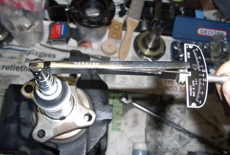

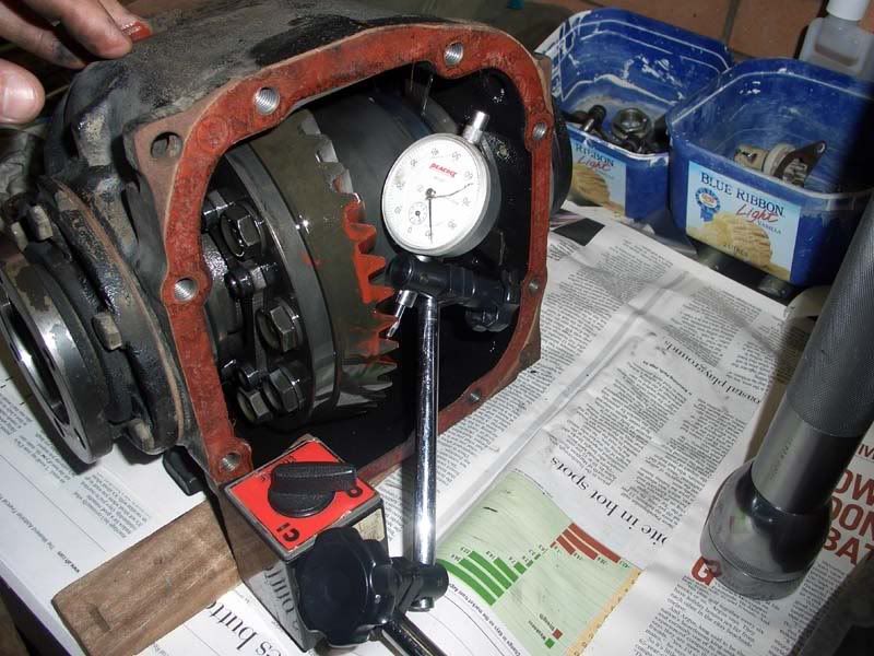

                            Shopping list for diff(188mm, lsd):
                            • 3-Clutch Performance Upgrade Kit
                            • Carrier Bearing Kit
                            • Crush collar clamp
                            • Carrier o-ring set
                            • Output seal
                            • Pinion bearing kit
                            • Pinion seal
                            I can't find these parts for less than $650, can anyone help? Also, is there anything I've forgotten, like "while you're in there" parts?
                            • crappycoco
                              • May 2014
                              • 250
                              Does anyone in the bay area have these tools I could borrow?
                              I really don't want to spend $500 on tools to rebuild one diff =)
                              Even better would be someone I could talk about how to tackle said project correctly =)
