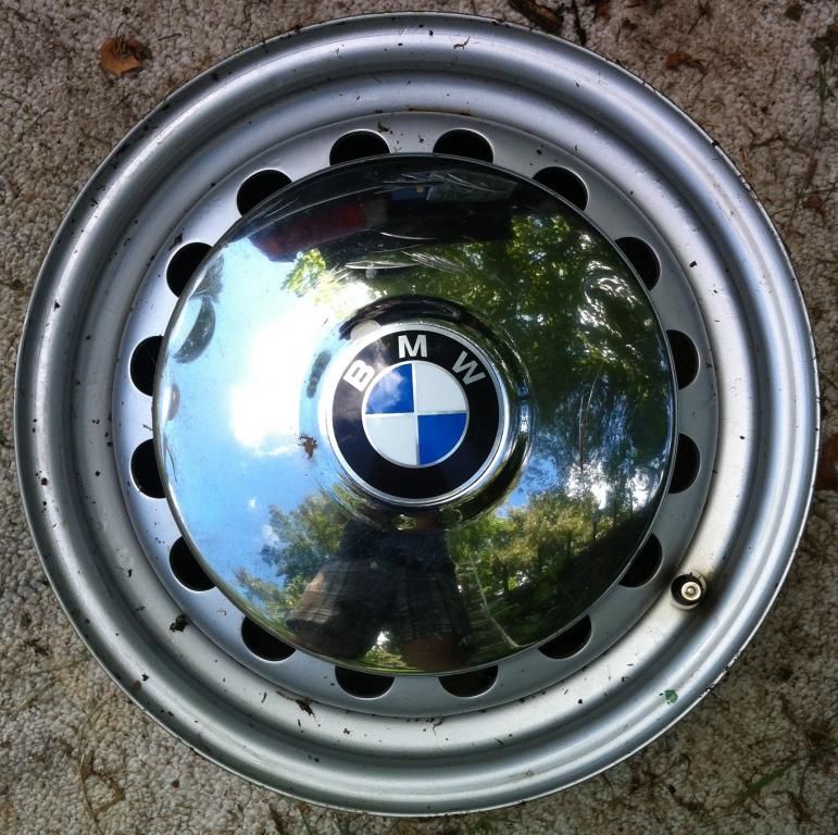

                        • Ether-D
                          • Sep 2011
                          • 2838
                          Maybe like this, spoiler alert…it's a vw hubcap.
