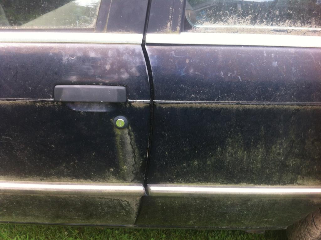

    1987 325iS m30b34 Muscle car (Engine electrical phase)
    I was born on 3/25…
  • Ether-D
    • Sep 2011
    • 2838

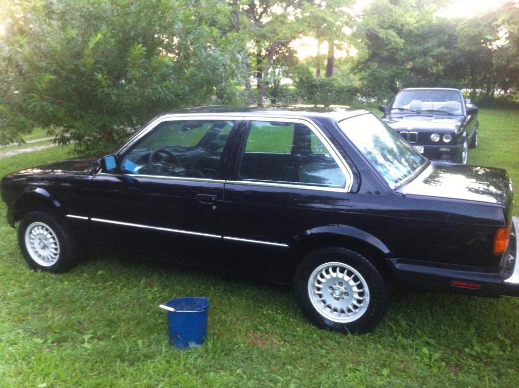

    A better shot. Small amount of soap and water and elbow grease later (still wet).

      I considered buying that same b34 before going 24v (I just pulled it from the e36 today). How long was that at his shop? It looks familiar.
      IMG_0145 by Jonathan Martin, on Flickr
      • Ether-D
        • Sep 2011
        • 2838
        The car he just got yesterday, but it was too straight and clean to part out. So he traded for my lightly-hit-across-the-rear but part-able vert that I wasn't gonna do anything with. It was a real stand-up thing for him to do. Now I have a project to mess with, and a clean original car gets to live. And he can part the vert and make a little dough maybe.
