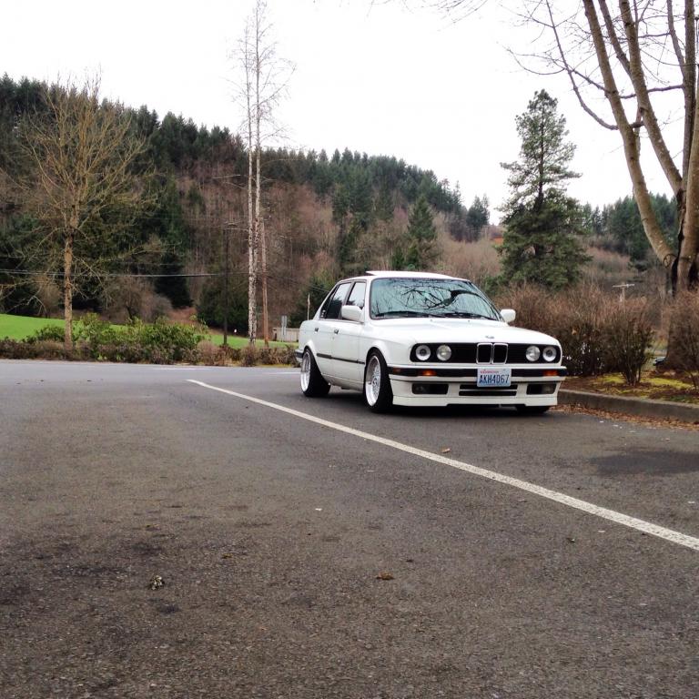

                          The car is officially back on the road! Turns out the new cam and cranks were faulty, either were shorted out, were wrong part number or something. Put the old ones back in and viola. Thanks to bmwm42 for having to the idea to think backwards after I had almost given up. Something so simple and it took me this long to figure it out..
                          Gave her the last emissions and as well as a through washing

                            Beautiful alpine! It's usually the small items you don't think about that are the issue. Good to see it back on the road.

                              What did you use to paint the "bmw" on the mud flaps white?

                                Thanks! Ya, in the back of my head I had an idea it was something small
                                It was rust-oleum protective enamel. It's oil based so it holds up really nice on the rubber. I applied it last summer and I haven't needed to reapply any
