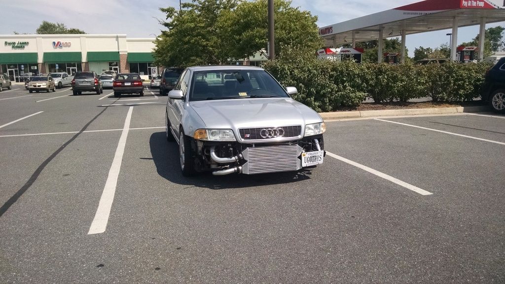

On a side note, MAF is reading 390g/sec, which puts it around 470-490CHP. Bumping timing a little more, also running about 22 psi. This FMIC is great though, temp raises about 2 degrees during a 3rd gear pull to redline.No E30 ClubOriginally posted by MrBurgundyAnyways, mustangs are gay and mini vans are faster than your car, you just have to deal with that.Comment

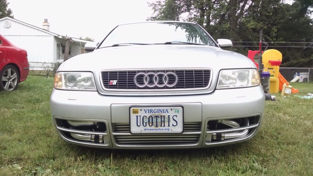

Played with the piping, re-routed the bottom passenger side OVER the a/c lines. I think JHM changed the design but didn't update their video. Much, much better now.
