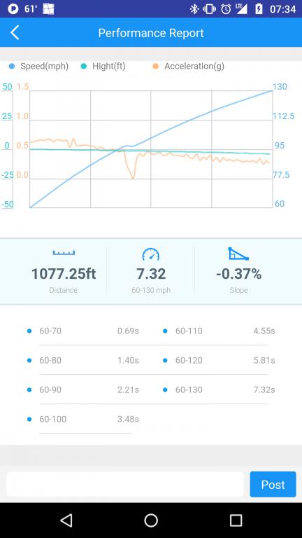

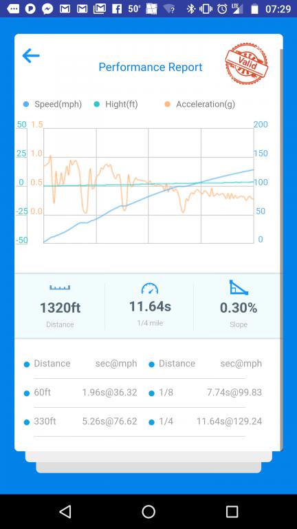

        Got a little data from the new Dragy gps unit.
        Can't complain about the results. ET will come down with a proper launch and no lazy shifts.

            Did they seriously misspell "height"?
            • Exodus_2pt0
              • 5943
              #351
              Pretty sure this started in the Asian market and it's just now making it over here so I'm not surprised. It's accurate though, saw a few posts where people ran it on the track. ET seems to match up within 1 tenth, and trap speed is up to 1mph higher, but that's due to being actual end speed vs final 60 foot average.
