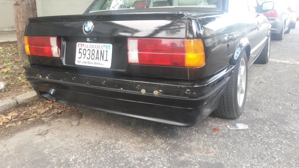

    Slow progress, painted my grills, cut my trim to fit the bumper, primed the rear bumper and valence.
    Fiberglassing bumper trim back together and deleting side markers/converting to euro trim.
    Riveted the valence to the bumper
    Bumper and valence back on the car

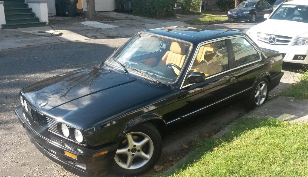

    Little before and after:
    Euro bumper trim attached:
    Back bumper trim attached:
    Errrbody loves new roundel day!
    Really does freshen up the look

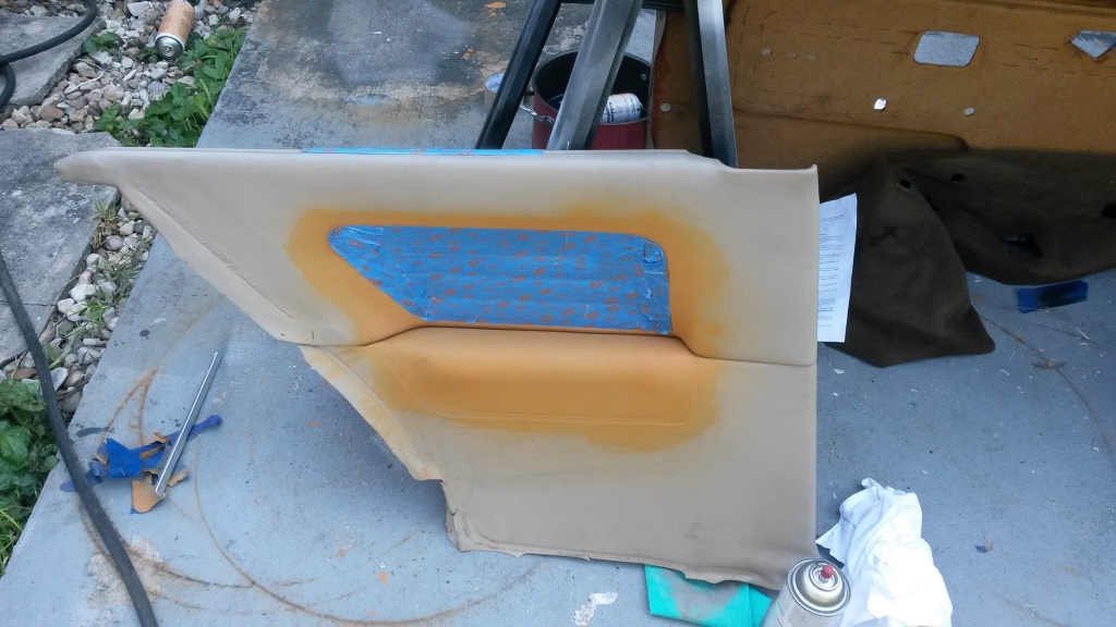

    Decided to go completely custom on the interior after seeing a friend's e36 m3 in modena, I fell in love with the black/modena contrast and wanted to see it bring this interior back from the dead. I traded the black sport seats for some tan ones locally and went to work.
    Carpet before dye:
    Interior before:
    Interior after (excuse the picture quality, my buddies phone is apparently always set to some high contrast Instagram mode)
    From the outside:
    Really pleased with how it came out

        Thanks! Yeah it's high quality stuff, only been on for a week but so far so good. I ordered it from leatherclinic.com and got the extra large kit. I have some protection cream that I'll be coating it with but you have to wait a week to put it on. I read a lot of reviews of different companies and multiple people reported good results years after the fact. The dye I did in stages, first with Rits, then wet vac'd the excess out, then Carpet Dye spray, then brushed it to retain the feel. Did the same thing in my vert and it's been 6 months, so far so good.

                        The dye on the seats are super soft. It lays down flat drys quickly and isn't tacky once dry, and its finished with 5-6 coats of clear matte finish which protects it from the elements and I'm fixing to put some included protection cream on it tomorrow. The carpet was rinsed once the dye was applied to remove the excess, then sprayed with Technicians Choice carpet dye spray, then brushed to bring back the texture of the carpet. The black on the door cards looks great and I have the same thing in my vert for the past 6 months. No complaints.
