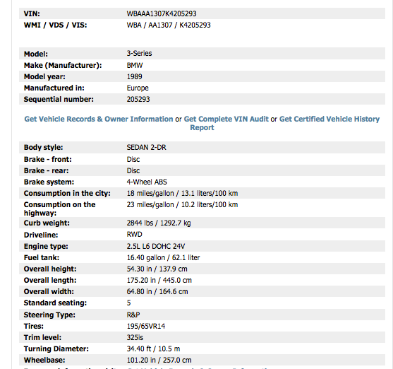

                                Looked up my vin for the first time to try and find the production month, and found out it's an iS?! Stoked on that! I guess the seats and wheel were stock, pretty sweet.
