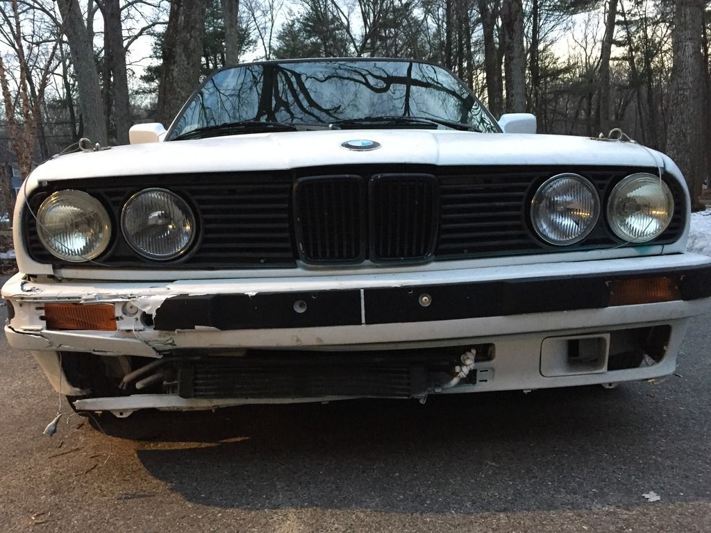

                    Aimed my headlights against this, low beams are trashhh with the 9006's,
                    ] so I found a solution I'm not sure if it's ever been done before!! I have US ellips, and the lows are horrid because they are the wrong lights, so I started doing some research. Tons of info about the h4/h1 swap came up, but I don't have sealed beams. I also have HID hi-beams so I didn't just want to have to sell those because they work great, and I didn't want to have to go source and wire in sealed beams, so I was trying to think of ways to do just the h4 swap. I measured the low beam across and like online it's 5 and 3/4 inches. Some of the diameter is the circumference of the glass, if that makes sense. So I figured, if I got a smaller set of HELLAs it maybe, just maybe would sit right inside the ellip bucket. So I smashed a low beam and said screw it, this could be a horrible decision, or it could really pay off, and be something others use. So yea, I took a mallet to the low beam, and slowly got the rest of the glass pieces out of the glue.
                    I got 5" hellas on ebay WITH BULBS for $40! Pic with the chrome ring on, fits like a glove.
                    after lots of glass grinding, scraping, and breaking, along with some grinding at the plastic housing, the h4 buckets sit almost perfectly where the glass used to be connected to the housing. I got some of that really good epoxy from HF and wow did they seal up good! Now I'm just waiting to receive the connector for the three prong h4 bulbs! So amped on how they came out. They still have all the aiming parts of the ellip, just a new bulb system. I thought the 5" would be too small, but they honestly fit perfectly. I measured them and they are a little bit bigger than 5" but they were listed on ebay as such, and the seller told me they were off an "older bmw" so maybe a 2002 or something?
                    Can't tell a difference from stock besides the way they pop out a bit
                    No different from the front!
                    beautyyyyy
                    classy
                    I will have more pics when the connectors come, and then she should be okay for inspection... We shall see!
