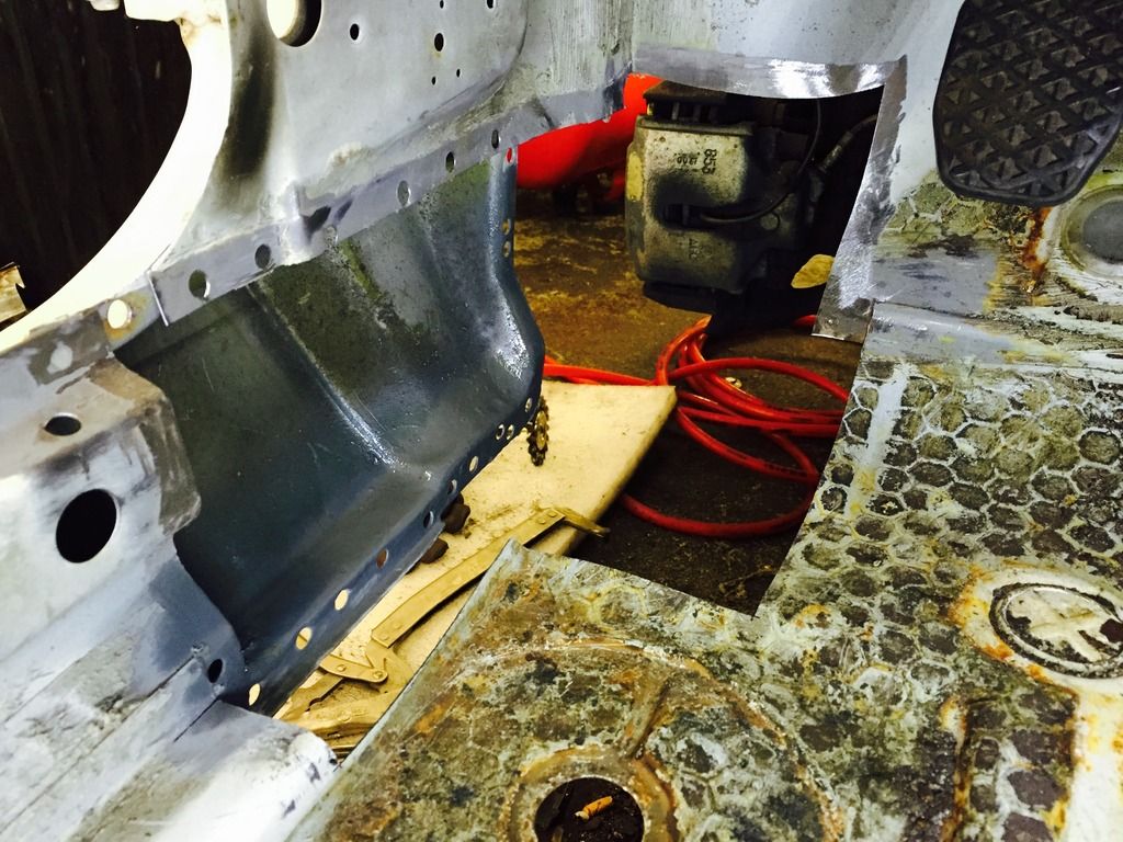

        I suppose I had better update this then! :o:
        It's a long story but I was meant to take this to the ring back in May and it was decided that repairing the front floor/lifting pads on both sides was a good idea along with the other prep for the trip so out came the carpet and while my main man Gary was repairing the drivers side....
        I got a bit inquisitve with the heat gun on the sound insulation stick on pads and found some more rust.
        That put going to the ring out of the question so it was either go in my 325i (which also needed some basic prep) or take the Munich legends track turd....
        At 10.30 the night before the trip the clutch master died on said turd which left me with no time to get a new part and fit it so I ended up going as a passenger with Simon in his E34 M5.
        Maybe it was a sign not to go....
        It's pretty much sat there doing nothing up until this week due to a house move, a holiday, work, an M5 engine build etc etc but Gary is back on the case and it should be solid by the weekend and back together soon after so I can start using it again!
        What has caused the rot i hear you ask? Well at some point someone has replaced the metal brake pipe that runs across the bulkhead in the engine bay and full marks to them for using a BMW steel line but where they have bent it to shape and routed it, it's knocked the "elephant trunk" partially off so rain water from the scuttle has been draining straight onto the engine bay sound insulation which has acted like a sponge and rotted the bulkhead from the outside in.
        Possibly the same craftsman also replaced the clutch master cylinder but did not refit the bulkhead grommet for it correctly and that let water into the drivers footwell.
        GRRRR!!!
        • BSS
          • Jun 2010
          • 52
          #34

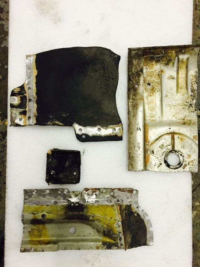

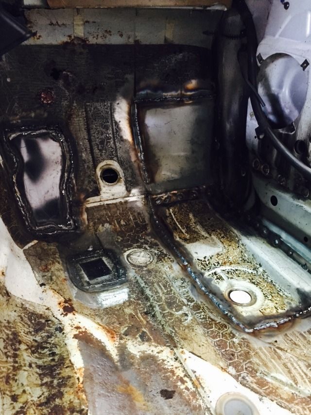

          Lots more metal has been cut out!
          Now, some of the other smaller holes on the bulk head and the big nasty one near the trans tunnel to be repaired permanently and finished to be as invisible as possible would require the engine and box to be removed and the heater box etc etc and as said earlier in the thread I'm not looking to get into a full blown resto at this stage so those areas have had temporary repairs to make it solid and water right for the time being.
          The front floor "jacking pads" and inner sills on the other hand are accessible without too much agro.
          Sections cut from a rust free donor car meant repairs would look as per factory and retain the jacking pad feature.
          Some of the in progress pics, note the temp repair on the left to the hole next to the trans tunnel.

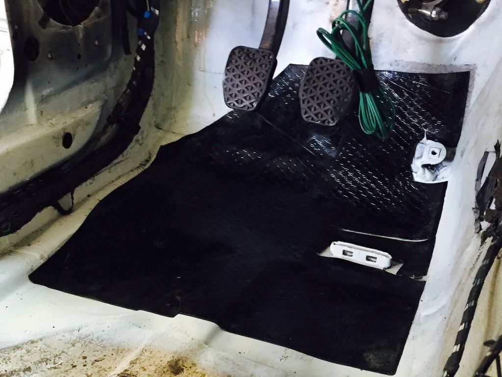

          Both sides done and in zinc primer.
          Some alpine white blown in and some sound insulation reinstalled.

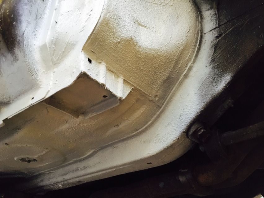

                      Some pics of the "Jacking points" after the repairs were covered in 3M bag sealer and some Alpine white paint blown in.
                      And what to recap, what they looked like before hand.

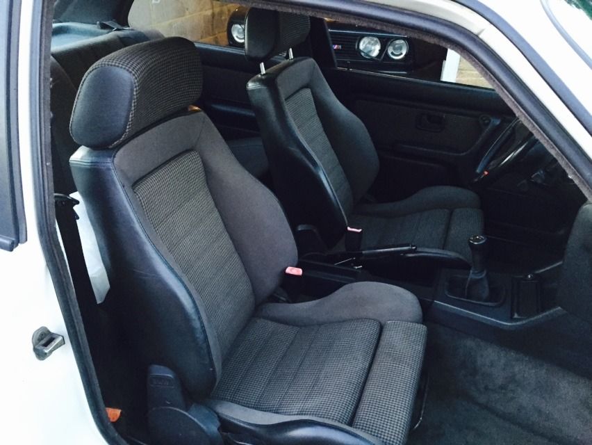

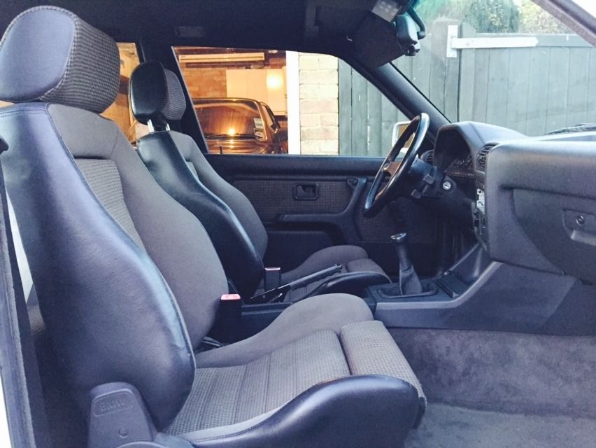

                          Another new addition is a pair of Recaro LS's in the correct matching "houndstooth" trim which are in pretty good condition. They are from a 4dr car but can be converted relatively easy for use in a 2dr with the tilt function and a pair of 2dr donor seats are in the pipe line.
                          Very happy with these as the interior was really letting the side down and now that the carpet has completely dried out and all of the dashboard parts and trim parts have been individual cleaned it not such a bad place to be.

                                Nice seats, love mine still like them just a tad bit more than recaro srd's since they are narrow compared with LS seats.
