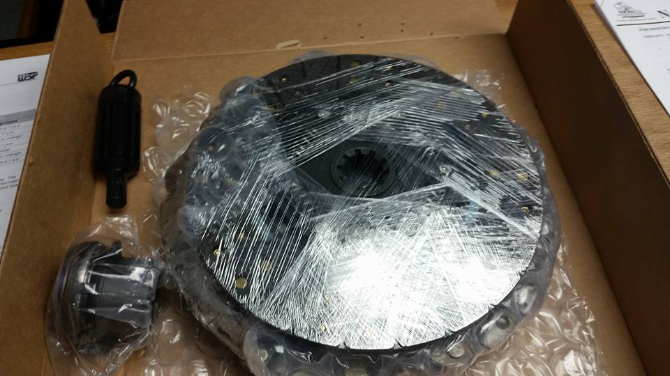

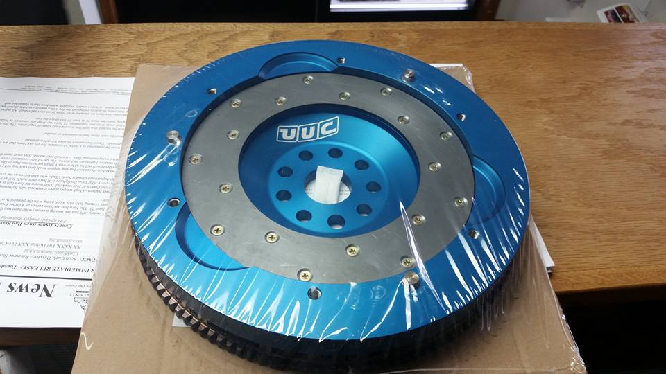

                  Yeah, Garagistic got a pretty good chunk of change from me. Bunch of stuff I needed for the swap, or for other projects. Picked up rear camber/toe kit, Billet throttle cable bushings for M60, Exhaust manifolds for the M60 swap, Engine mounts, sub frame spacers, tranny mount extension, drive shaft, Tach splitter, Fan, Drop hats, and a P/S block off block. Then I called and left a message at UUC, I'm pretty sure I sounded really drunk, but they still called me back. After my conversation with them I bought one of their "medium weight" flywheels and clutch kits. Shit's getting really real. I'll post pictures when the parts get here.
                  It will probably be this fall before I actually start assembling the whole thing. I still have some parts I want to find and build, and we need to get my buddies Aristo swapped IS300 running first.
