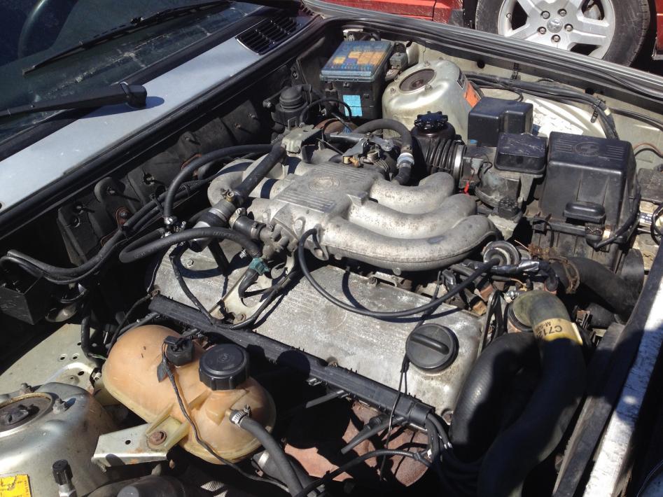

              Another pretty engine picture, and a before picture. Some difference, huh?

                I think going from e to I cleans the bay up nicely. Your bay definitely looks cleaner/tidier than the swap I just finished lol.
