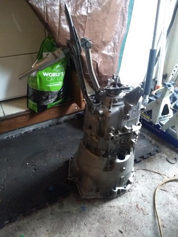

                          Nice progress. Stick with it... you're almost there. And don't feel bad about all the preplanning you did only to have to make constant spot orders for different/more parts... I went through the same process with mine nearly nickel and dimed me to death
                          on the shifter/grinding issues, your shifter should sit centered in neutral. IDK if the angle of the photo was weird (also not sure what gear the trans was in), but it does looks like a pretty severe angle the way it's sitting there, and I imagine the angle would increase when you push the carrier to line up with the trans as if it were installed. Which shift carrier did you use? E30 or E36?
                            Click image for larger version  Name:	Dj6qfPf.jpg Views:	0 Size:	62.9 KB ID:	9903340
                            To be fair I had the shift lever was installed incorrectly in that picture, but it has since been turned 180* and is still wrong. It's never been centered, which I didnt think was right, but now after driving it's pretty obviously wrong. I used e36 m3 DSSR and shift arm, z3 shift lever, and e30 shift carrier. As you suggested, my understanding is that this should sit centered and somewhat off to the right.
                            edit: Picture from directly above with trans in neutral
                            edit x2: After doing a bit of research I think I may have an e30 shift selector joint, which in pictures appears to be longer than the e36 version. Time to order more parts!

                              So I purchased a new selector rod joint which I was able to install this morning to see if it would fix the issue of the shifter sitting too far forward. Turns out yes, there is a significant difference
                              Sits perfectly centered now, which makes me very happy! Also realized a few weeks ago that spring mount of the shortened struts sits almost exactly parallel with the lip of the front wheels. Ended up throwing the 8mm spacers which were sitting on the rear, on the front. And put 15mm spacers on the rear. Honestly it looks pretty great, but I need to figure out some areas that are rubbing a bit. Now at 16x8 +10 rear and 16x8 +17 front.
