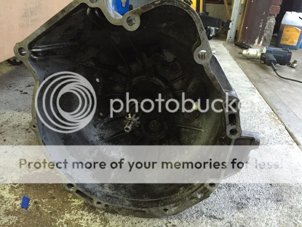

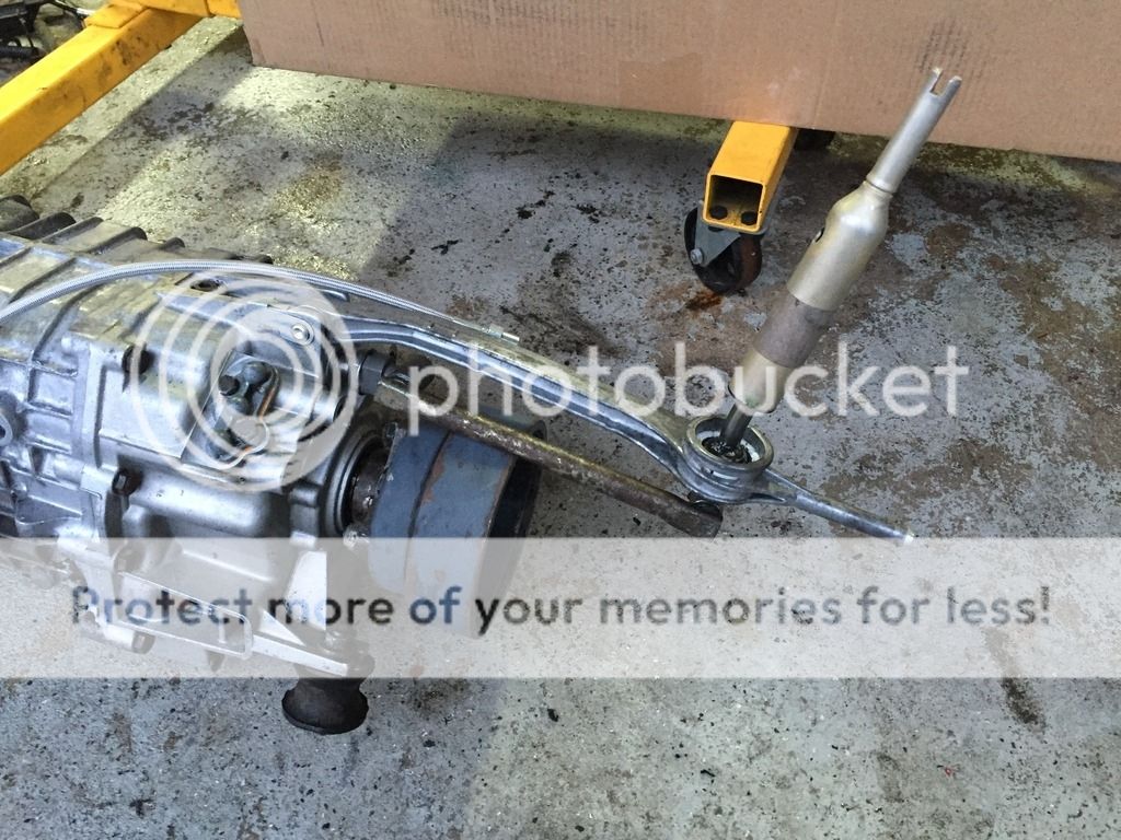

          I accomplished a little bit today, but not as much as I had hoped due to poor weather. I started with addressing the leaky transmission seals. The spring cover on the top of the trans was a source of fluid leakage on the gearbox, so I popped the cover off and applied some fresh Loctite 574 flange sealer to the mating surfaces. I also replaced the shifter selector rod seal and rear output flange seal while I was at it. The rear seal was a bit of a pain in the ass due to a very tight rear nut, but some help from the blowtorch and a gear puller got both the nut and the flange off. Once back together, I replaced the guibo, and reinstalled it along with the shifter assembly.
          I wanted to tackle the input shaft seal, but unfortunately the inside of the bellhousing is still quite filthy, and the weather was too rainy for me find the motivation to clean it. I will tackle that another day.

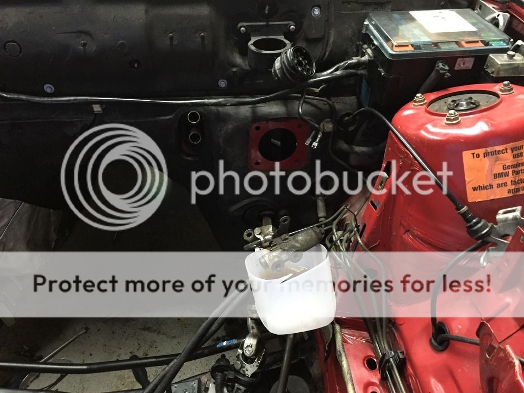

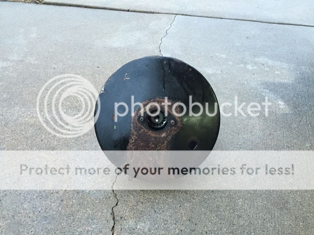

          The brake booster was also removed today, in order to paint it. Again, due to the rain, that didn't happen. Oh well.

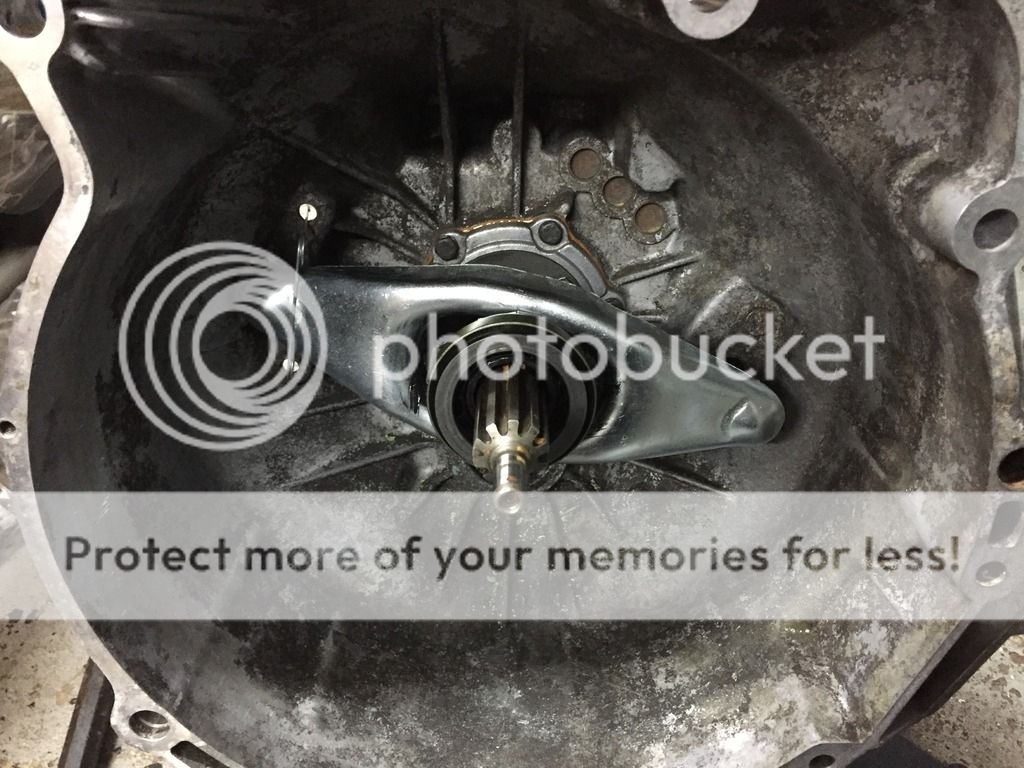

            The weather perked up a bit yesterday so I could clean up the gearbox a bit more. I hit the grime with some Castrol Superclean degreaser and a brush, and hosed it off with a pressure washer. Once dry, I removed the input shaft seal cover and swapped the seal. I used Loctite 574 flange sealer to seal the cover to the transmission case to prevent any leaks. The gearbox got a new OEM pivot ball and retention spring, new clutch fork, new slave cylinder, and a fresh throw-out bearing. All pivoting and moving assemblies were greased, as well.
            I wish I could get the aluminum in the gearbox looking a bit nicer, but I think that that would be impossible without media blasting.
            Edit: Upon closer inspection of the image I just posted, my throwout bearing is installed 90º off. I will correct that ASAP!

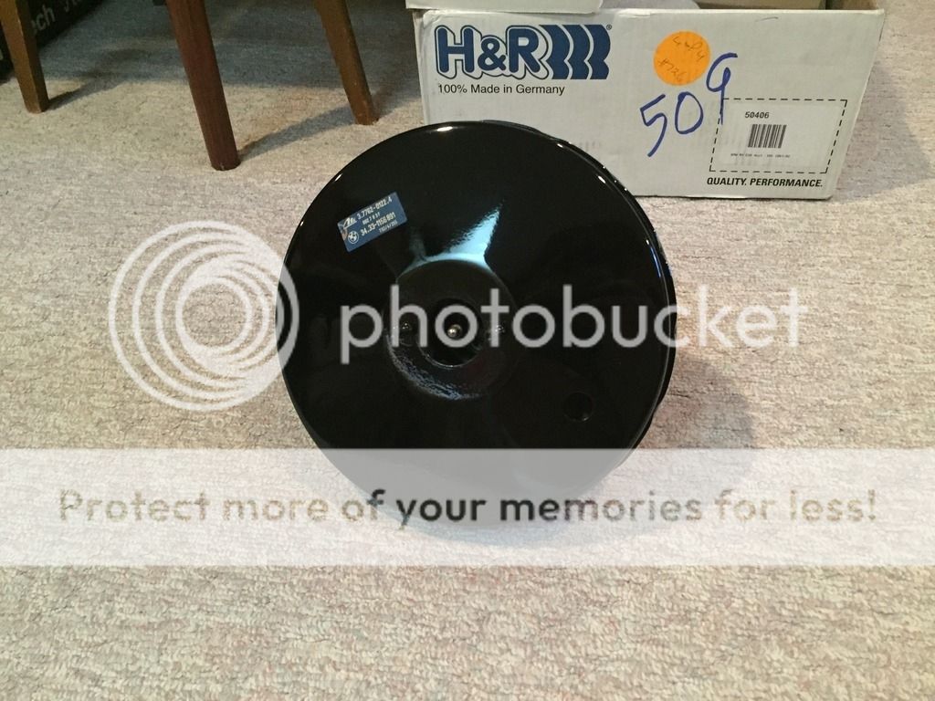

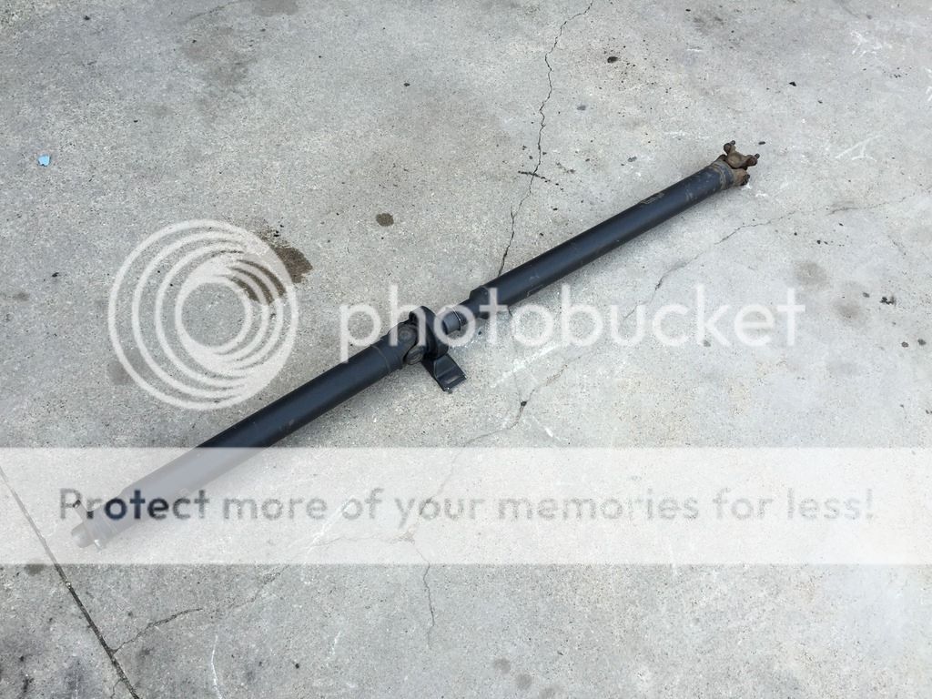

              Finally got around to repainting the brake booster, and also serviced the driveshaft while I was at it. The driveshaft got a new front bushing, centre support bearing, and spline collar. My machinist still hasn't had a chance to look at the block, so I'm still holding onto hope that it's saveable!

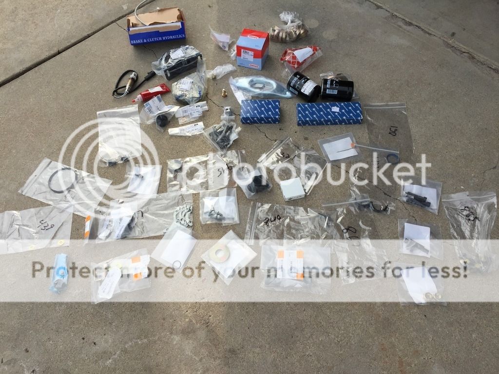

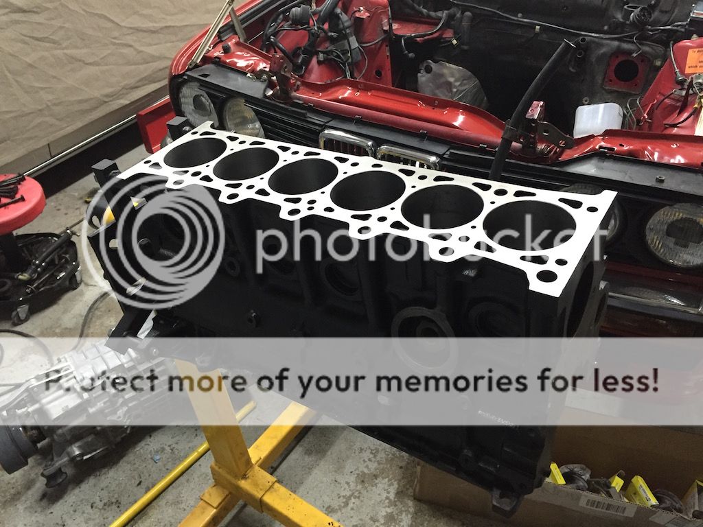

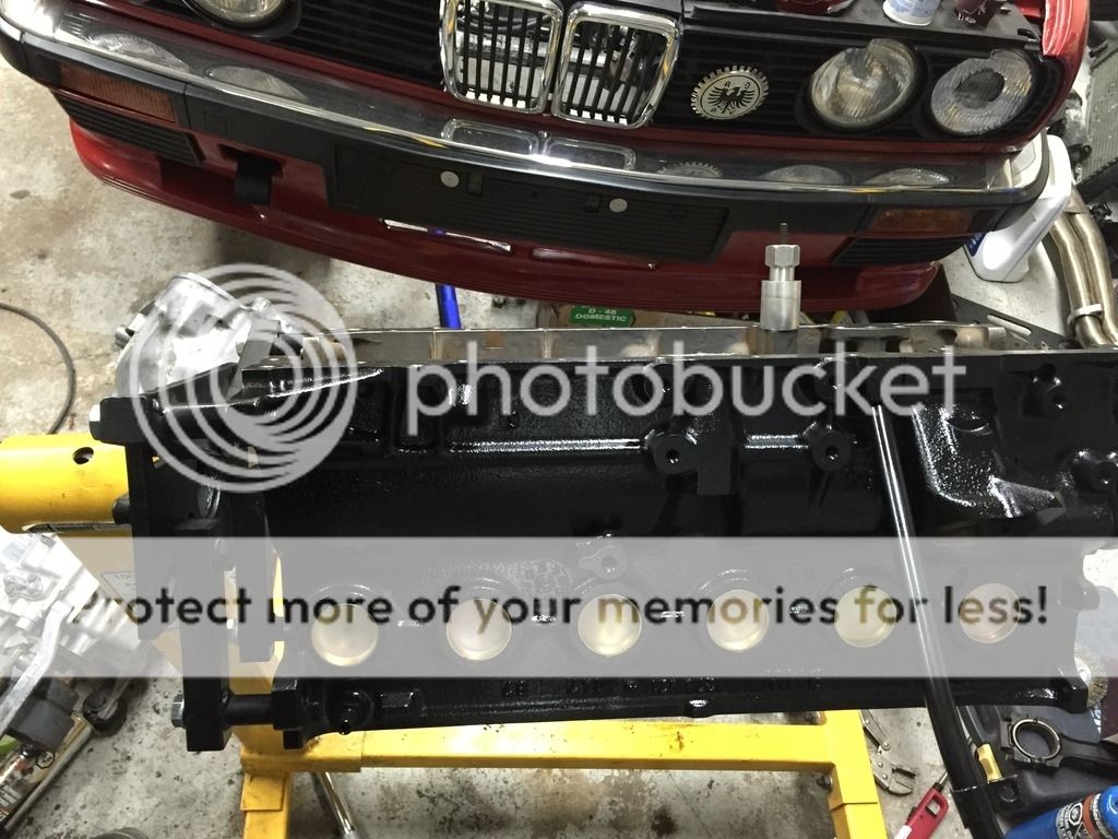

                The machinist did a great job honing the cylinder walls, chamfering the cylinder edges, and decking the gasket surface. There's still a bit of discolouration from the remnants of rust on the honed surfaces and a couple vertical scratches that didn't come out 100%, but those won't give me any problems. This isn't going to be a high-horsepower engine, so I've got nothing to worry about!
                I've got pretty much everything I need to put the bottom end together except time! Schoolwork is piling up for me at the moment, so I won't be able to really get my hands dirty for another week or two. I can't wait to get this project going!

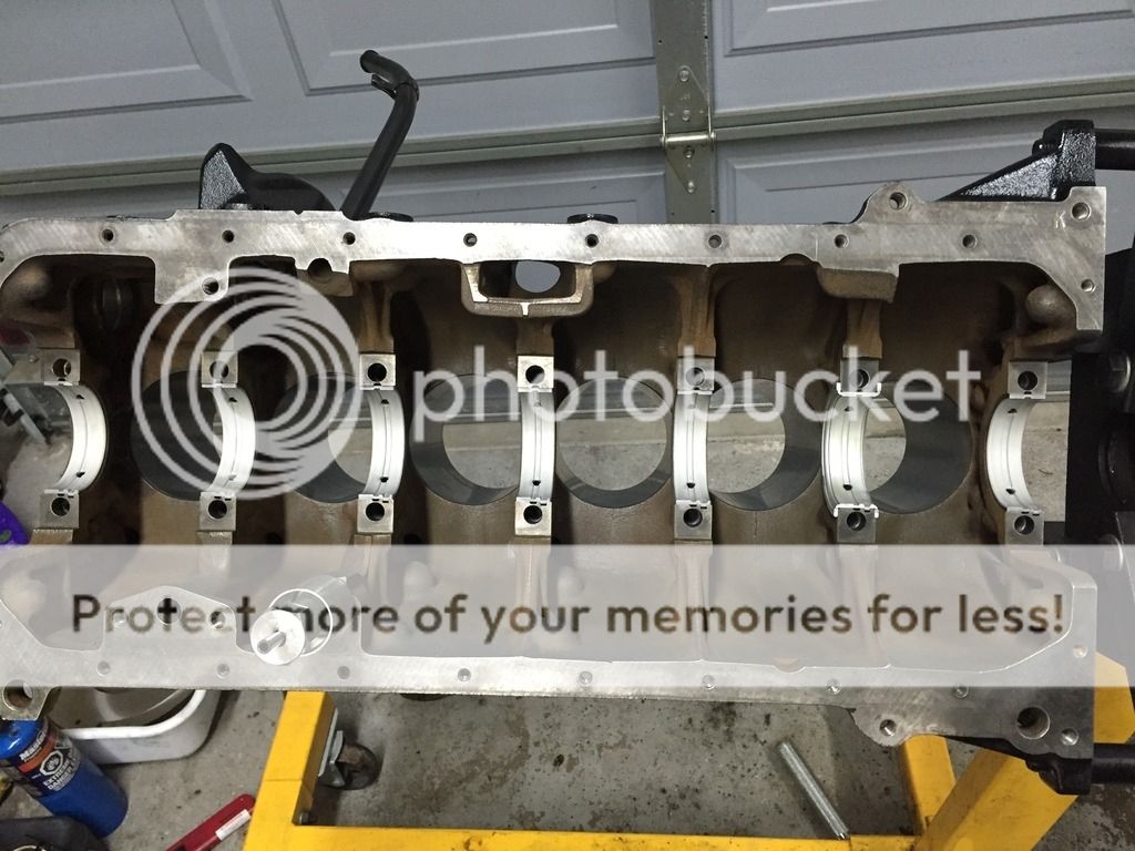

                  Finally got thru my schoolwork to spend a bit of time giving the block some love. I knocked out all the freeze plugs and replaced them with nice new ones to pretty up the block a bit before getting into the real reassembly:
                  Other than that, I popped in some of the main bearing halves to give me some motivation to put the crank and pistons in tomorrow!

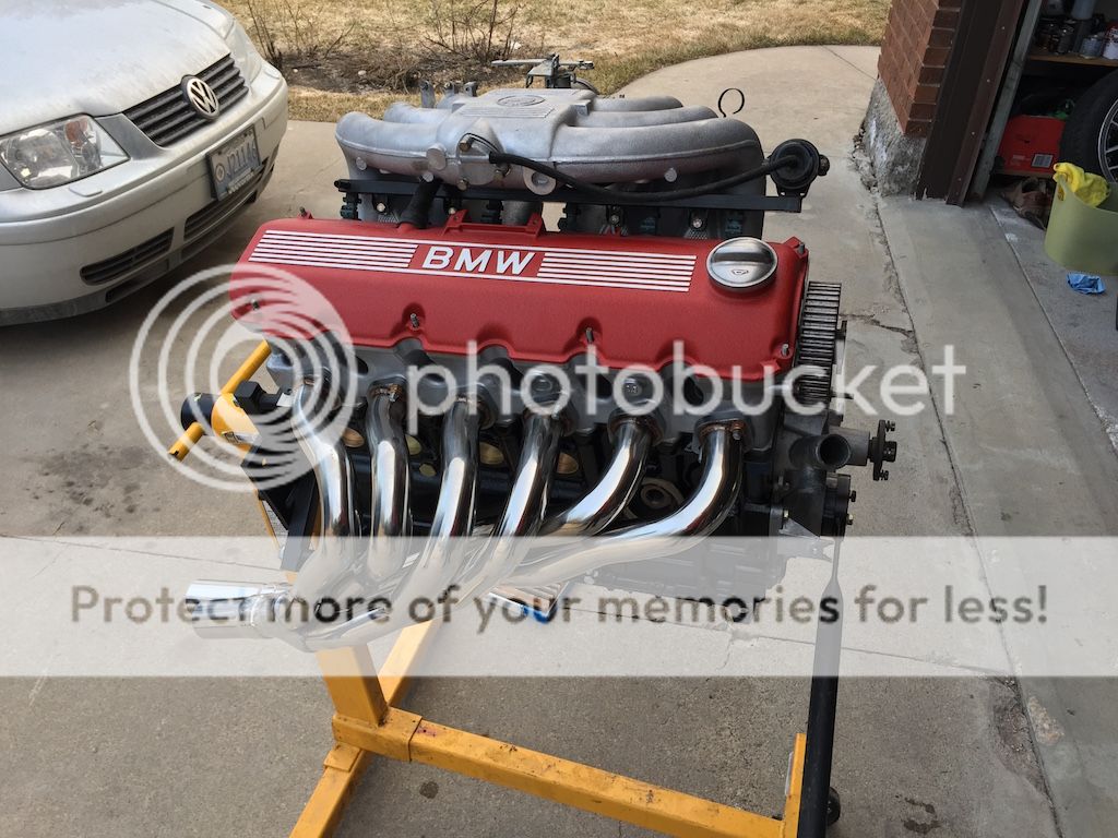

                    #54

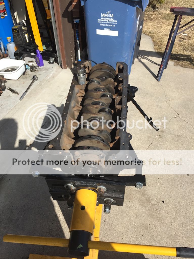

                    So I got a bunch done.

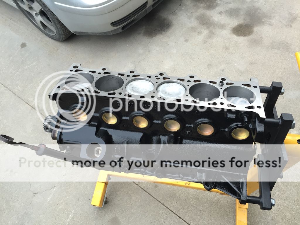

                    In went the crank, along with the rest of the freeze plugs:
                    Followed by the pistons, rods, and new bearings:
                    Then the, uh... rest of the things:
                    Looks pretty good to me. All that's left is to actually torque the head bolts (ran out of time today), install the windage tray, oil pump, oil pan, rear main seal, flywheel/clutch/pressure plate, timing belt, timing covers, accessory drive pulleys, alternator, oil filter housing... the list goes on. A solid couple hours of work, and this should be ready to install! Let's hope it doesn't blow up at first start!

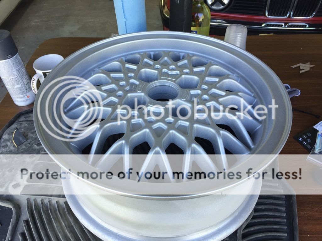

                      I've participated in 4 AutoX events so far with the car and it has performed pretty well. After the first event, it became apparent to me that I needed some better tires (500 treadwear all-seasons gave me literally no grip), so I refinished a set of BBS RA wheels I had laying around and fitted Dunlop ZII tires.
                      The wheels sit inwards a little bit more than I'd like, so I ordered 42DD 10mm spacers for the rear, and 5mm spacers for the fronts. I also really need to take the tape off my high beams.
